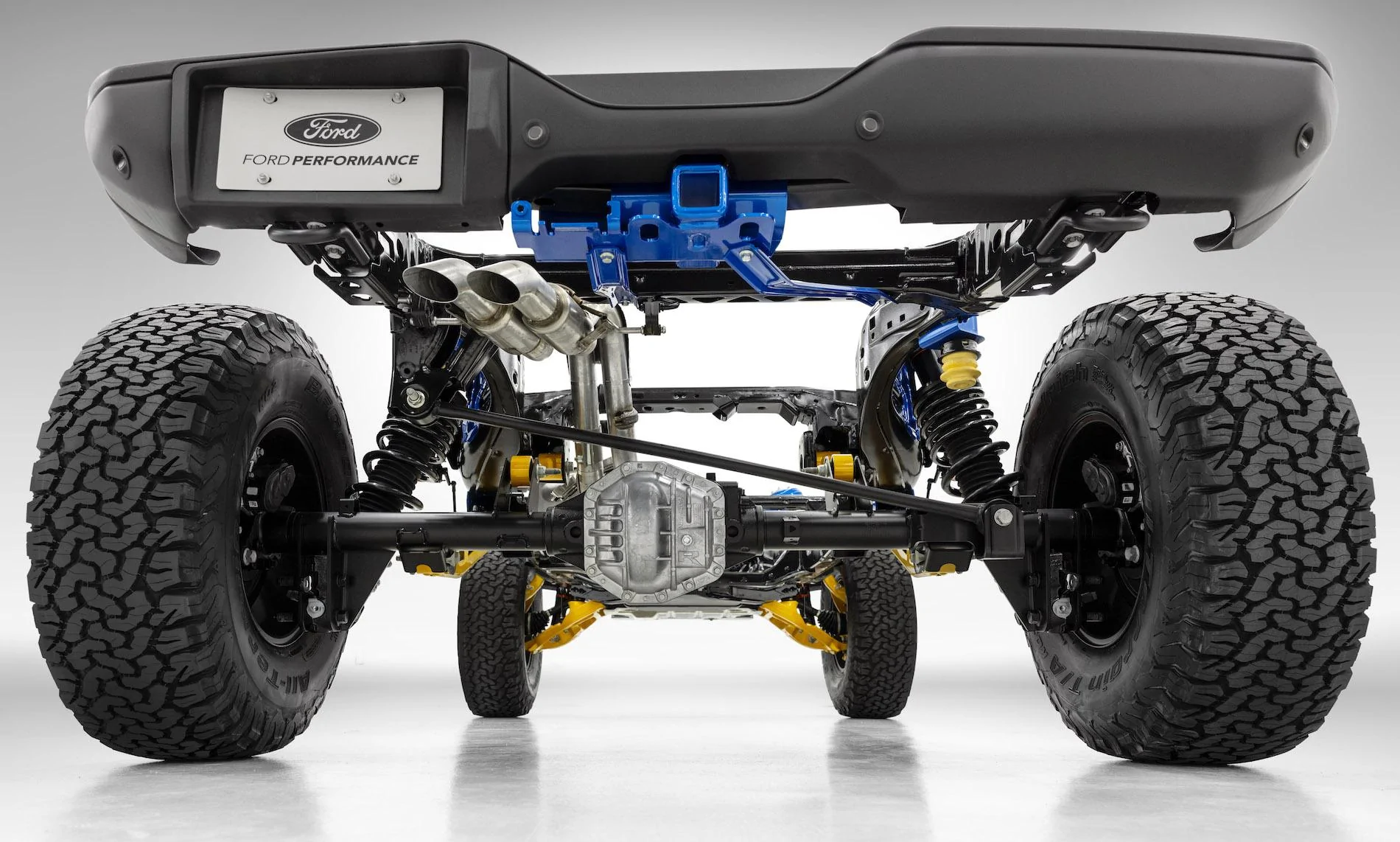

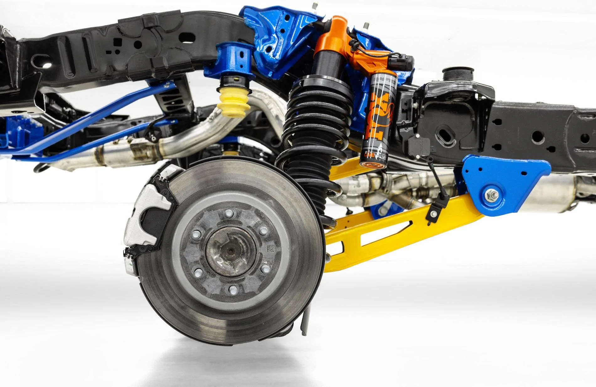

I would like to see someone create a set of braces for the hitch like Ford put on the Raptor. That would make me more comfortable with that much dead weight being carried on the hitchā€¦

Iā€™ll see if I can track it down, but in the Raptor section of this forum, someone posted factory computer diagrams of the Raptor undercarriage. You can see some diagonal braces that go from the trailer hitch to somewhere in the area of the rear axle. The tow rating for the Raptor is 1000 lbs. higher than the regular Bronco, and I think this is part of the reasonā€¦

The braces are seen in blue. They were able to add these because the Raptor muffler is in a different spot than the standard Bronco. Thereā€™s some debate (because itā€™s B6G, so of course) about whether itā€™s the braces that boost the tow rating of the Raptor. My feeling is, if itā€™s not the braces, what the hell are they there for? The Ranger has a tow rating of 7500 lbs. with the same engines and frames the Bronco hasā€¦
