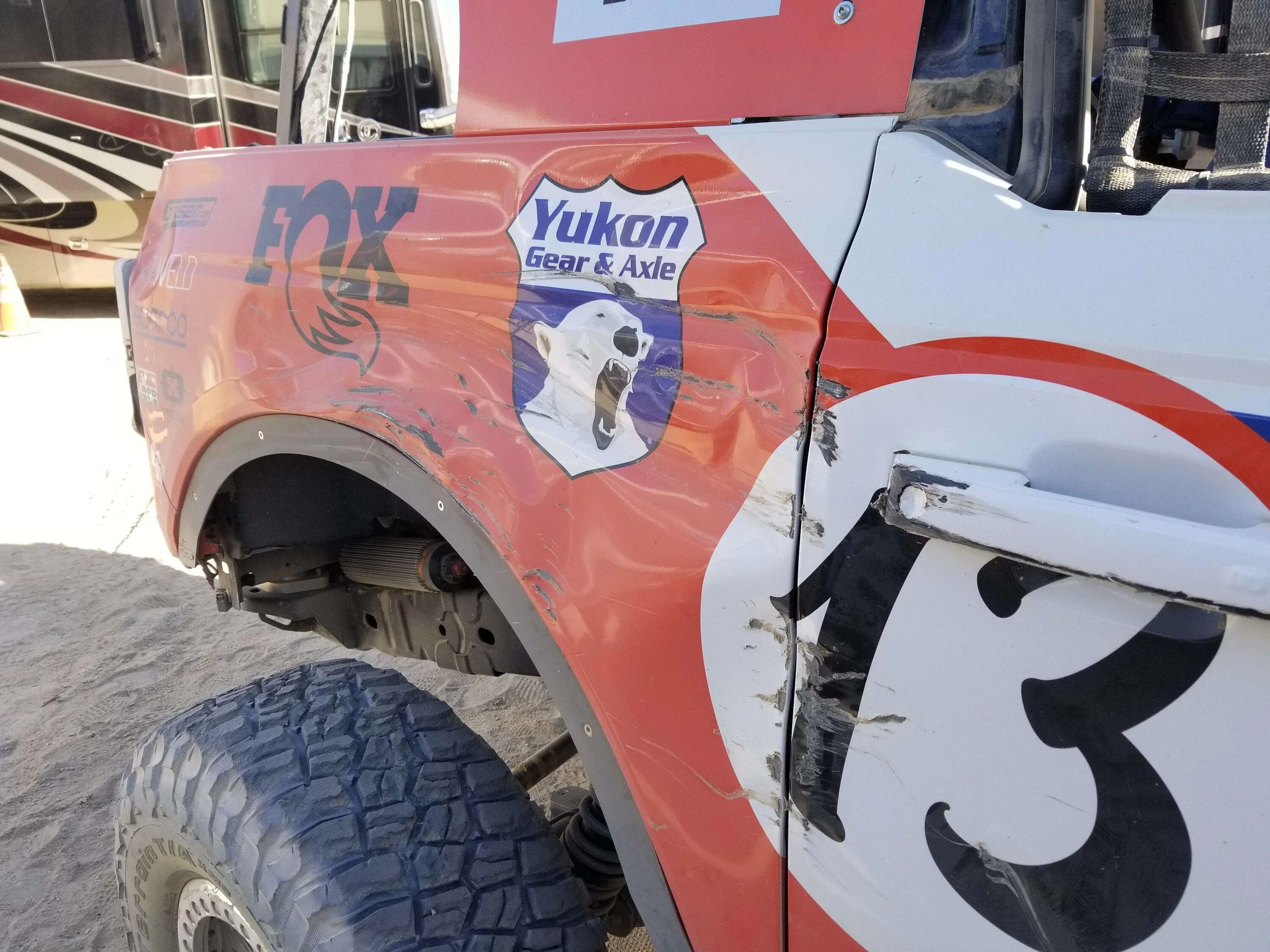

Class rules only allow 3" more wheelbase, and class rules don't allow cutting the sheetmetal to open up the wheel wells. I didn't measure their wheelbase, but if they increased it it wouldn't be by much.
Ford Bronco DIY Bronco Raptor 2-Door ? 20220206_084447
Ford Bronco DIY Bronco Raptor 2-Door ? 272712807_297268642384813_1601380741852206687_n
