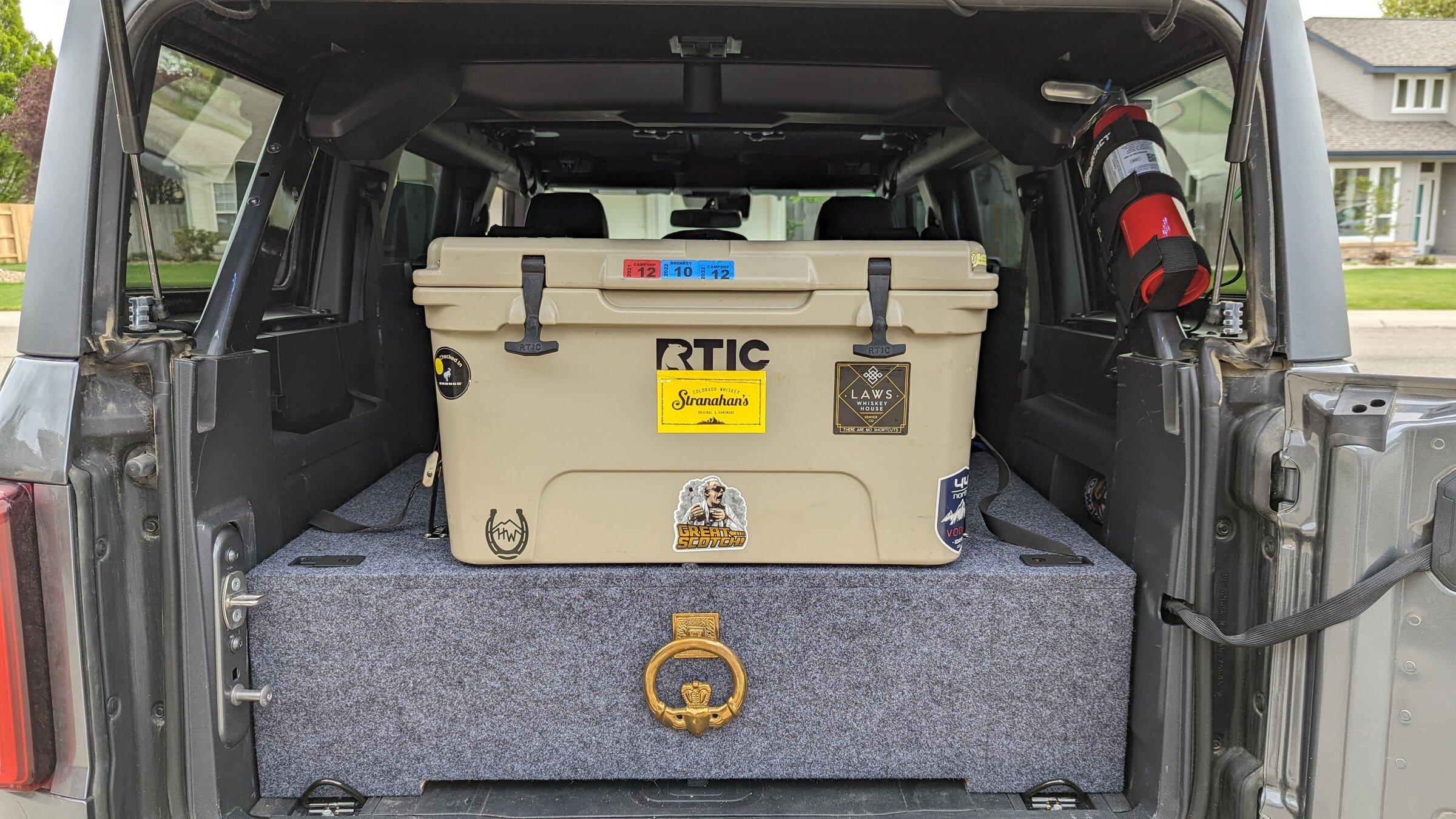

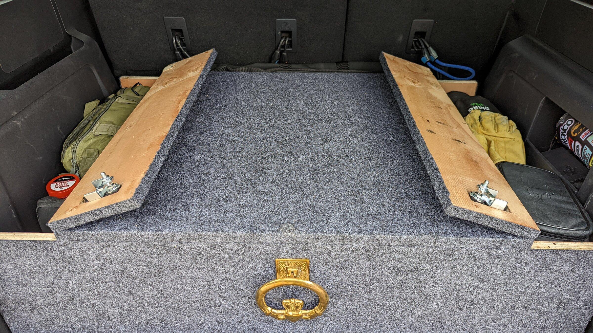

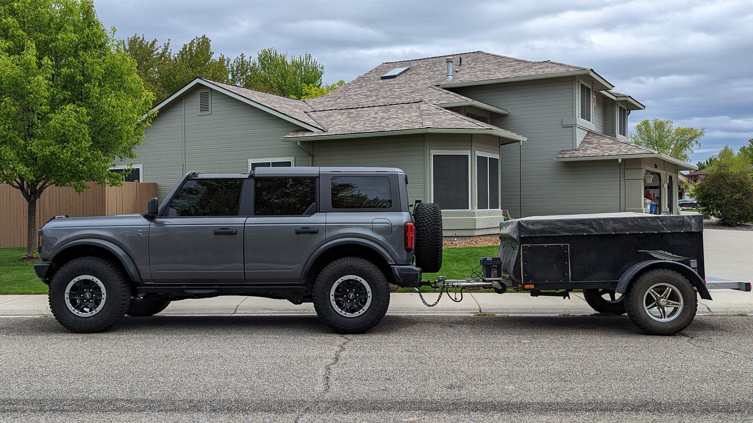

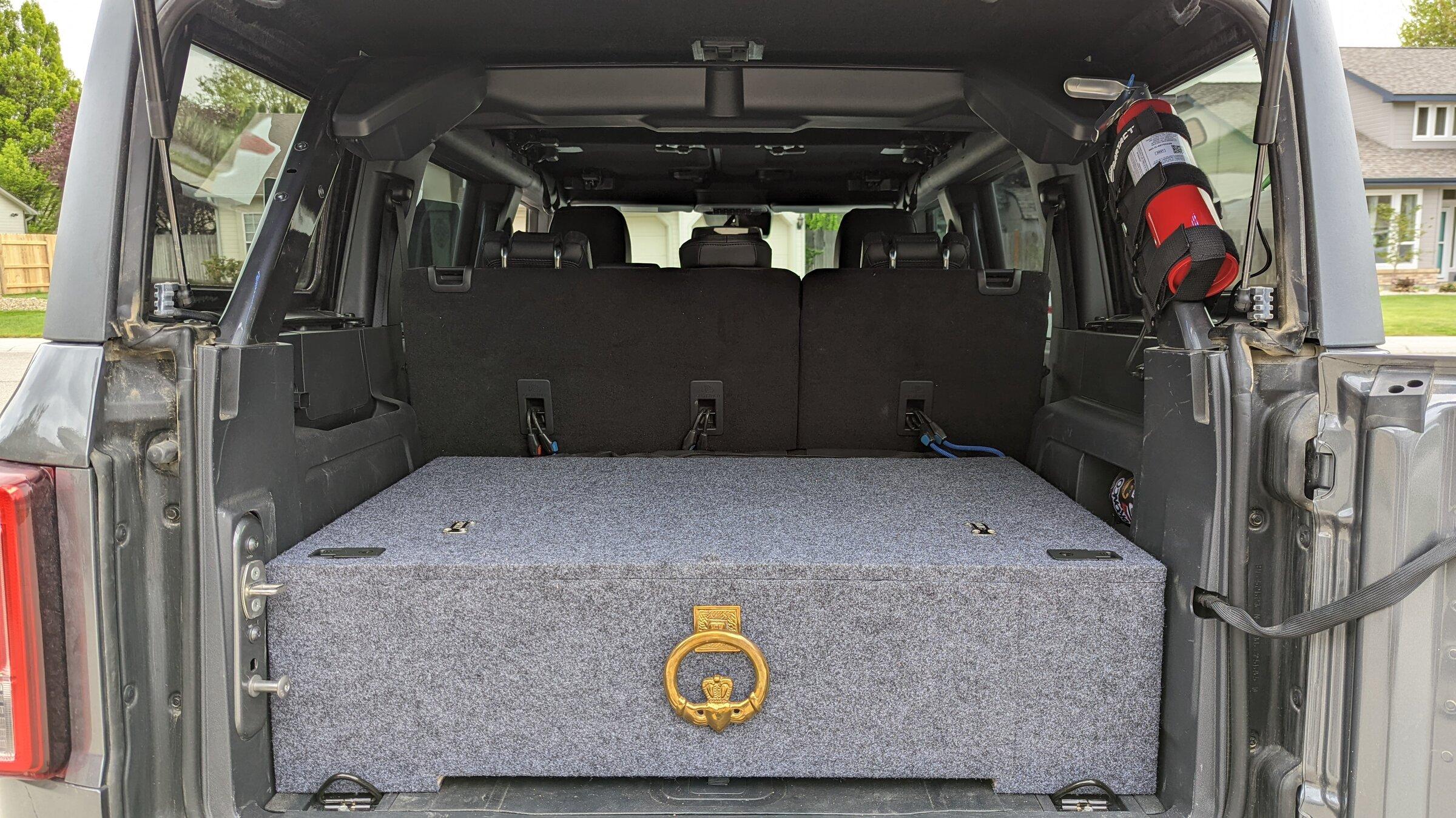

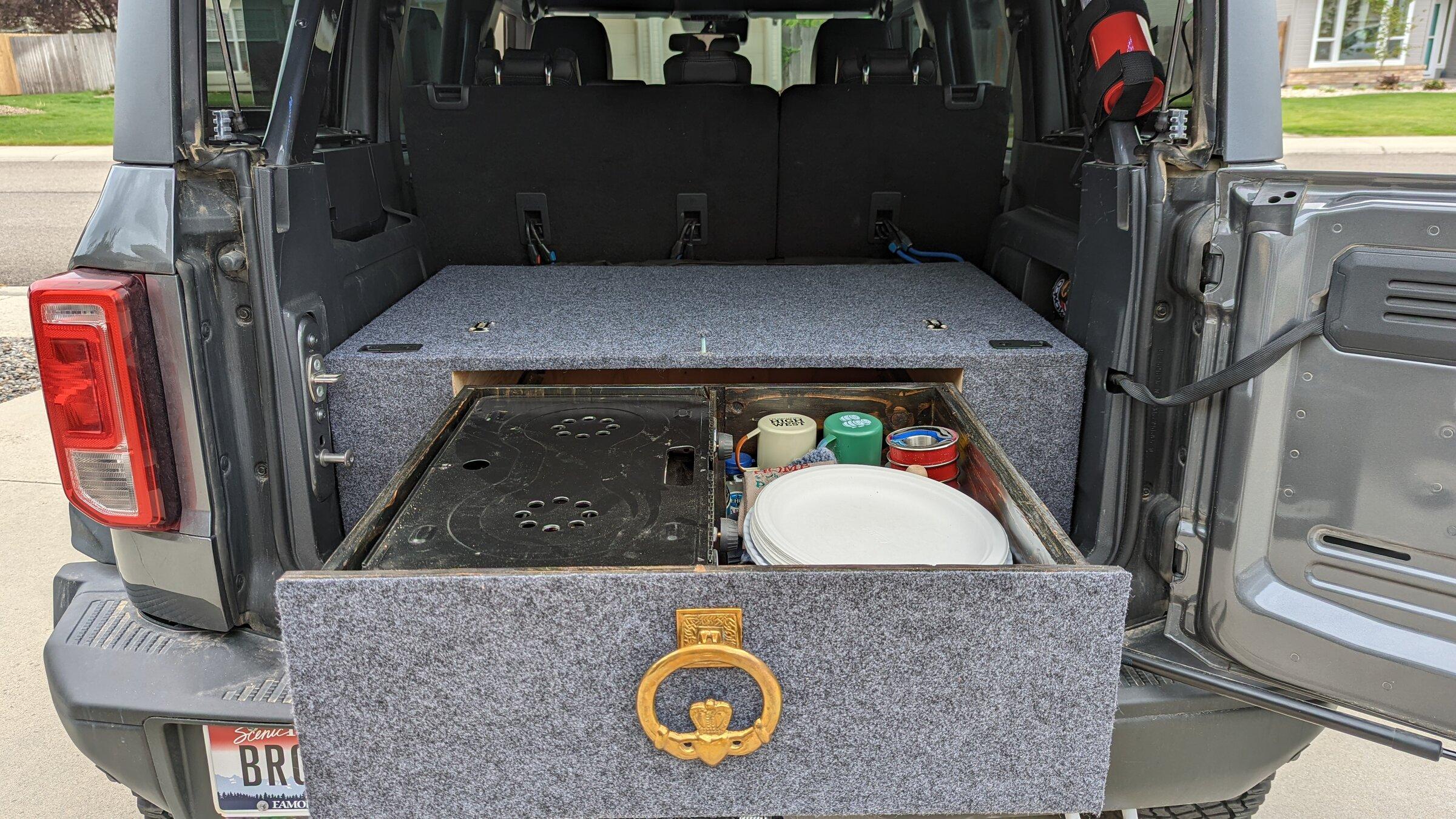

Completed my version of ARB's drawer system. Reused my previous box/drawer for now but will build a new larger drawer down the road (plywood ain't cheap these days). Gave my led lights another shot using Velcro as my previous attempts with double sided tape didn't work. Got the trailer prepped to go, needed longer hitch.

This is awesome. Where did you get your drawer slides?

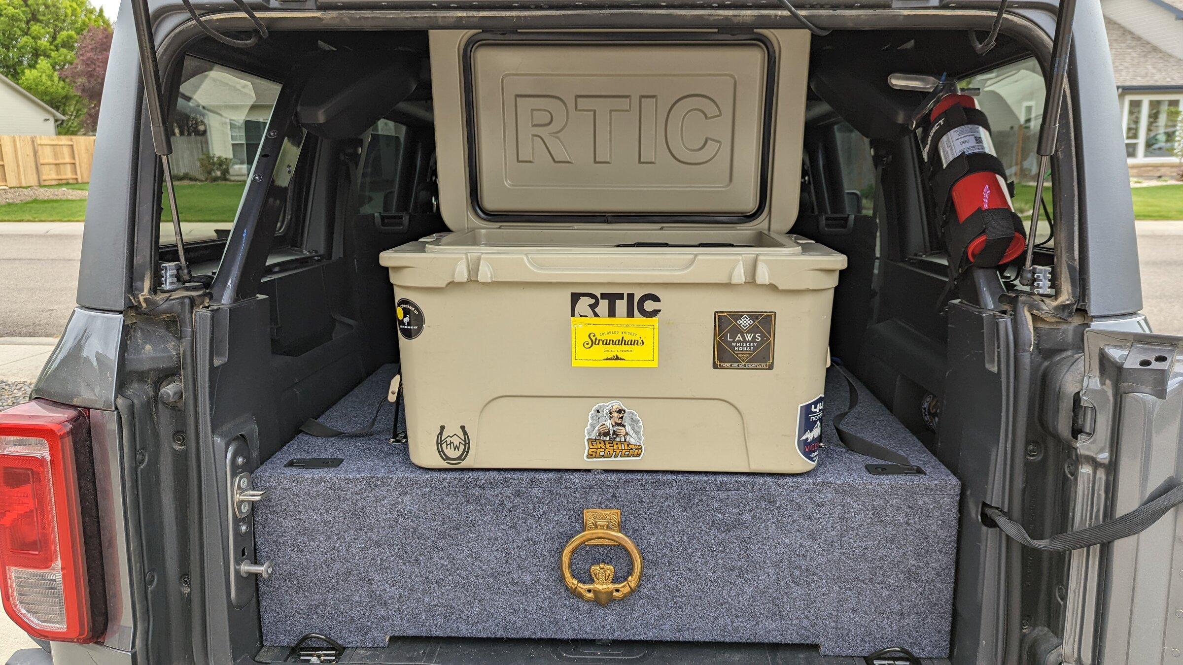

How do you like the Rtic? I’ve been looking at coolers and been leaning towards the Rtics.
What size is that btw?

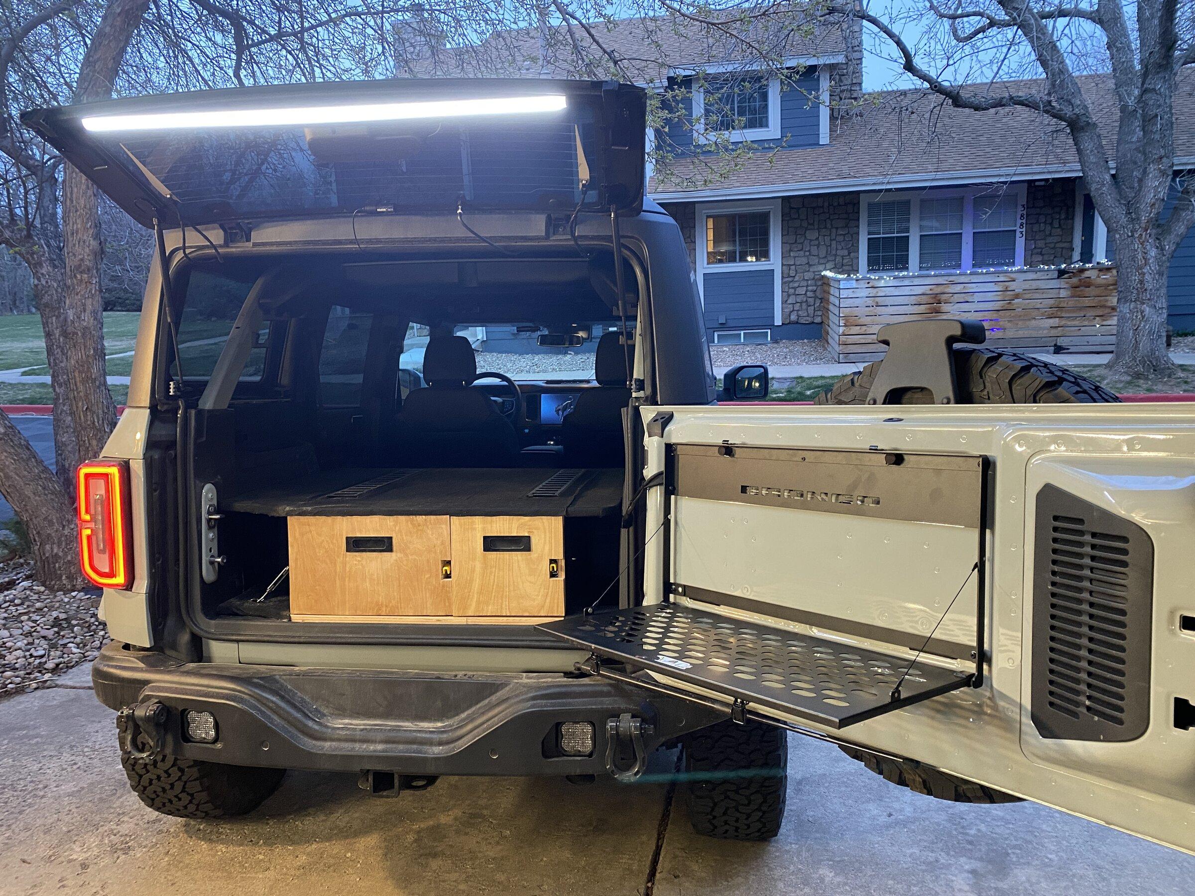

I've heard horror storied @IDyeti about the back hatch lighting, is that aftermarket and/or what was the solution?
Amazon, they are 26" 220lbs units. They have over 5 years of use on them and still sliding.
Its a 45L. Being in the desert I need to move to a 12v fridge for more than 5 days of camping (beer drinking takes a toll on ice). It does its job for a long weekend though.
Yeah its terrible. I got some LED light strips off Amazon. Cut off the power end and soldered on a 12v barrel adapter to plug in the rear plug (need to rewire so its not limited to the power shut off the 12v outlet has). The LED light came with some double sided tape, this stuff isn't great and wouldn't stay stuck to the MIC top. I found a roll of velcro and superglued the LED strips to the velcro then pressed the velcro onto my MIC's sound deadener, it ain't moving now!
Not OP, but I used a Jeep aftermarket lighting strip off Amazon, works very well as it hardwired into the 12V cigarette adapter in the trunk.
Different link to a similar looking product, the one I bought was unavailable.
