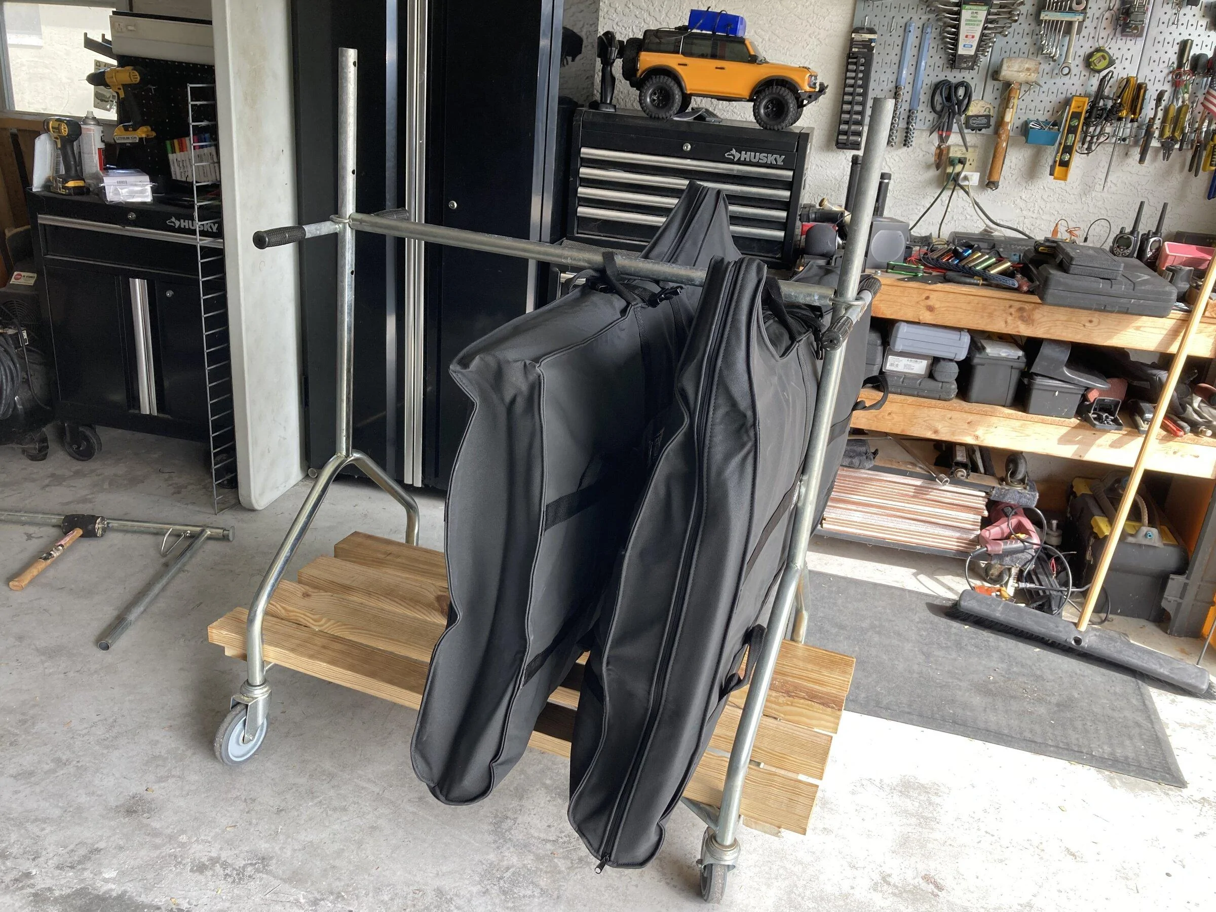

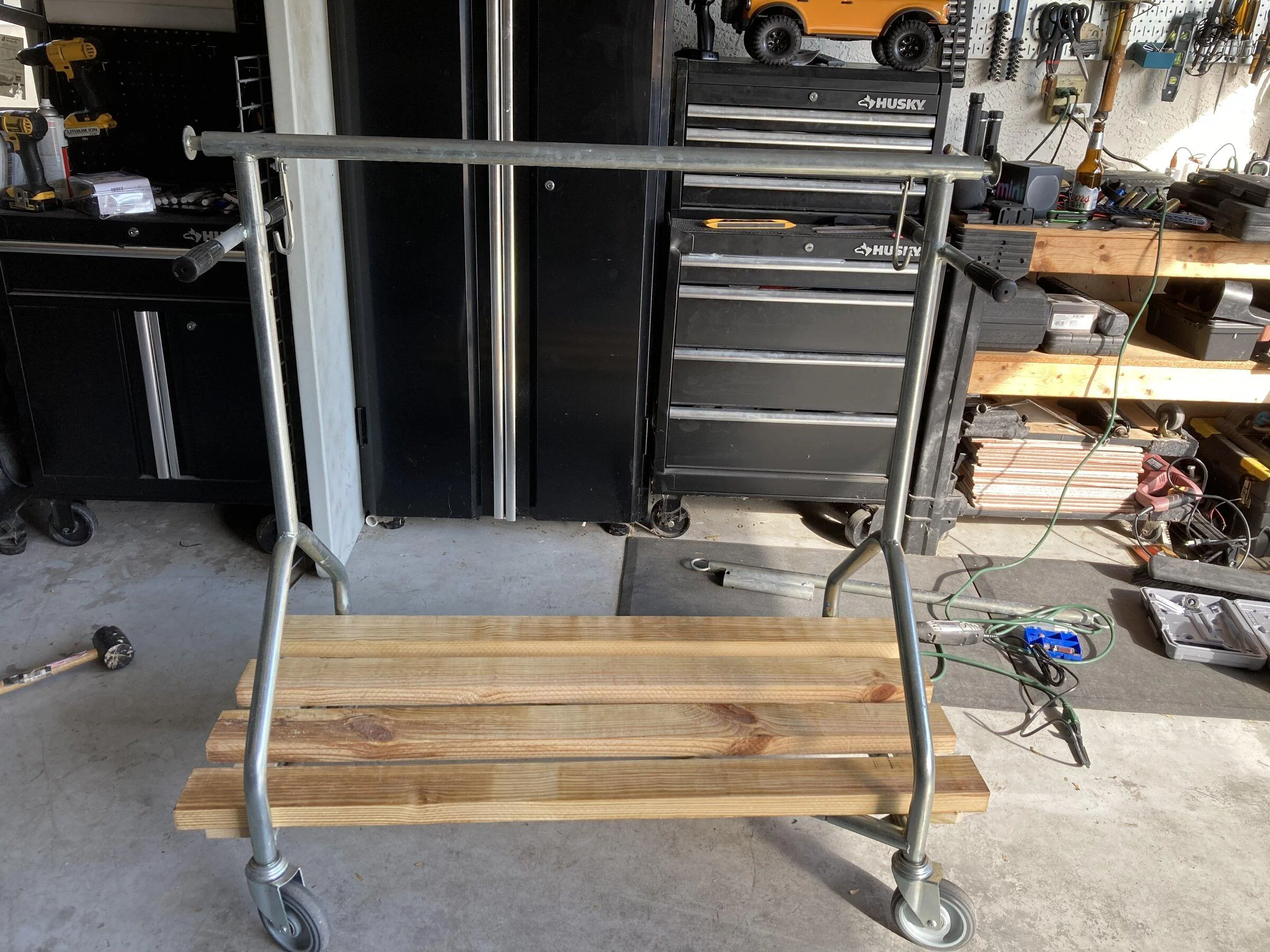

Door cart DIY:

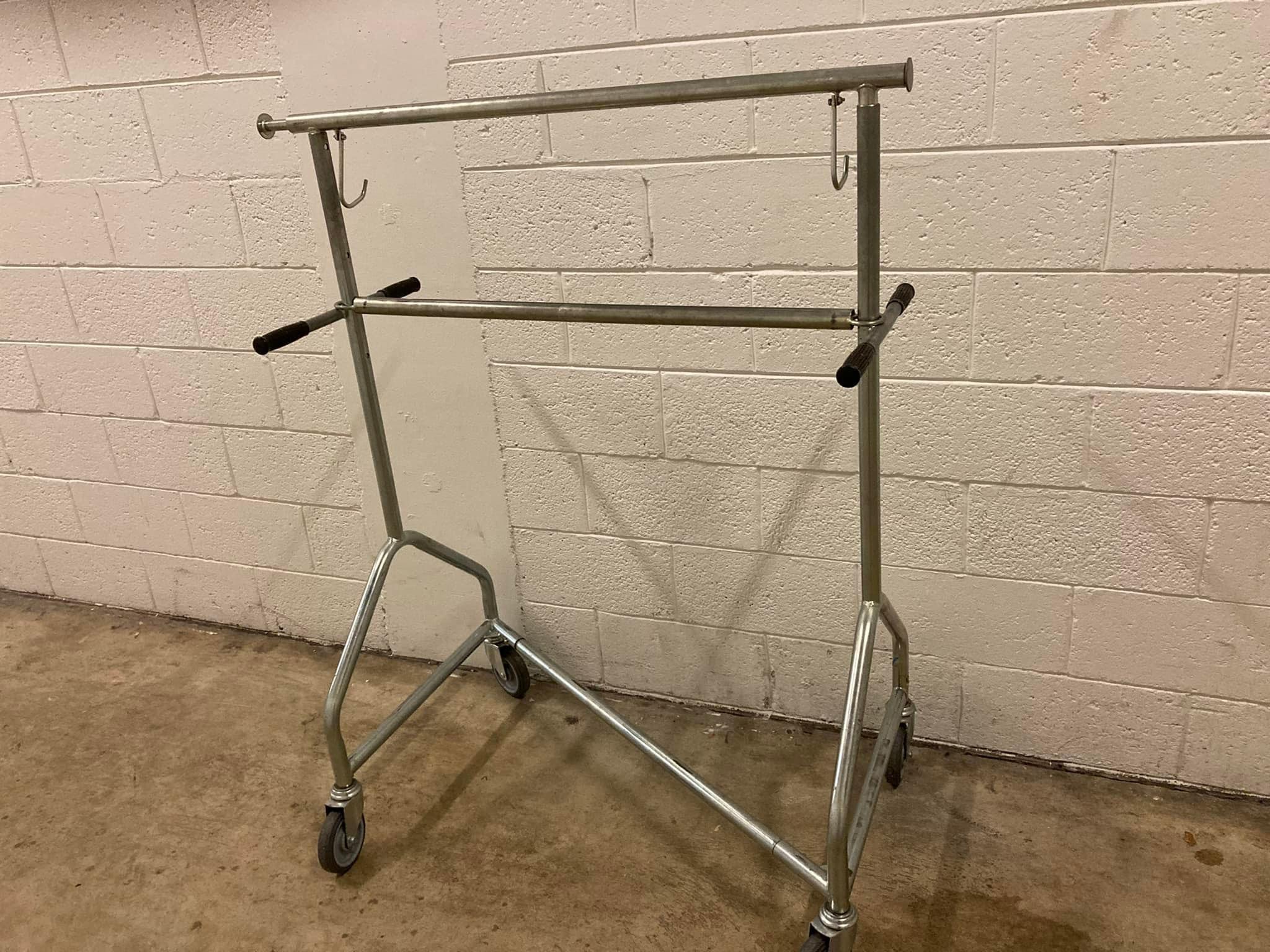

Started as an apparel rack from one of the stores at my mall. They were going to throw it out and I asked if i could have it…

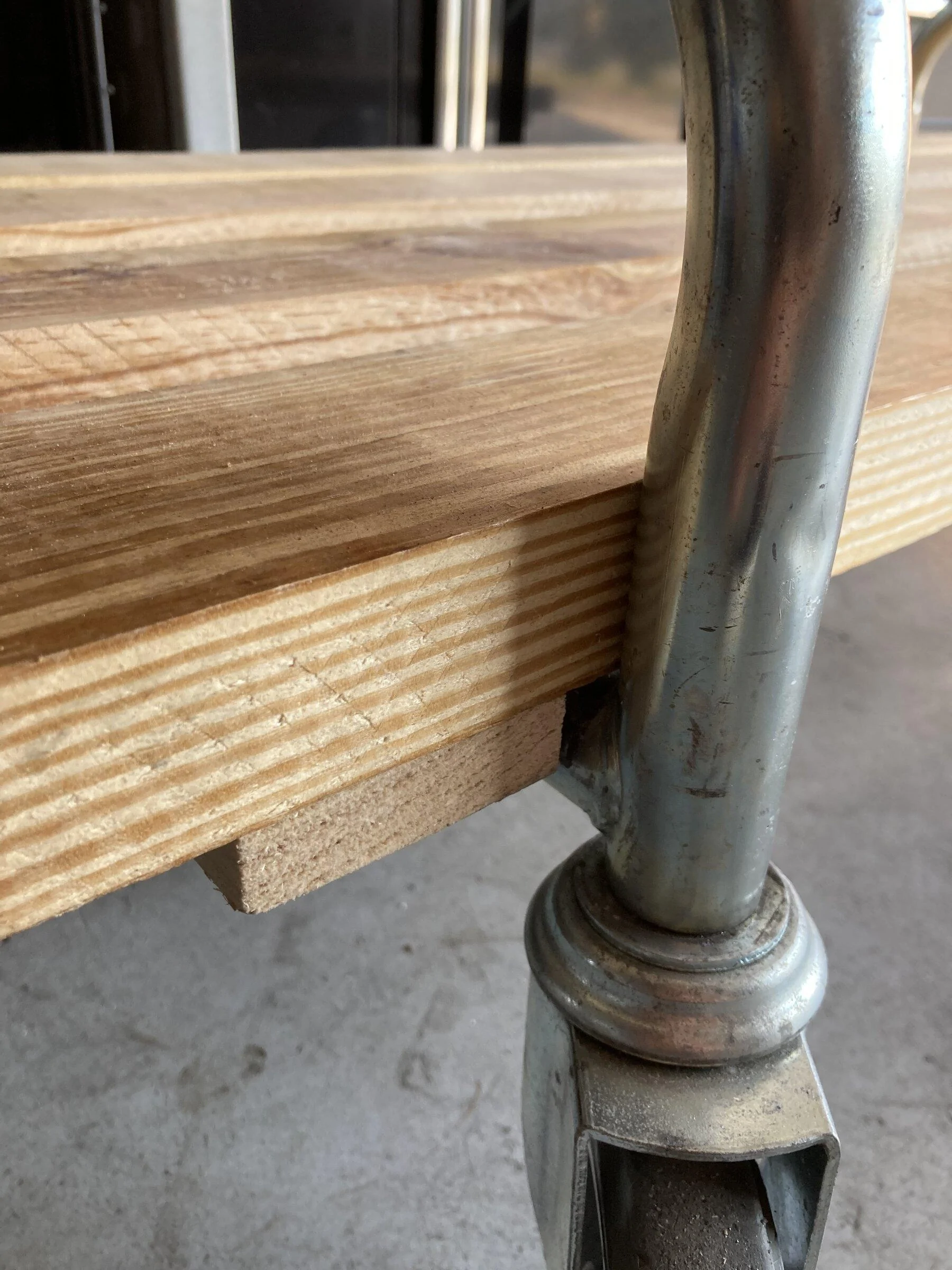

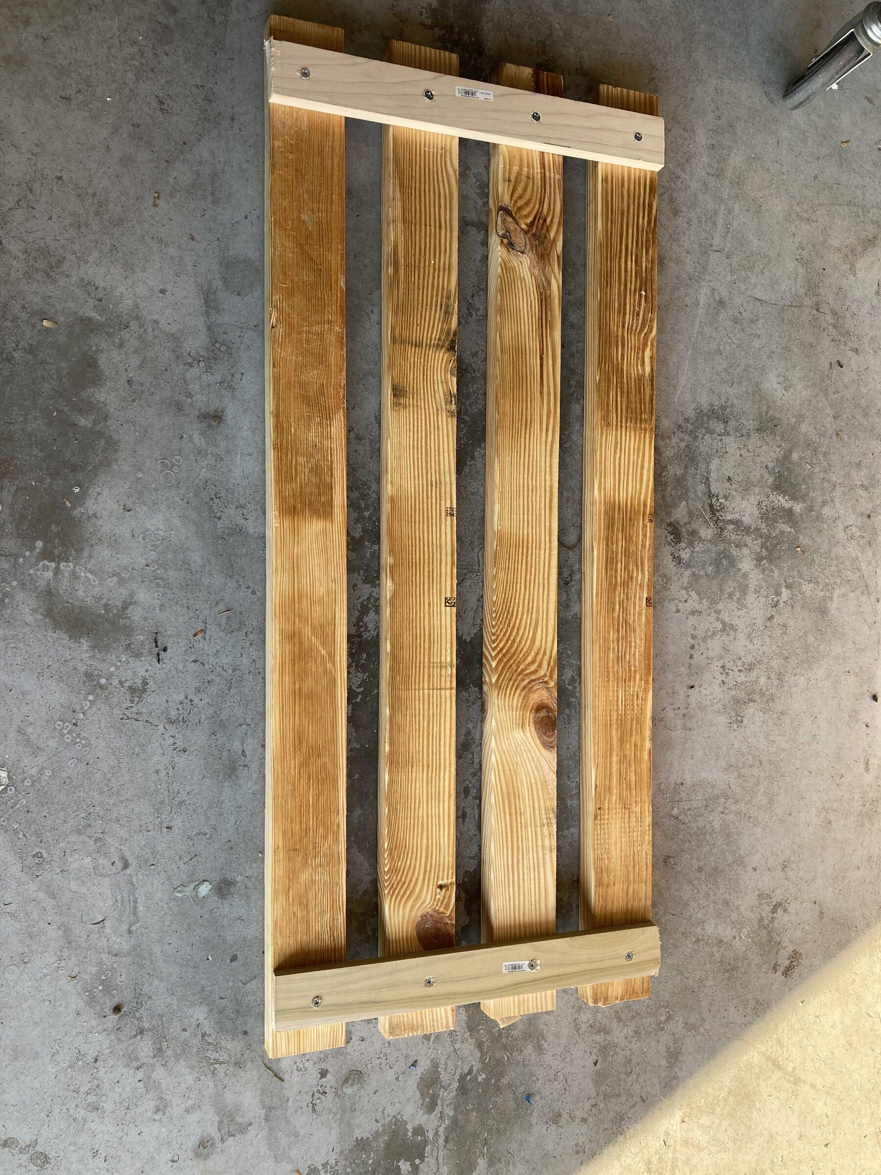

-Spaced out four 2x4 for the base.
-Secured it with two 2 1/2 x 1. I made sure it would catch the cross bar of the legs so it wouldn’t move.
-I was going to place a mat/carpeting but i figured the doors will be in the bag if i take it off. So i guess I’ll return it.
-Chopped off the top bar so it goes down lower. Right now the top bar only has 2 hooks. I might just add 2 “S” hooks for the other 2 doors. Also used Velcro straps on the door bags to one of the bars.
-Don’t really need a divider, but may add one later on.
