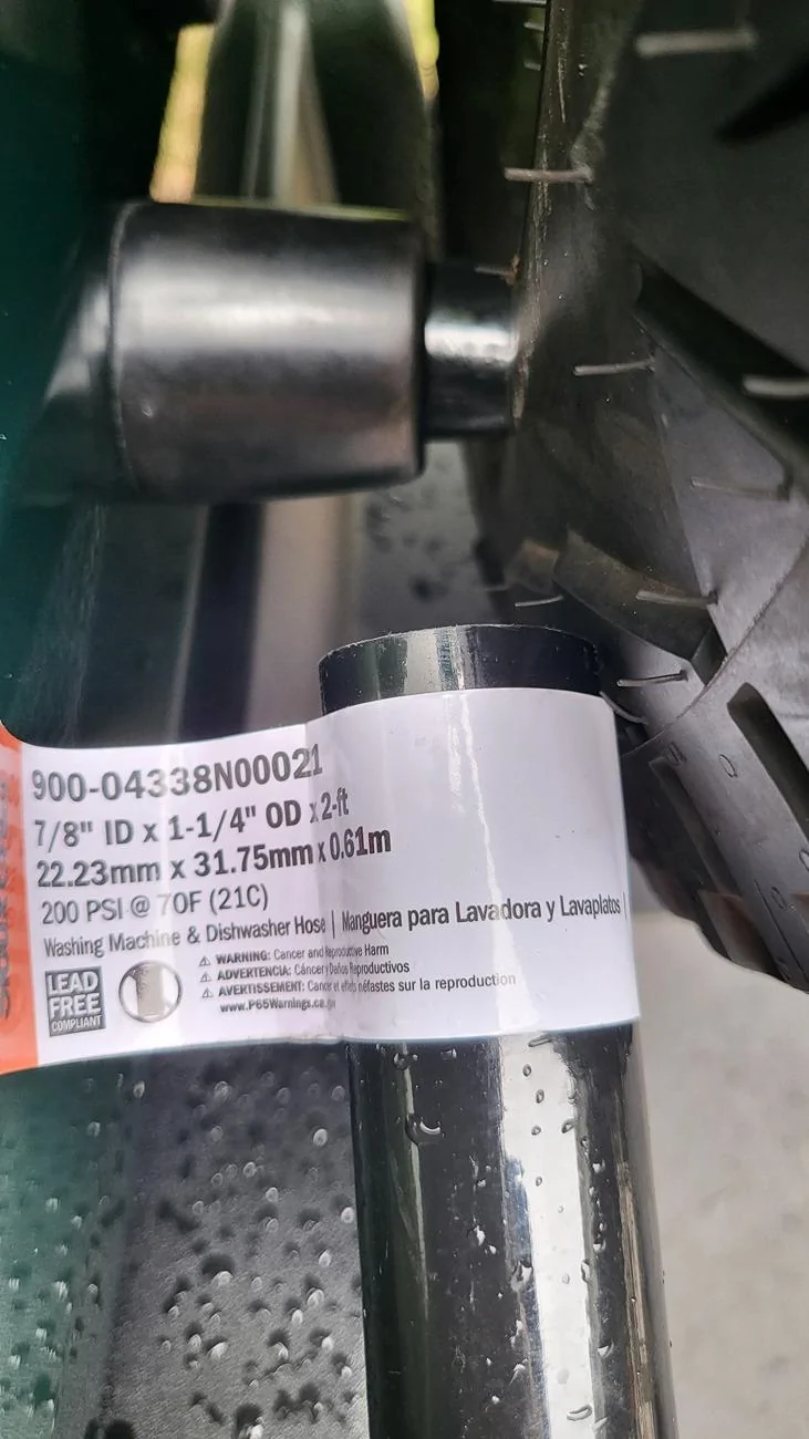

Tip of the day for those that went with a lower offset wheel and need to adjust the spare spacers on the tailgate. You can buy new spacers, of course.
Or this 2' section of dishwasher/washing machine hose is $3.99 at Menards. Measure and cut off what you need, and it slides in snugly. 👍
