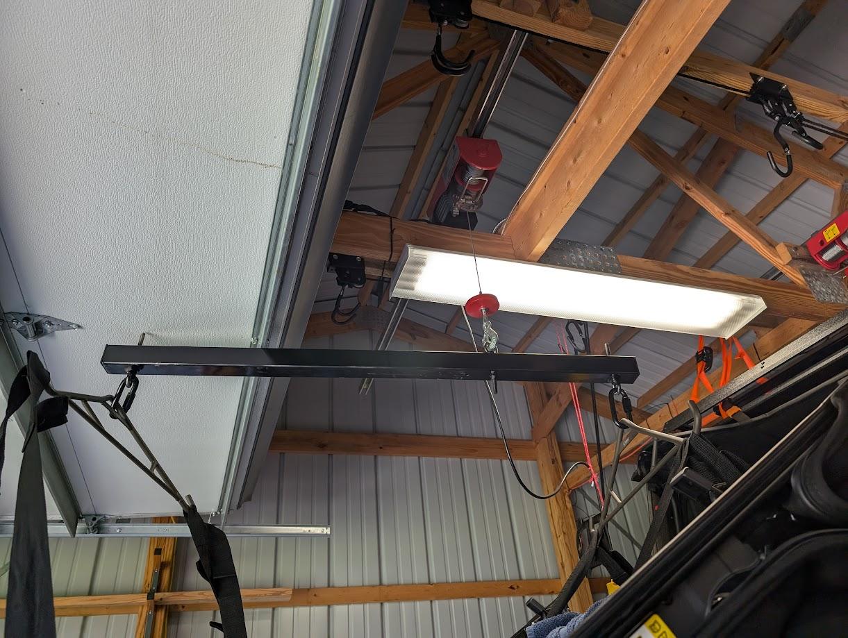

I went to Home Depot and bought a 8 foot length of steel channel tubing, mounted that into the rafters then hooked up the winch https://amzn.to/3Z4kWeD The remote just hangs down so I tie it up so it won't hit the Bronco. I also bought the J-Barr system. https://j-barr.com/products/j-barr-ford-bronco-hardtop-removal-hoist-and-storage-system $450 seems a lot for a steel bar and a couple of straps. However, it is well thought out and $450 is pretty cheap compared to replacing your hard top that falls off my Rube Goldberg contraption. So the hard top is settled.

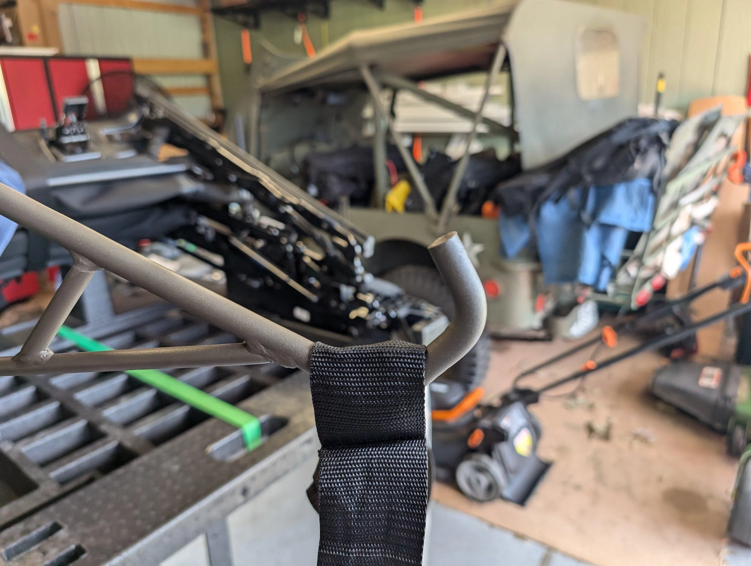

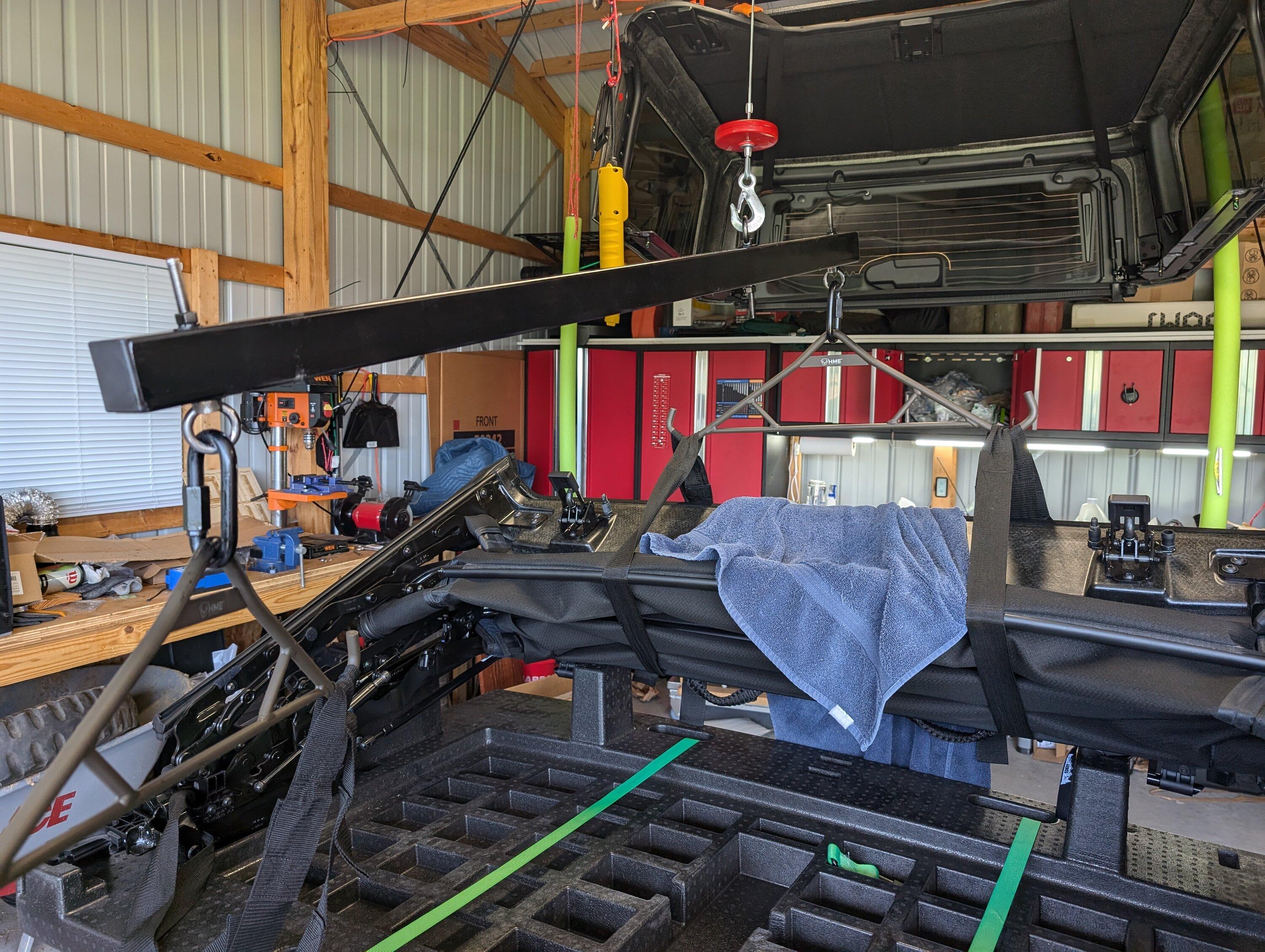

I drilled holes about 1.5 inches or so away from each end. The eye bolts are oriented down. Then I drilled two holes in the bar about 1/3 of the way from one end. The two holes are spaced a few inches apart. I new that the rear gambrel was going to have most of the weight so in an attempt to keep it level under load. As luck would have it the first hole I tried ended up working. After it was put together I slapped some high gloss paint on it. Used the carabiners to connect the gambrels.
Using it. Remove your soft top window panels and store. Fold the top all the way back. Remove the 6 bolts that hold the assembly to the Bronco. Hook the tube to the winch. Put a towel in the middle of the folded top so that the tube is pointing to the front of the Bronco. Take your Kayak straps and wrap around the fold top and connect the strap loops to the gambrel. Do this for the driver and passenger side. For the front gambrel use the straps and run them thru the front of the top at each corner. Be sure to avoid any plastic parts. Hook to the gambrel, one on each side. I put towels or blankets around the roll bar to mitigate against scratches. Slowly winch away until the soft top clears the Bronco. Drive the Bronco from underneath the soft top.
Set up issues. The only problem I had is that the all of the straps did not want to stay looped onto the gambrel. If you loose tension on one side it can come off. The good news is that only one of the strap loops came off. There are two per side and the other loops in the straps are "locked" into place on the top so they don't come loose. I think a clamp is all I need to put on the gambrel ends to keep the loops from coming off unexpectedly.

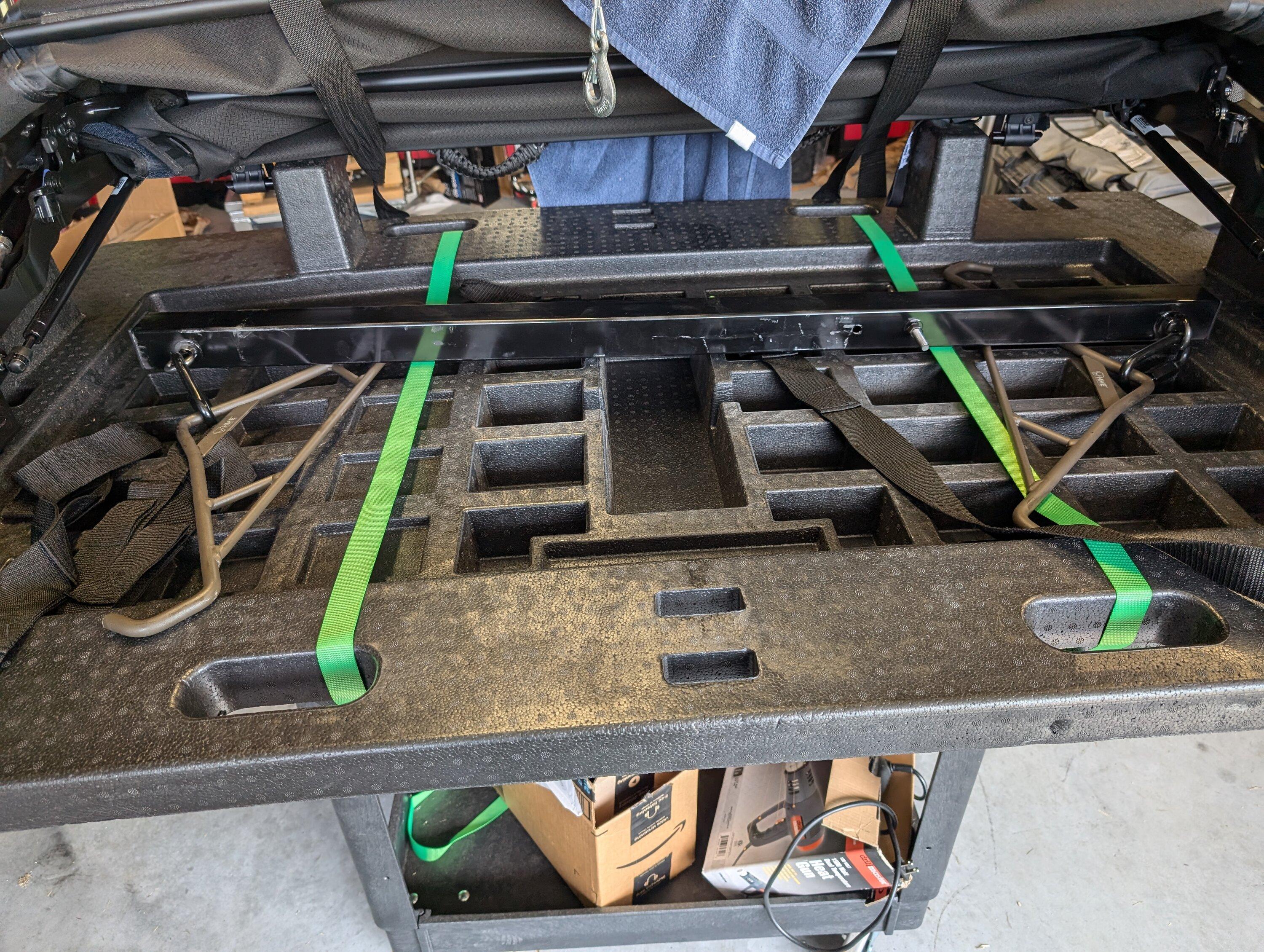

Storage. I bought a cart https://amzn.to/4fIMQCF and with a couple of boards placed in the cart to provide some support, I place the empty soft top shipping platform on the cart. I position the cart in place and lower the top onto the platform. This way I can roll it around my barn instead of dragging the dang thing like the first couple of times.
