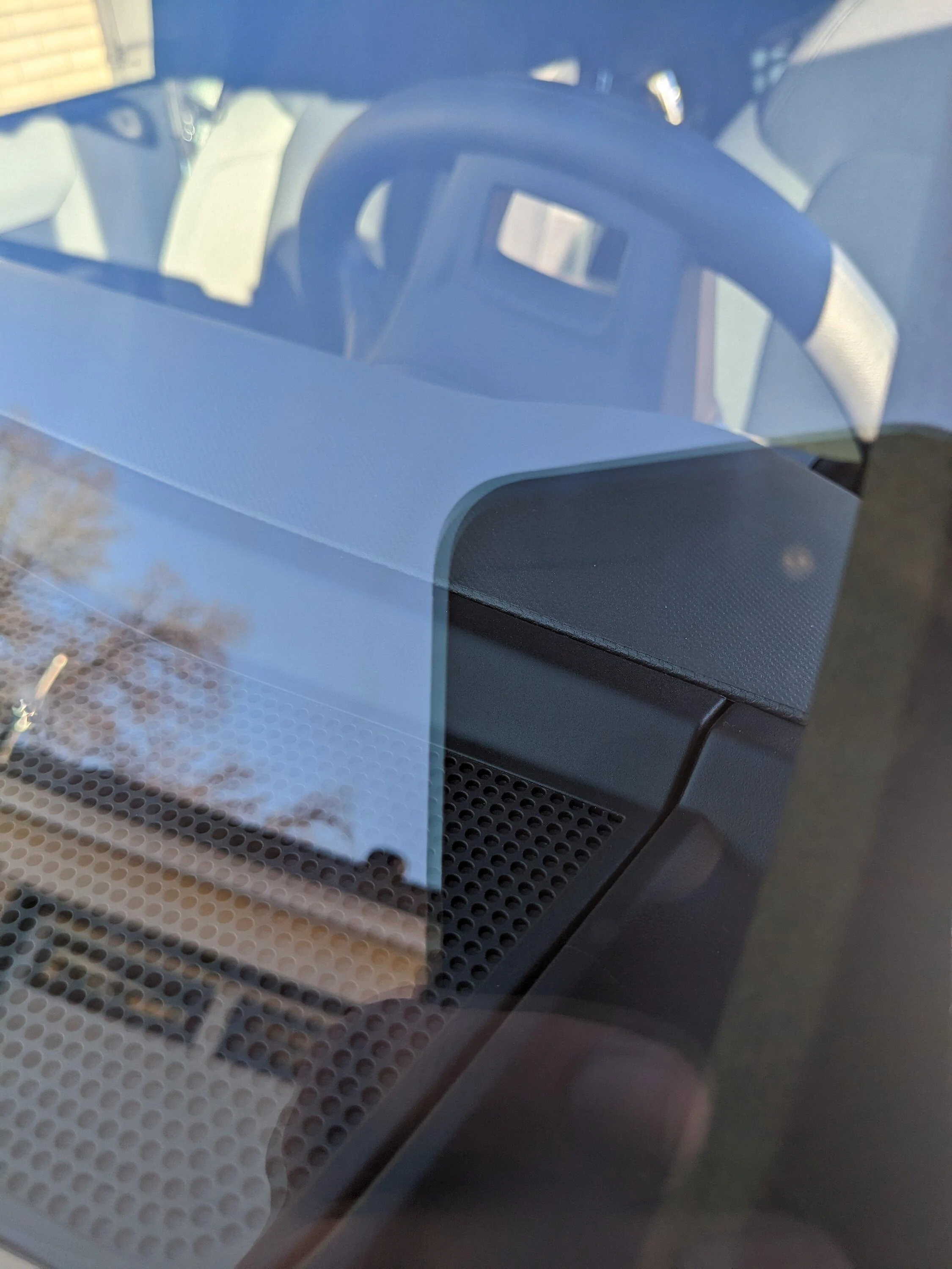

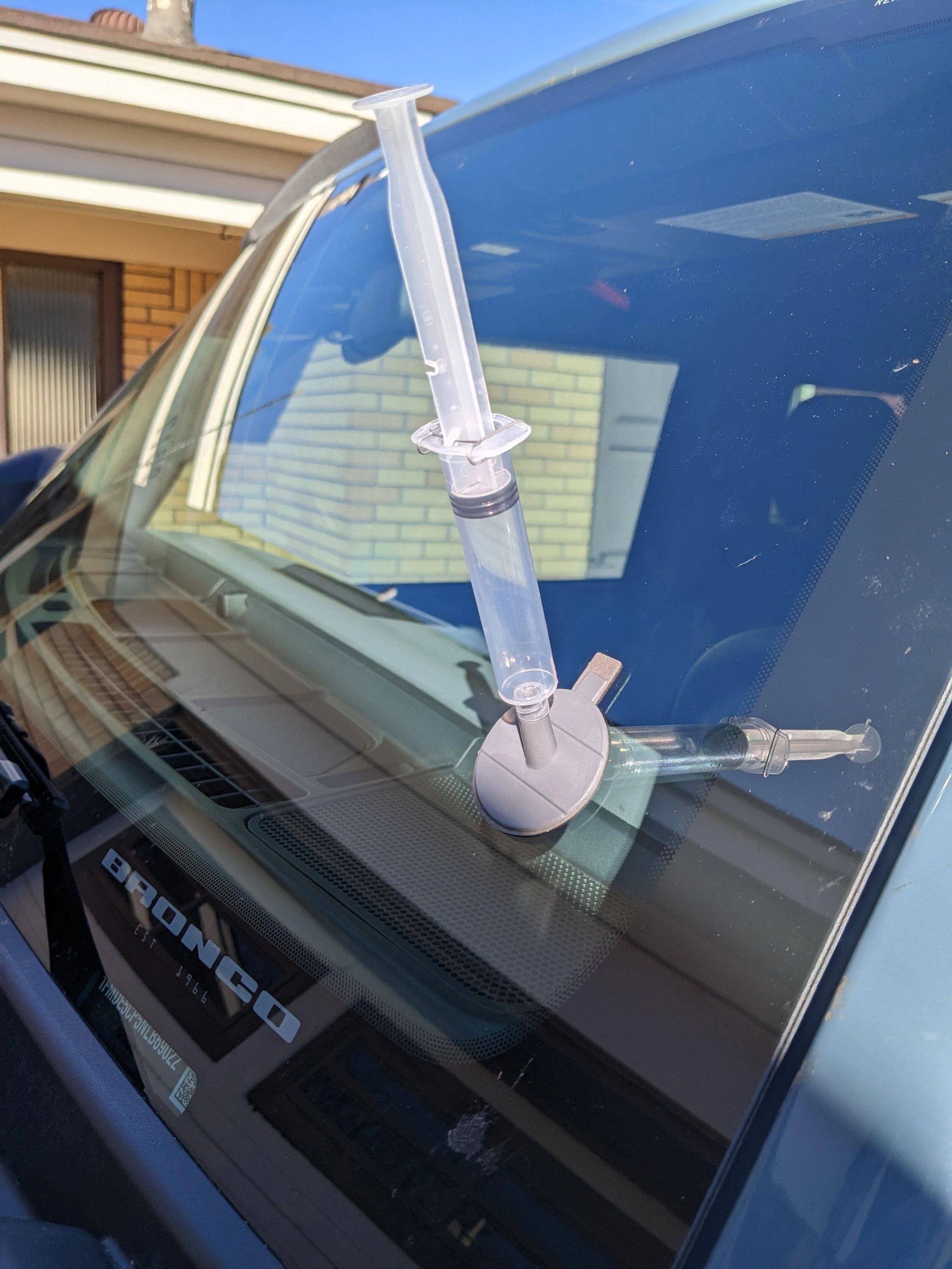

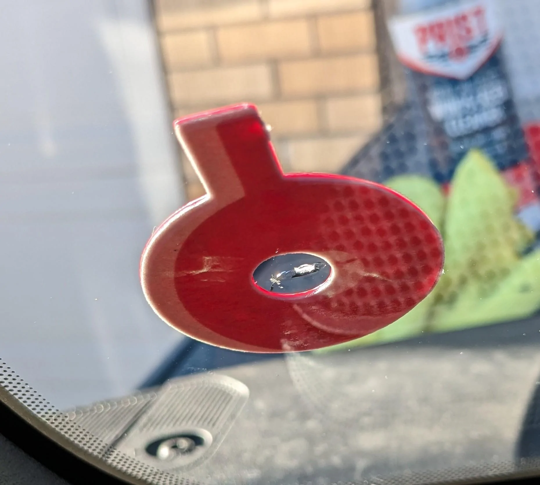

Fixed a windshield chip myself today. It's pretty easy and took me about 45 minutes, but would have been less if I knew what I was doing. Results are pretty good - I can still see the chip a little bit (my own fault) but the small cracks are completely filled so I'm not worried about it spreading.
It is a UV resin, so be sure to perform in the shade or it will start to set up before the process is complete. This was my mistake. Overall I'm happy, and it only cost a few bucks.

Can you circle in the last picture where the repair was made? It obviously works as advertised as I'm having trouble seeing the repair. I have a Jeep that could benefit from this kit.

Never done this but I’ve heard of it. Wonder why that syringe is so HUGE? Looks like something you’d feed a baby Rhino with. How much material do you have to pump into that little star?
The syringe isn't for the resin, it's to pull vacuum to draw the resin into the entire chip. It only uses 5-6 drops to fill the repair.
I can't find it in the picture either. I'll see if I can get another one. The only reason there's still a small divot is because I did it in the sun and the resin started to set up prematurely (my fault, not the kit's). I'm going to redo the final step today with the leftover resin and my guess is I won't be able to tell it even happened.
