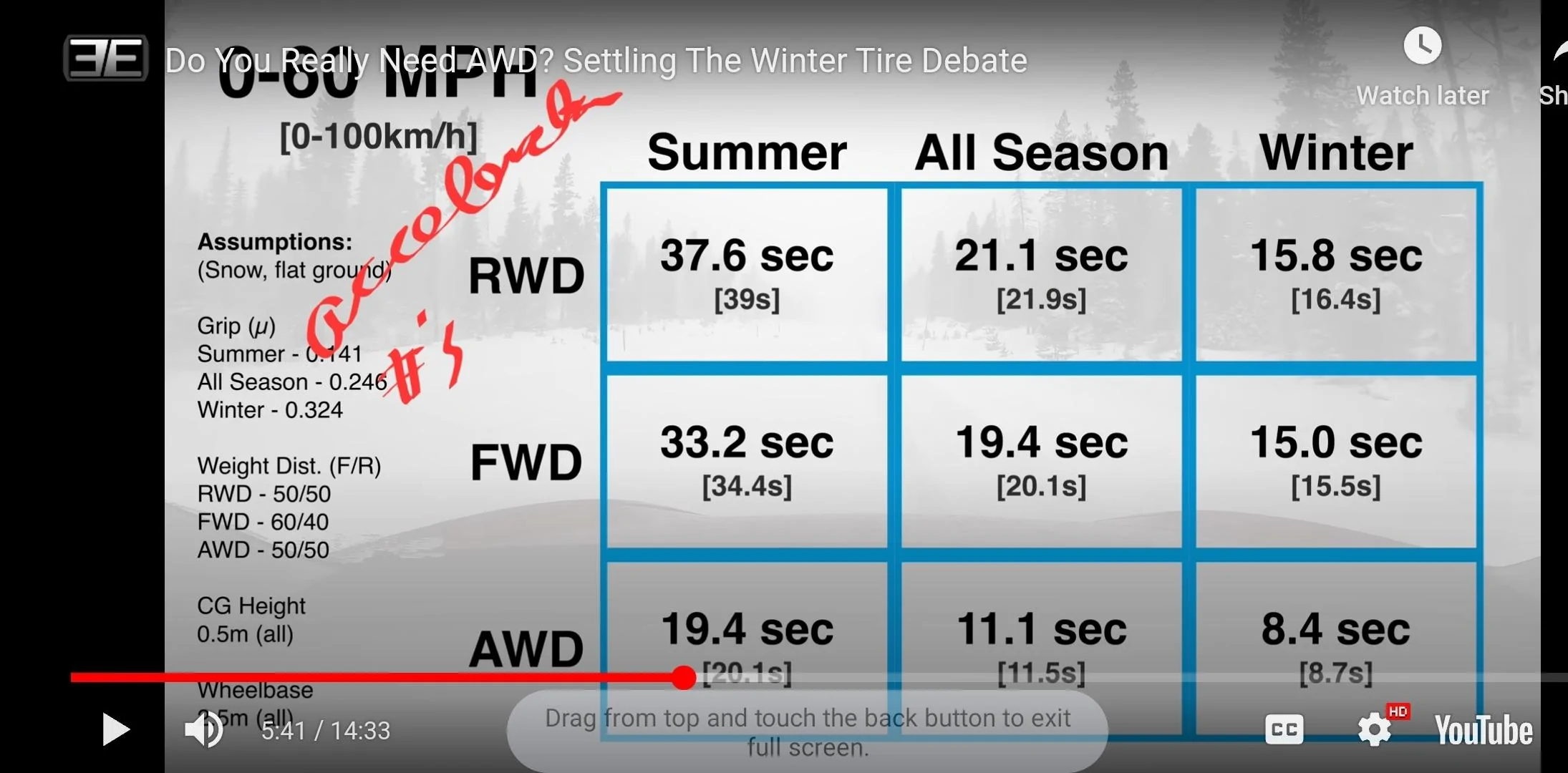

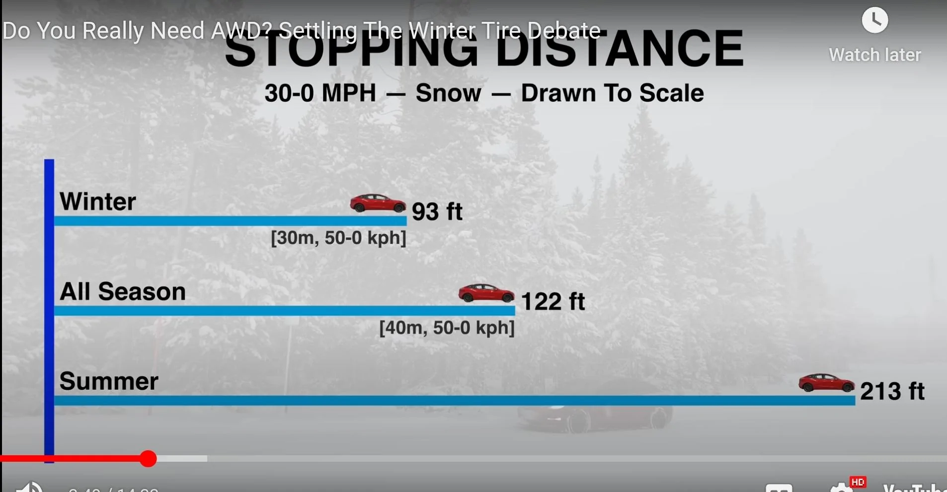

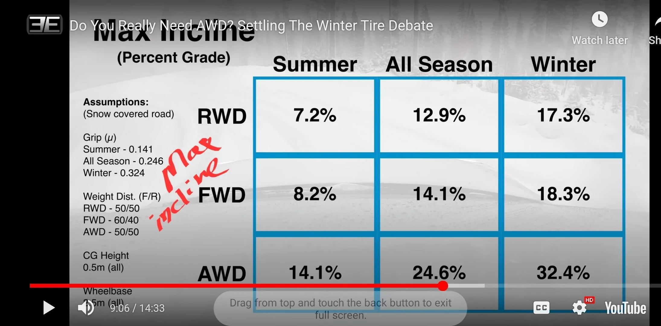

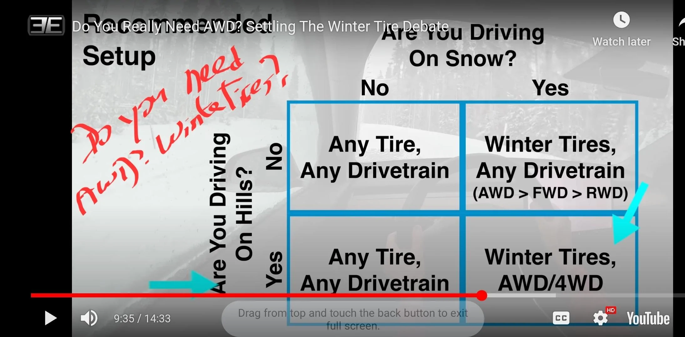

This video explaining a theoretical analysis of the differences in safety performance between AWD, RWD & FWD is very well done. Adding in the 9x factor of Summer, Winter & AllSeason tires is 9 times important (3×3=9 scenarios)!
Caveat: 1. This is a theoretical analysis using grip numbers, not a TireRack real-world comparison on a test track. In any case, the conclusion that in SNOW, Winter Tires with AWD are superior to all other combinations is valid, and matches my experience.
2. This is a Bronco site, so our results will vary:
A. Our sub-category would be a comparison in snow between AWD (the Advanced Transfer Case Auto setting) and 4WD, the basic 4H setting on our Goat Mode dial. This is important because not all Broncos have AWD, many have 4WD, including in 2024 the non-SAS OBX.
My personal experience is that in Snow on Asphalt, AWD is safer and superior than 4WD, but since I got my Bronco after moving to snowless SC, I'd like to do a new comparison in the snow. Or do I?
B. Also for Broncos, a comparison between modern Ice & Snow tires, like the Hankooks in the video, or Blizzaks, and Snow-Rated off-road tires like the Mickey Thompson BajaBoss AT would be important for us. Not all Bronco owners are aware of the subtleties of rubber compound that make a true winter Ice tire function. For me when I lived in Adirondack Snow, Ice was the more fearsome enemy. The Ice capable tires work by using a softer rubber compound, along with a winter tread similar to an AT tire, that will wear off quickly in Summer or peel off quickly off-road.
So its important for off-roaders to realize the trade-offs for their AT/MT off-road tires in winter. Digging into deep snow: excellent! Traction on Ice: Not so good. Which for me would mean that IF I still lived in the Adirondaks, I'd be using a set of my 18" OBX wheels for winter Ice Compound tires, for 4 months, and another set the rest of the year.
For off-roading in deep snow, I dont know which is better. Maybe chains, since the Ice rubber may wear away too quickly. Someone else commrnt on that!
