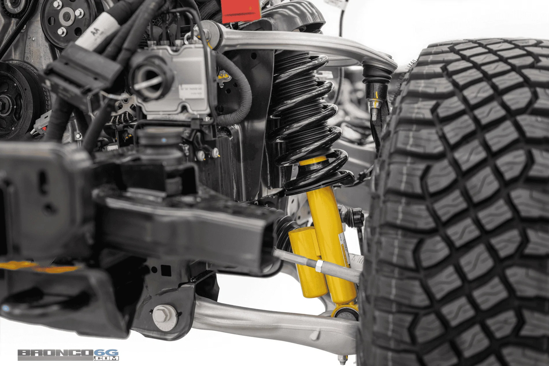

I know there will be base plates available from Blue Ox et al, but I tend to go my own way. Models with the Modular Bumpers have D Ring mounts and most tow bar manufacturers have D Ring adapters. But the D Ring mounts are quite high, requiring quite a lift on my motorhome hitch. Looking at trims without modular bumpers they have a low mounted tow loop that would be about the right hitch height. Any guesses if this would be stout enough for a tow bar mount? It's stout enough to yank the rig out of a mud hole right?
Trying to decide if I should opt for the modular bumper, I like the looks and the D Ring potential, but the standard bumper set up looks more adaptable to towing.
Ford Bronco Does anyone plan to flat-tow behind a RV? 1606434790786
The lower loop is in the lower left of the photo, the D Ring mount is on the end of the frame horn.

If you go with the mod bumper you won't need a base plate, just tow bar off road end adapters sold by BlueOx. It may be required to replace the stock D ring mounting bolts with hardened steel ones and drill and add one additional bolt, not sure yet as when I talked with BlueOx they were still waiting on design sheets from Ford.
