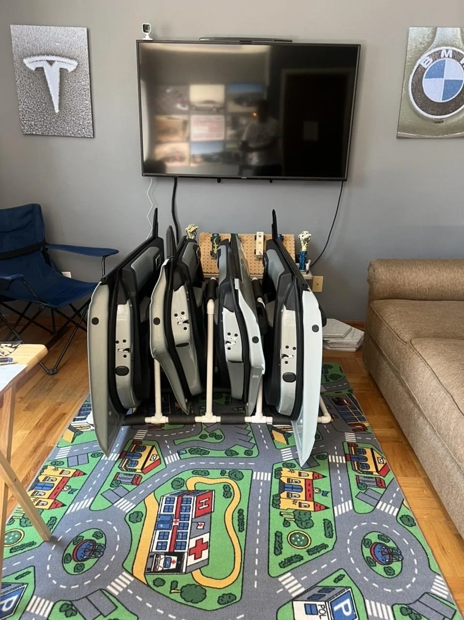

Would probably recommend mounting on 2x4s/plywood to give it a good base for wheels
I havent glued mine together - the full coverage foam is nice!
