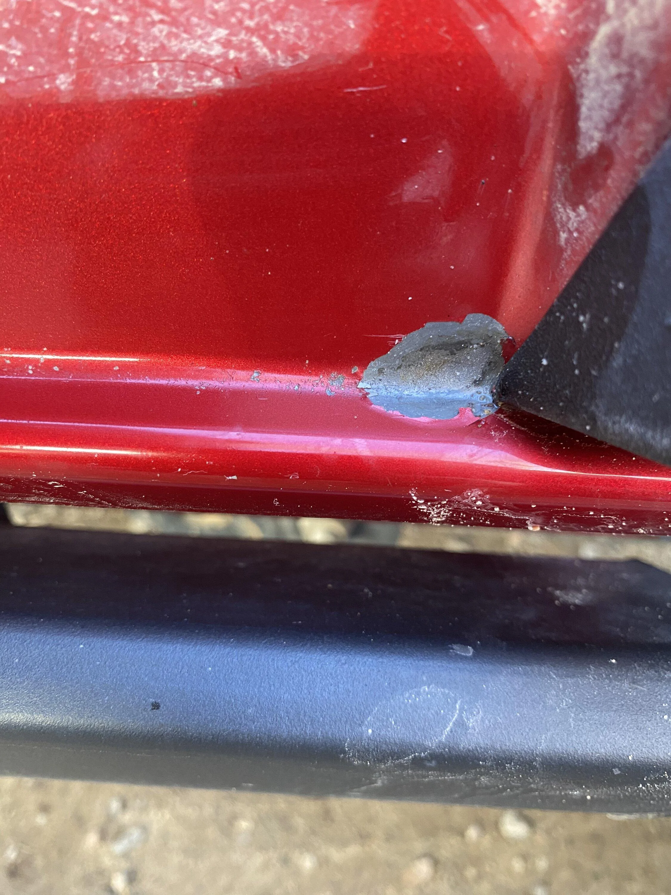

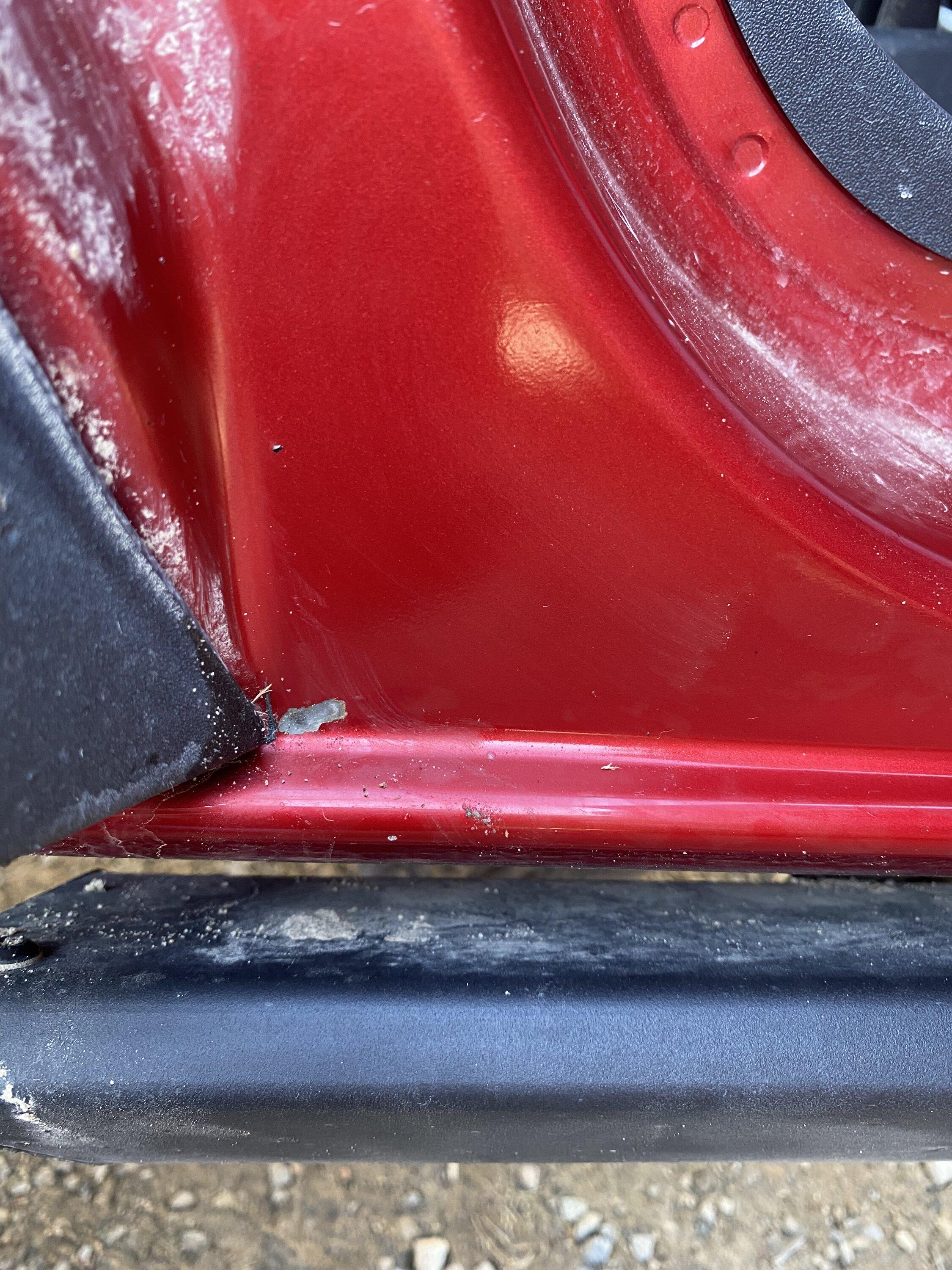

my 4 door is going to the body shop tomorrow to get this (and one other paint issue) fixed. I went there last week to have them look at it and they might just try a rubber mallet or something to bend that low corner of the door out just a bit, I guess would have the same effect as the folded shop towels.
I'm fine with just touch up paint there, it's invisible enough that repainting more or less the entire door frame would be silly overkill IMO.
Hope they do a nice job, it's a body shop with a very good reputation that's been in business for decades, pretty sure they know what they're doing.

Nice! Mine is in the shop as we speak. They realigned the doors, and are fixing the paint entirely (the right way). Ford is also reimbursing me to get my ceramic coating redone. So overall, Iā€™m pretty happy with how they are handling it!

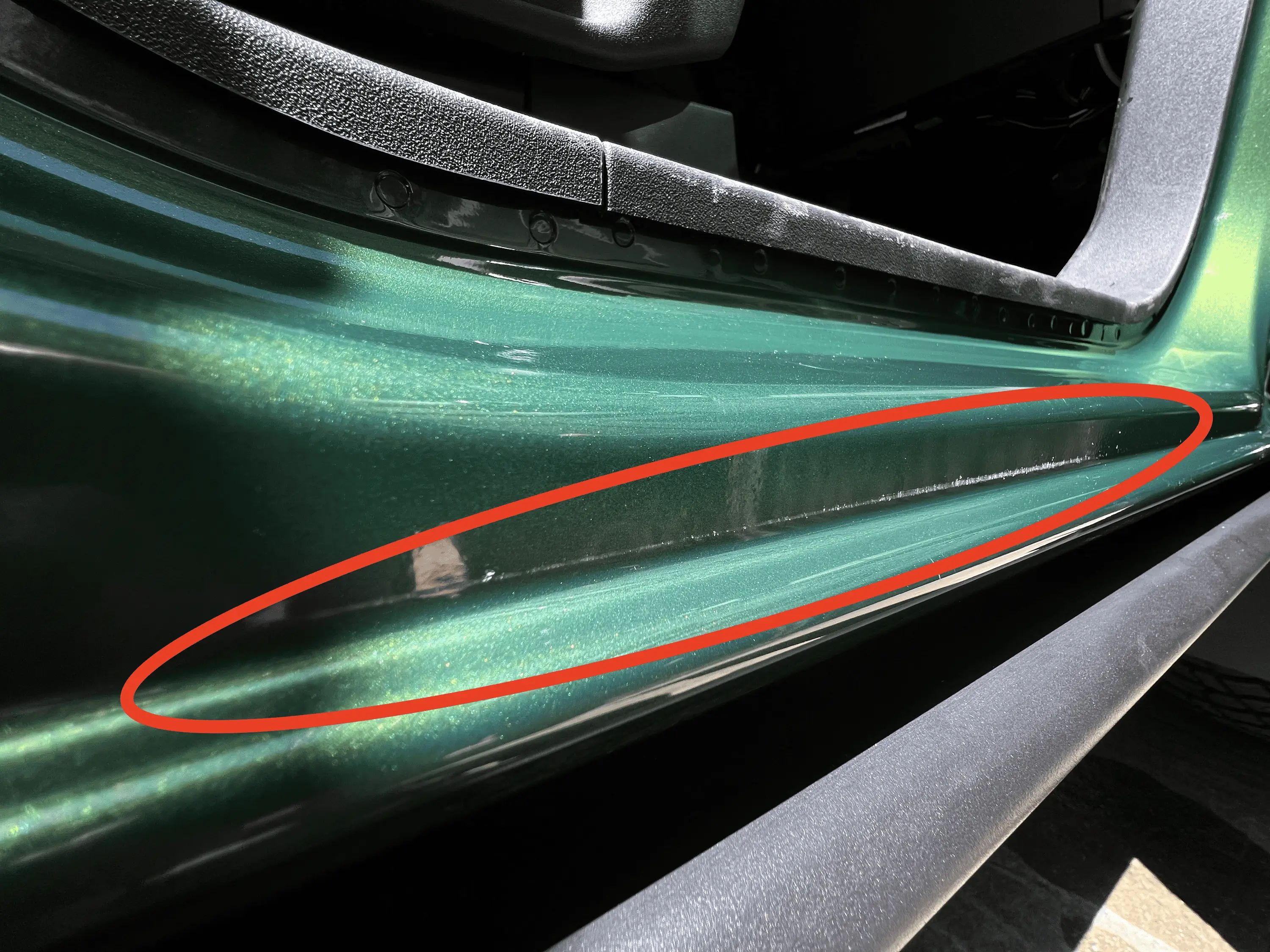

Hey all, I created a thread about my problem before realizing this one existed. I have the problem described in this thread about the door corners. In addition to that though I have this long long line of paint missing from the bottom of the front doors. I'm assuming same problem but another location. Check your doors too!

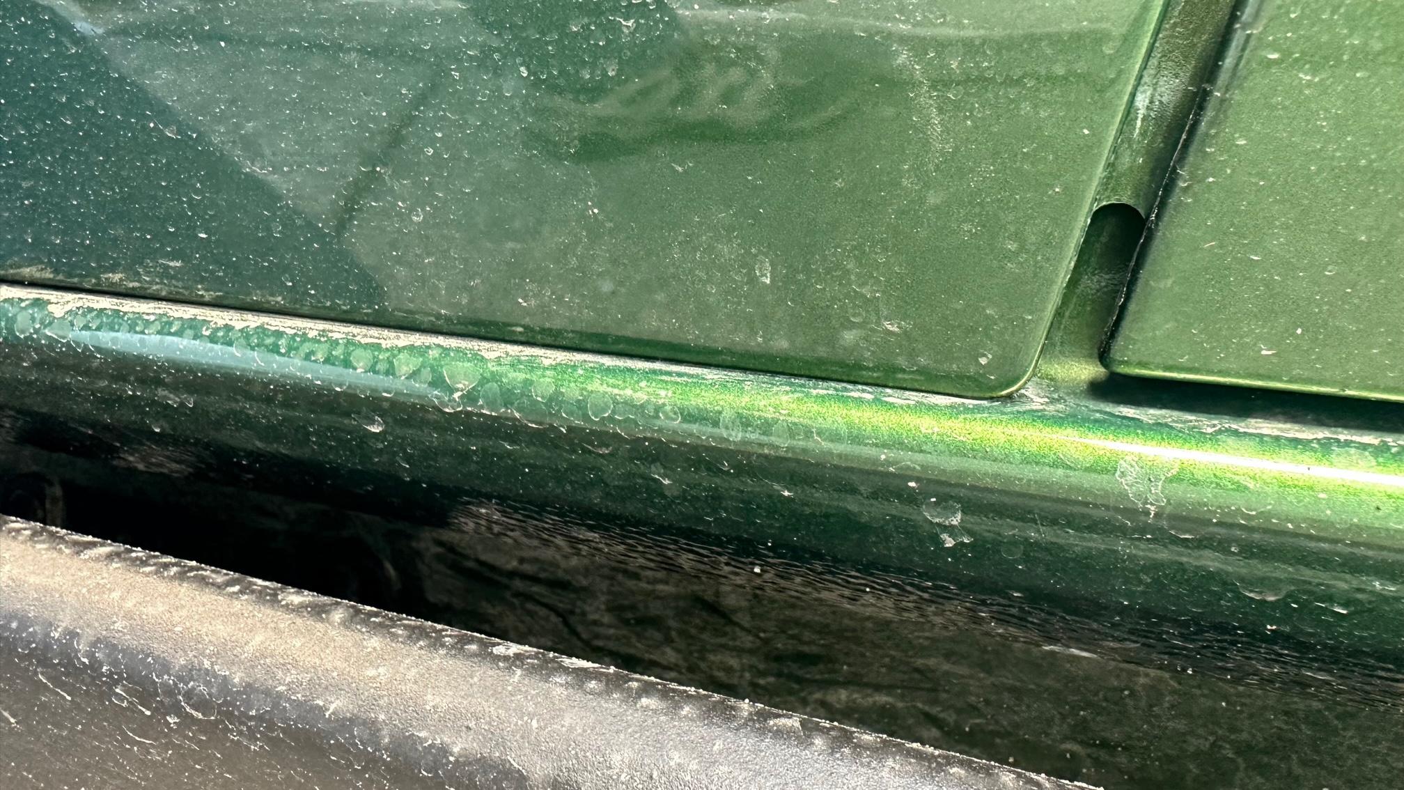

i just found out that i have the same issue on my drivers side door, the bottom of the door is rubbing against the rocker and paint scraped off. I added a rubber washer on the bottom hinge of the door and it helped a little. this is a short term solution. The bottom hinge looks like platic and tapered to easily accept the door.

My truck just was in for this. Warrantied work 100%. Doors adjusted and repainted everywhere there was contact. Your mileage may vary but itā€™s worth a shot bringing it to your dealer.
