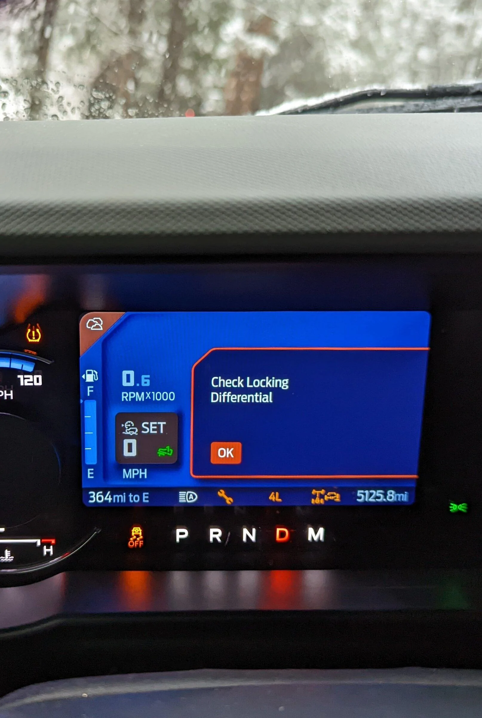

Long story long. A couple of us went out to Hackett Gulch (CO) last Sunday with a storm rolling in. It's a difficult trail on a good day and the snow wasn't helping. The lockers on my stock BL were getting a workout and 3/4 into the trail I received an alert to check my locking differential. (This was before getting to the river for anyone familiar). I gave the lockers a rest, the error went away after a few minutes and I completed the trail without issue. Love my Bronco.

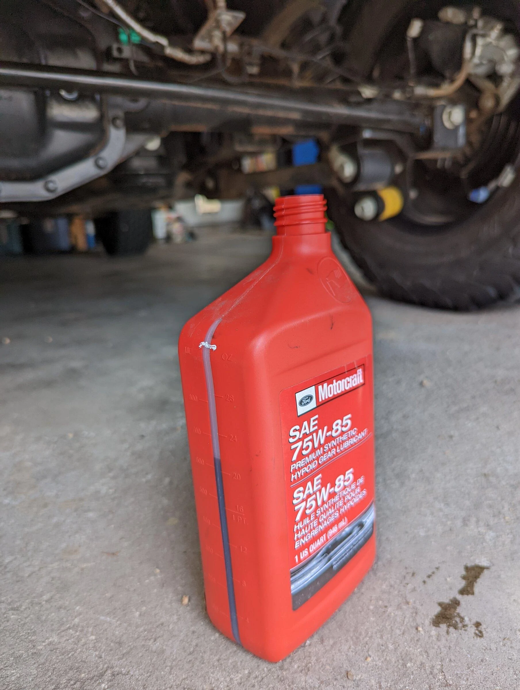

As a follow up, today I checked my rear diff fluid. To be honest I was more concerned about the water crossing than the warning light but I'm glad I did. When I removed the fill plug I wasn't met with any dripping gear oil. I stuck my finger in and was eventually able to retrieve some oil. Not milky, so that was good, but definitely low.
Buying a quart of gear oil wasn't as easy as I expected. Bronco Nation provides two spec fluids and capacities for the differentials but they don't reference front or rear. 1) 80W-90 Premium REAR Axle Lubricant and 2) 75W-85 Premium Synthetic Hypoid Gear Lube. Before consulting my owners manual I had assumed the rear axle lubricant went in the rear. Nope, I think it's counterintuitive and it's the hypoid that goes in the rear and the rear axle lube that goes up front. An unlucky draw at the dealership parts department didn't provide any answers(75W-140?!?) so I'm following the owners manual. Let me know if anyone knows better.

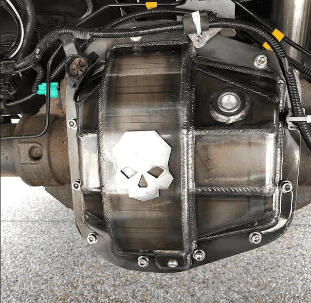

agreed. Ford does not have a drain plug on their diff cover so you have to completely remove the cover to drain it.
On my GEN1 and GEN2 Raptor I replaced the diff cover. Here's the cover on my GEN2
Ford Bronco Double check your rear diff factory fluid level. 1651084373621
I have never understood why this isn't standard. All of my Tacomas have had this ability. Makes maintenance so much easier.

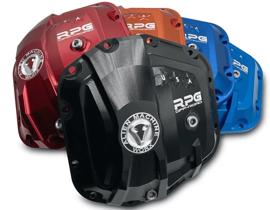

Does Banks sell a diff cover for the Bronco?
