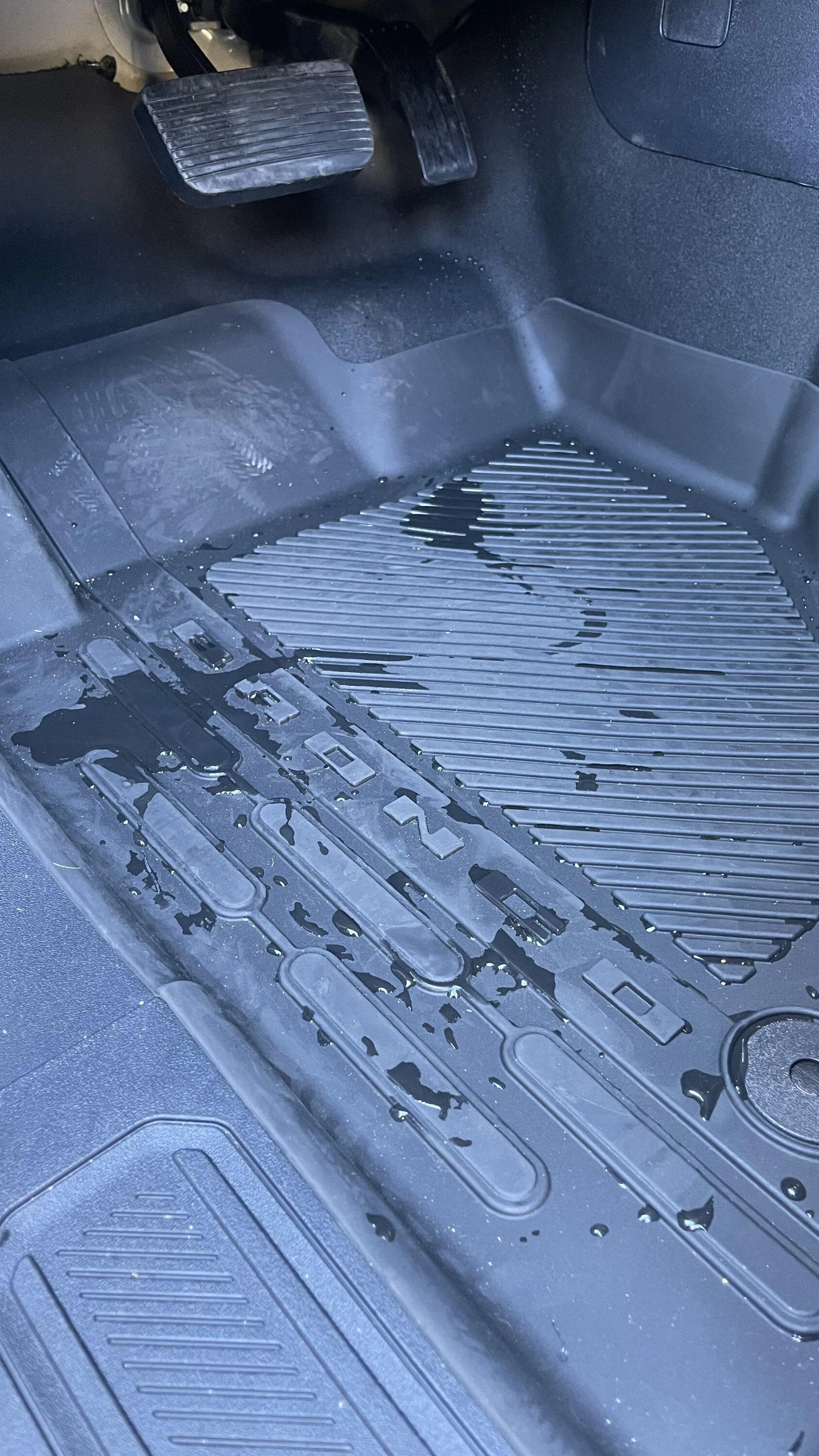

My Bronco has the same issue. See attached picture. How do I private message you?

Click on Ford's user name, and click the "Ignore" button and just go visit a dealership to setup an appointment. That's literally all they're going to do anyways... It'll be much quicker for you to remove the middle-person.
I'm sure the dealership will be able to piece together the issue once you explained it happened on a longer trip. There's likely something that runs above or near the peddle that's causing it, so I'd guess that's where they'll start looking.
