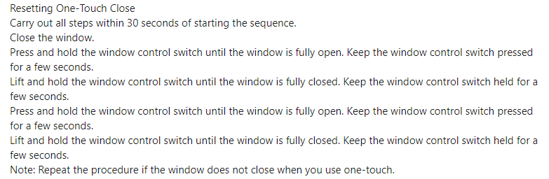

I have not - but next time, do the window reset routine to tell the vehicle where the upper and lower limits of travel are. I had to do this after having my Ranger interior door panel swapped. Very erratic behavior until I reset it.
Ford Bronco Driver's Side Rear Window Auto Open Intermittent Failure 1635957753809
I had this issue as well. It happened when I put the doors back on. I essentially did something similar to this to fix it. It's really a software bug and you have to reset the "default / current" position. The software doesn't know what "state" the window / door is in.
Thank you for this! I'm experiencing this problem now in my '22. Going to follow the steps & hope it works!

I tried it & it worked. Took a screenshot of the directions because something tells me it may not be the last time this happens. Thanks all!

Just an FYI, the instructions posted here are incorrect. Here is a Youtube video that cures this issue
Oh! I guess I got lucky or maybe it's something completely different. Thanks, will add the video to my library.

Just had this issue with the drivers side rear. The video worked! Saved me a trip to the dealer. Thank you!!
