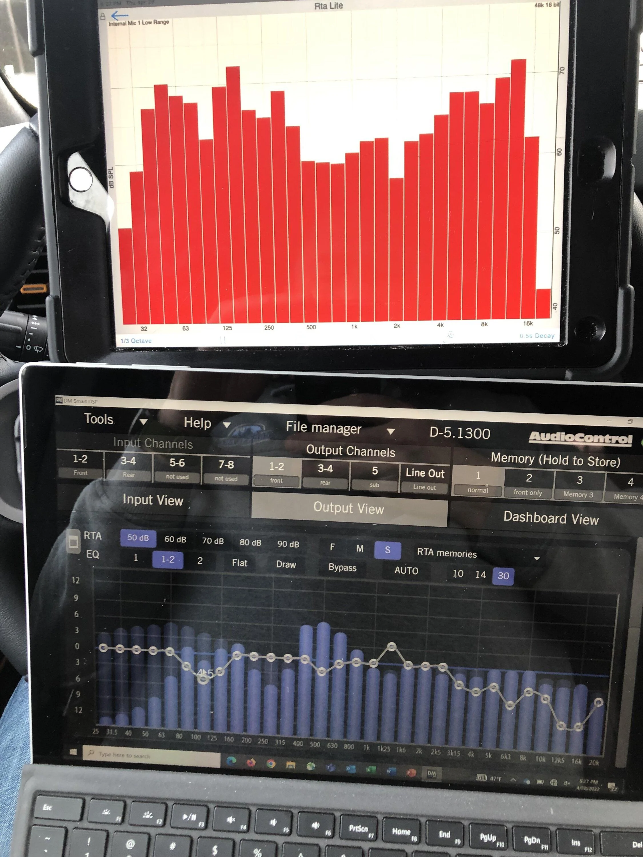

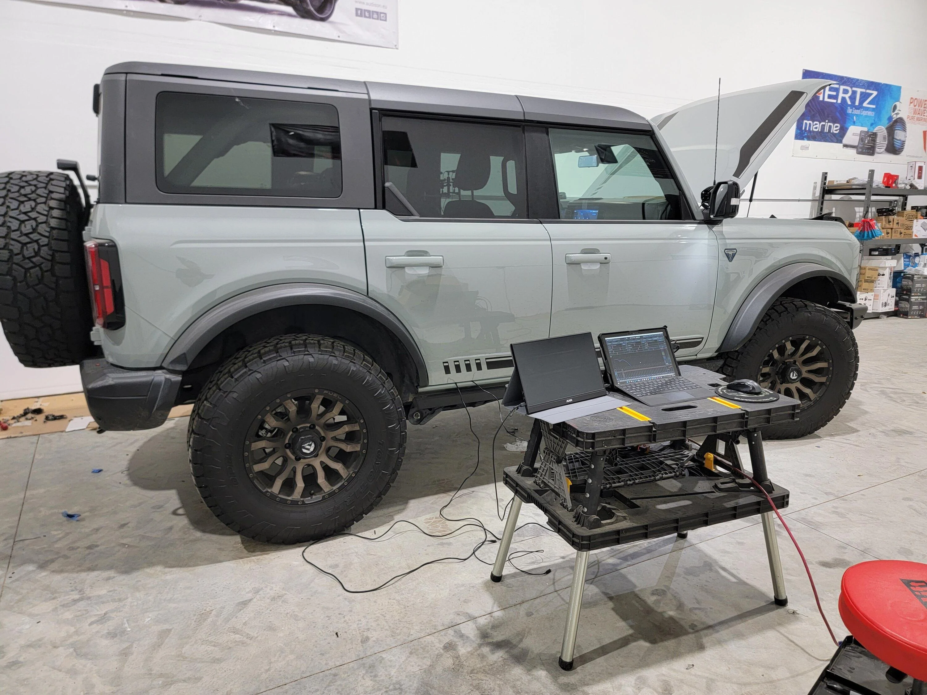

You shouldn't be sitting in the vehicle during a full rta session unless you're trying to verify left/right pull or level matching in the final touches.
You and your laptop should be outside.
This may be a dumb question, but... How do you connect the laptop audio to the car speakers??? I just bought an Umik-1 mic and set it up with REW, and want to measure the EQ of the existing system before I upgrade. But I cannot figure out how to get the laptop to connect to the car speakers. The USB connection didn't do it. There's no aux-in. Bluetooth might work, but it's compressed and delayed, so probably not great for audio analysis.
mono pink noise on usb stick. No need to connect laptop to Bronco.

ok! I've got my MoBridge installed, REW and an Umik-1 all set up. I measured and set the delays, leveled SPL on each speaker, and set appropriate crossover frequencies for my setup. Now I'm doing RTA measurements. Sanity check: Is the tuning process really just measure, look at the curve and see peaks and valleys in REW RTA window, then in the MoBridge software manually drag the EQ points up or down, remeasure, and iterate until it's kind of close to the desired curve? It feels like something software should automatically be able to do, creating a correction curve.

You’re on the right track.

you are in the right track but can be a little more challenging in the Bronco. Based off hours of tuning the main areas that will need addressing are the high frequencies, lower Midbass and upper subwoofer. You will need to significantly drop the upper treble. The frequencies are reflecting off the glass causing them to come in “hot”. The 6.5’s in the front are probably struggling to play down past 100 hz and you also probably have a big spike around 250hz. There simply isn’t enough airspace for the speakers to thrive here. Cut 200-250 here. Use the subwoofer to cover the 80hz region. Also what crossover points are you using?
