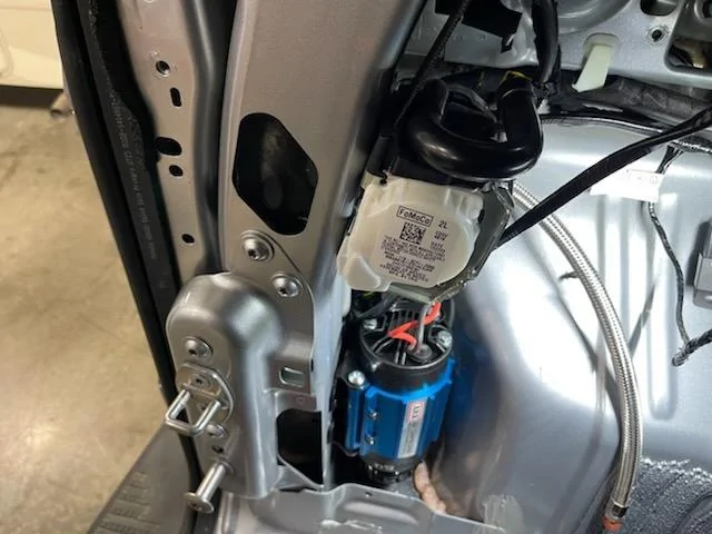

I am looking for a place in the engine or maybe in rear cargo area (where sub woofer would be) for a Dual Compressor installed
I have a Everglade so the snorkel is where the normal engine mount would be
I have seen this for a single and seen where a single would fit in cargo cubby in back. But would like to do a dual if possible

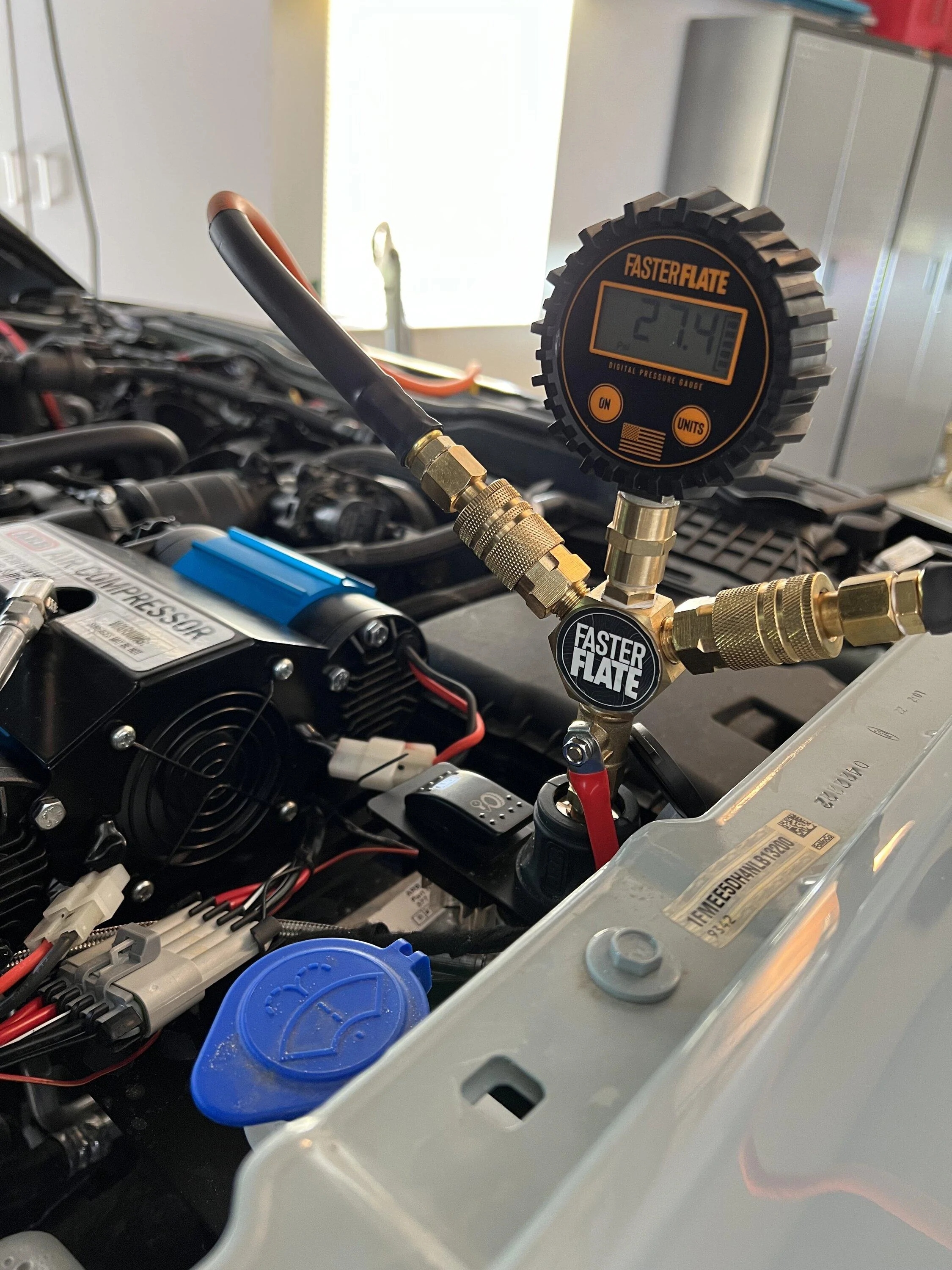

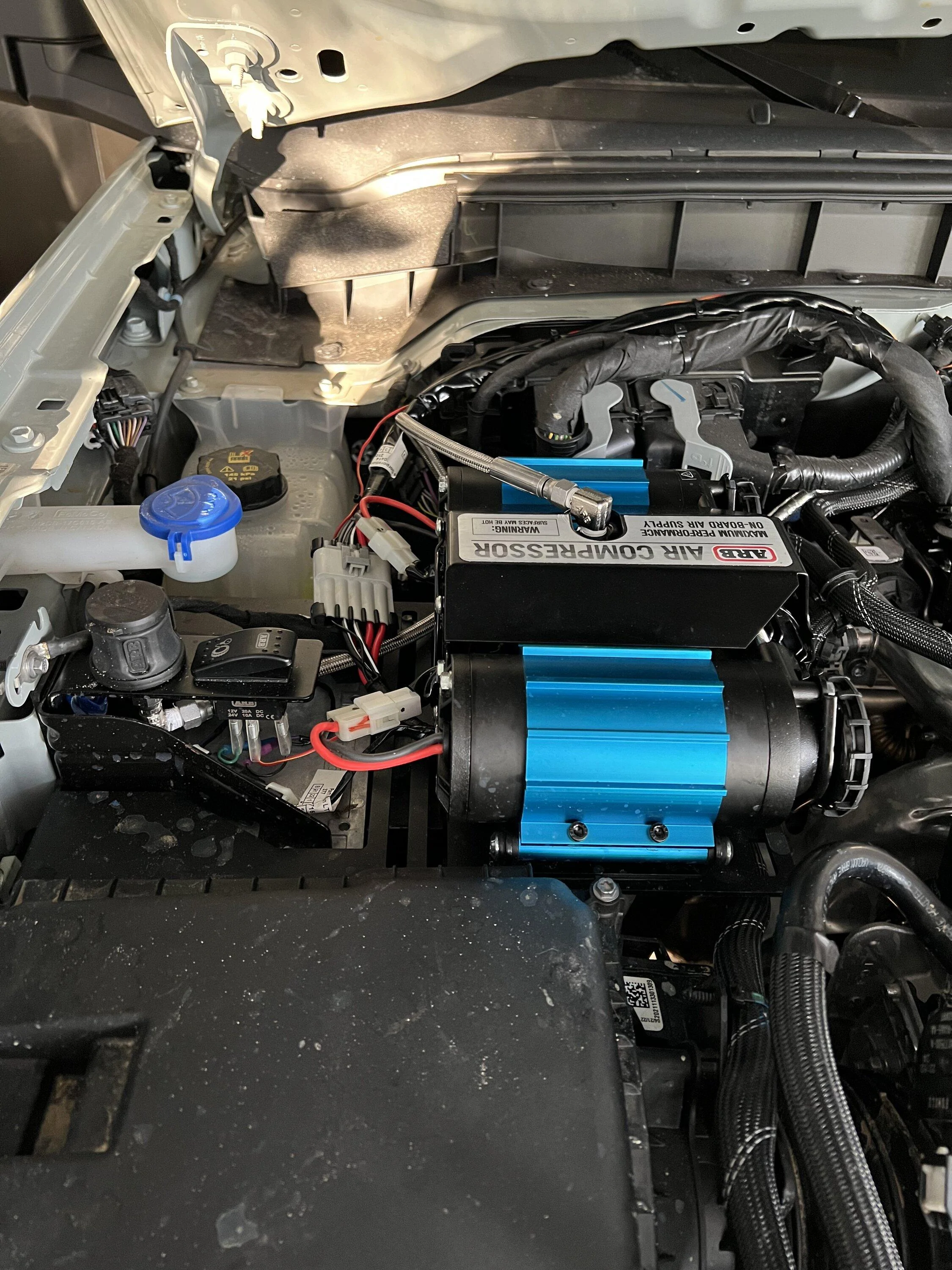

There's only so many places to install one. I used the KR Off-Road brackets from 4x4 LED's. Below is my setup. I wanted the on/off switch next to compressor.

Thanks - I ideally would like that install, but I think on mine the exhaust is in the way
Yup, each trim and engine seems to be a bit different. I have the 4 cylinder badlands. Would love to be able to move winch controller to engine compartment, but no room. :-(
The only words of wisdom I can offer is to think thru how you’ll use the compressor, location of on/off switch and what you plan to connect to it.
Good luck.
Ford Bronco Dual Compressor Install Location "Options" ? IMG_0916
I like it! I'll probably end up doing the same... Thx!
