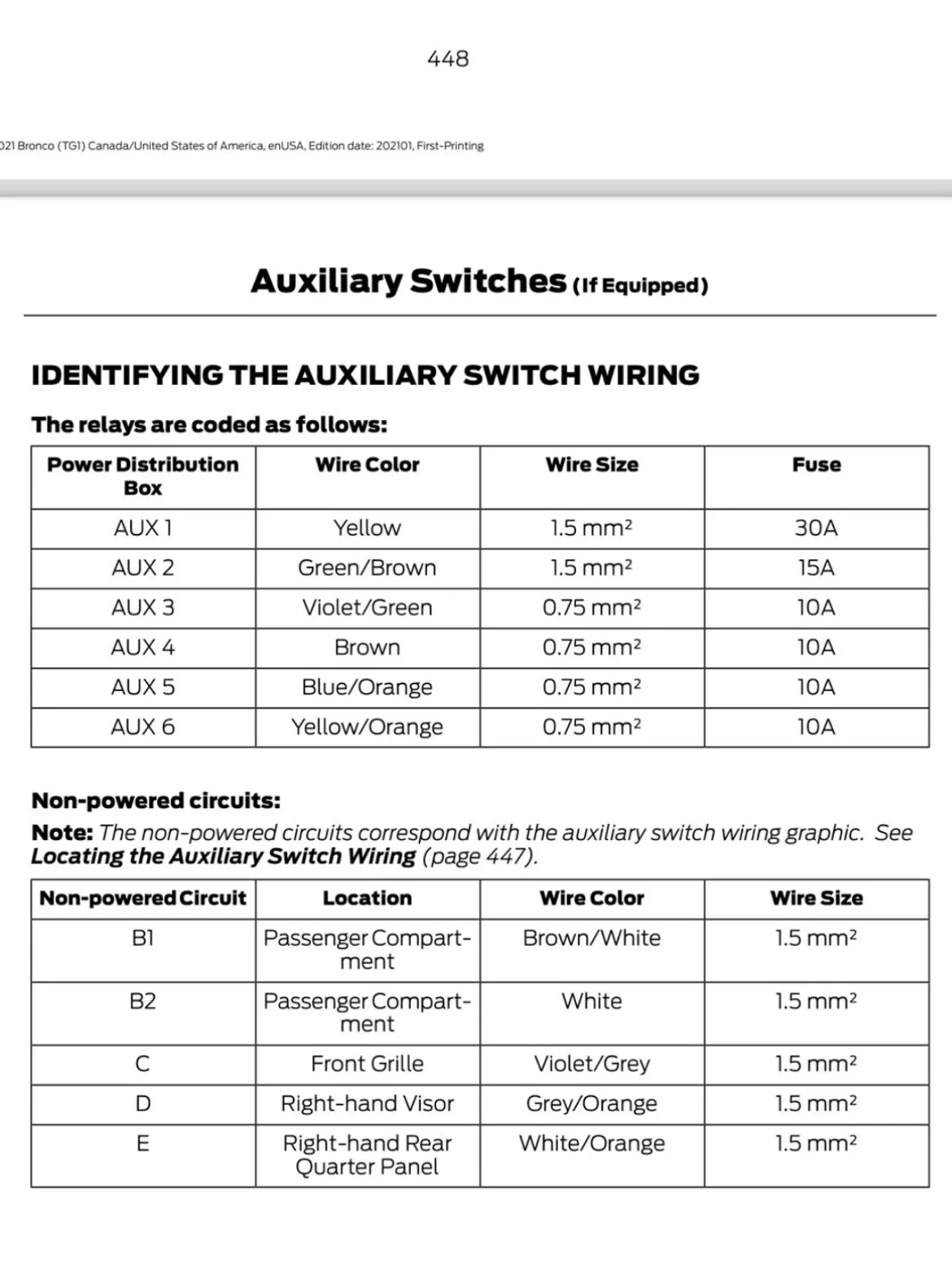

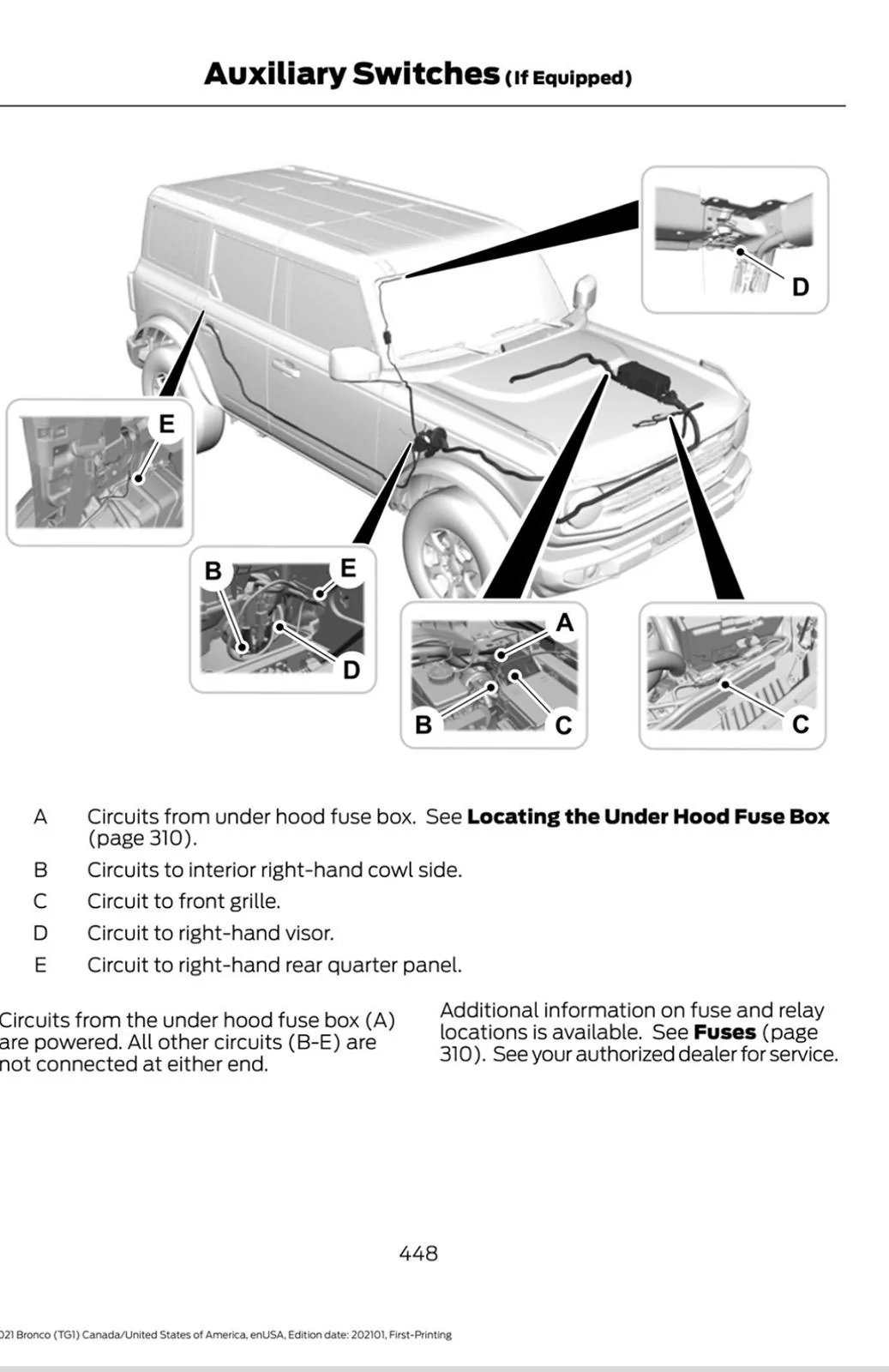

Aux beams. I have them. Hook it up to the battery and use a tester to see what color wires do what from the switch. The red wire to the switch is hot. Cut it off and tape off. Cut the switch off and Hook the other two wires to whatever aux wires at the cowel you want to use.
Does this help?

Ford Bronco Dumb electrical question, aux switches. IMG_0551
Ford Bronco Dumb electrical question, aux switches. IMG_0550
