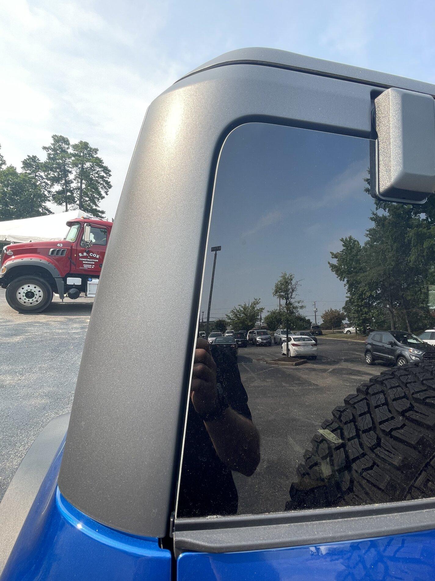

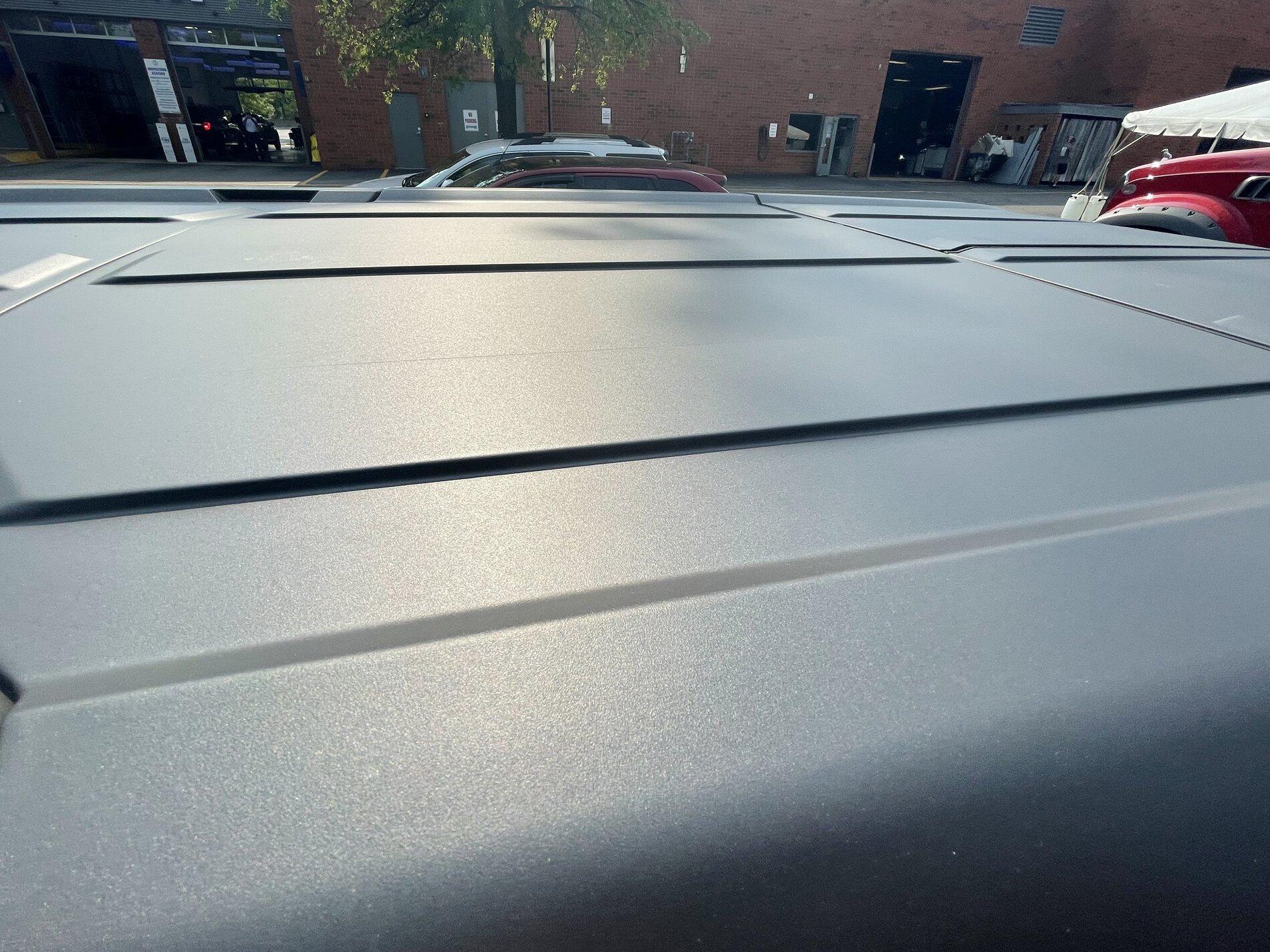

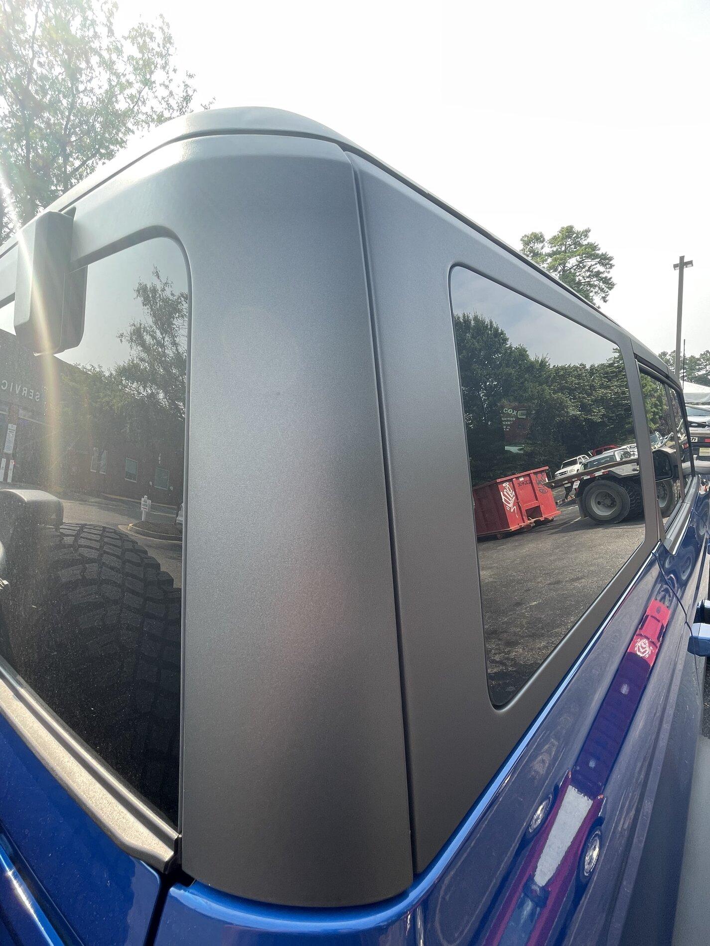

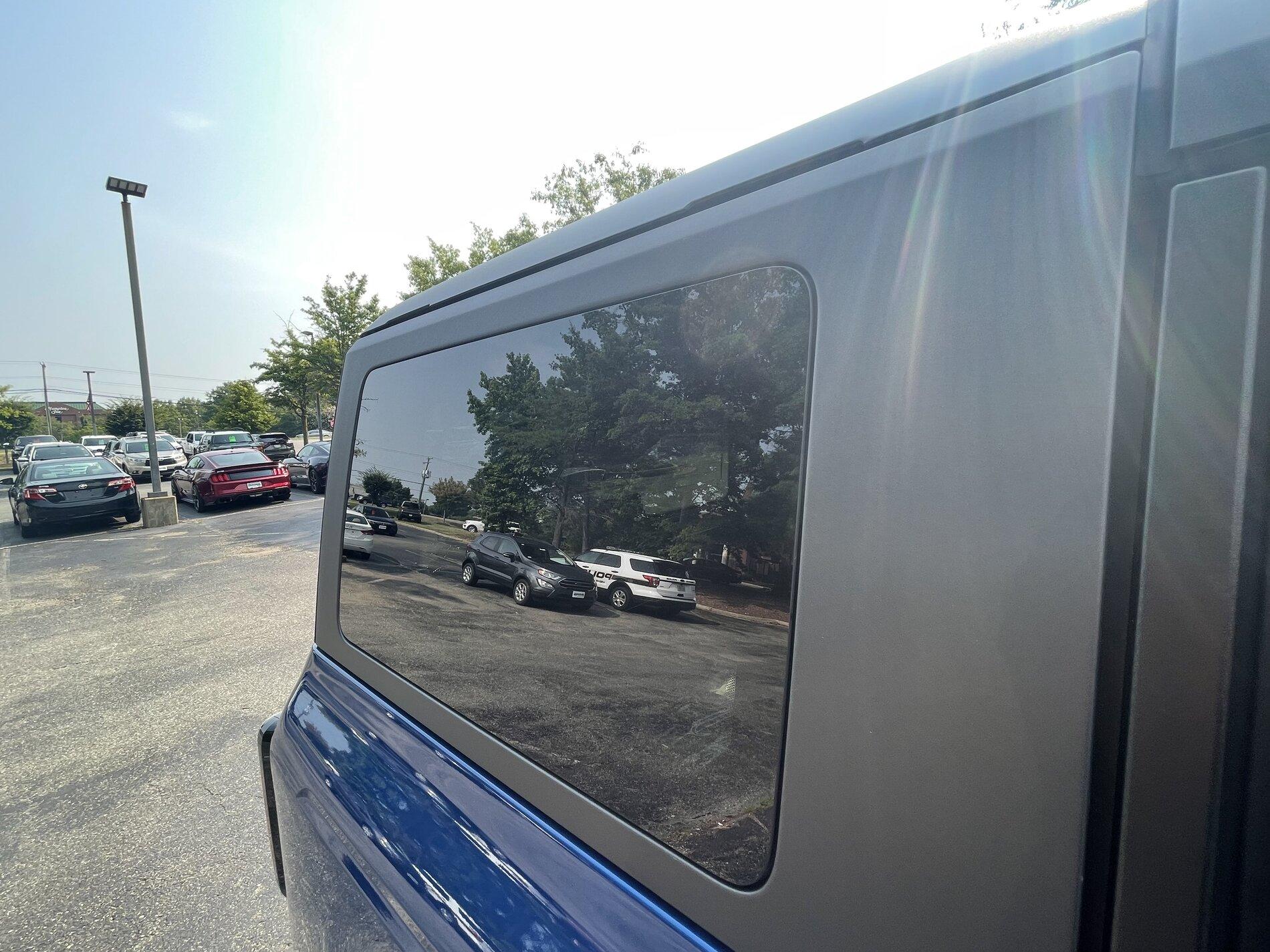

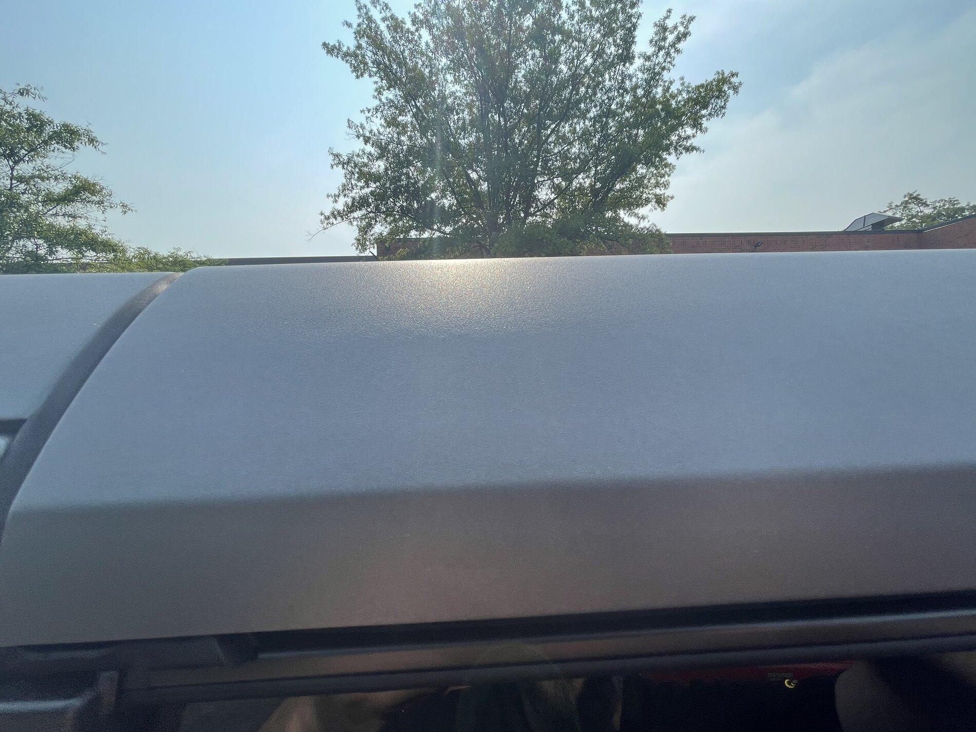

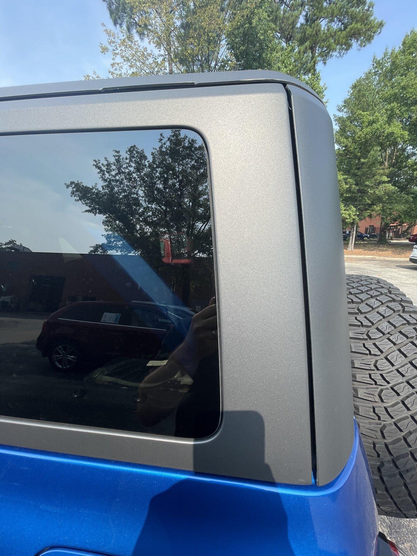

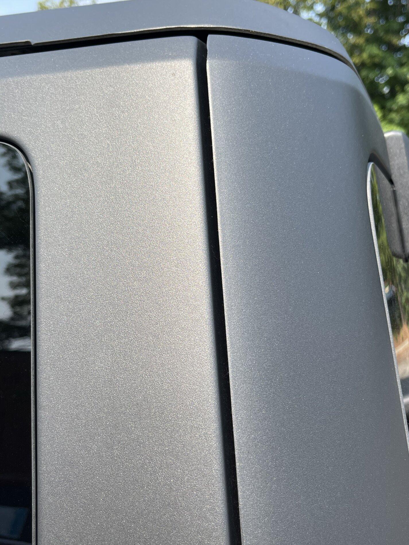

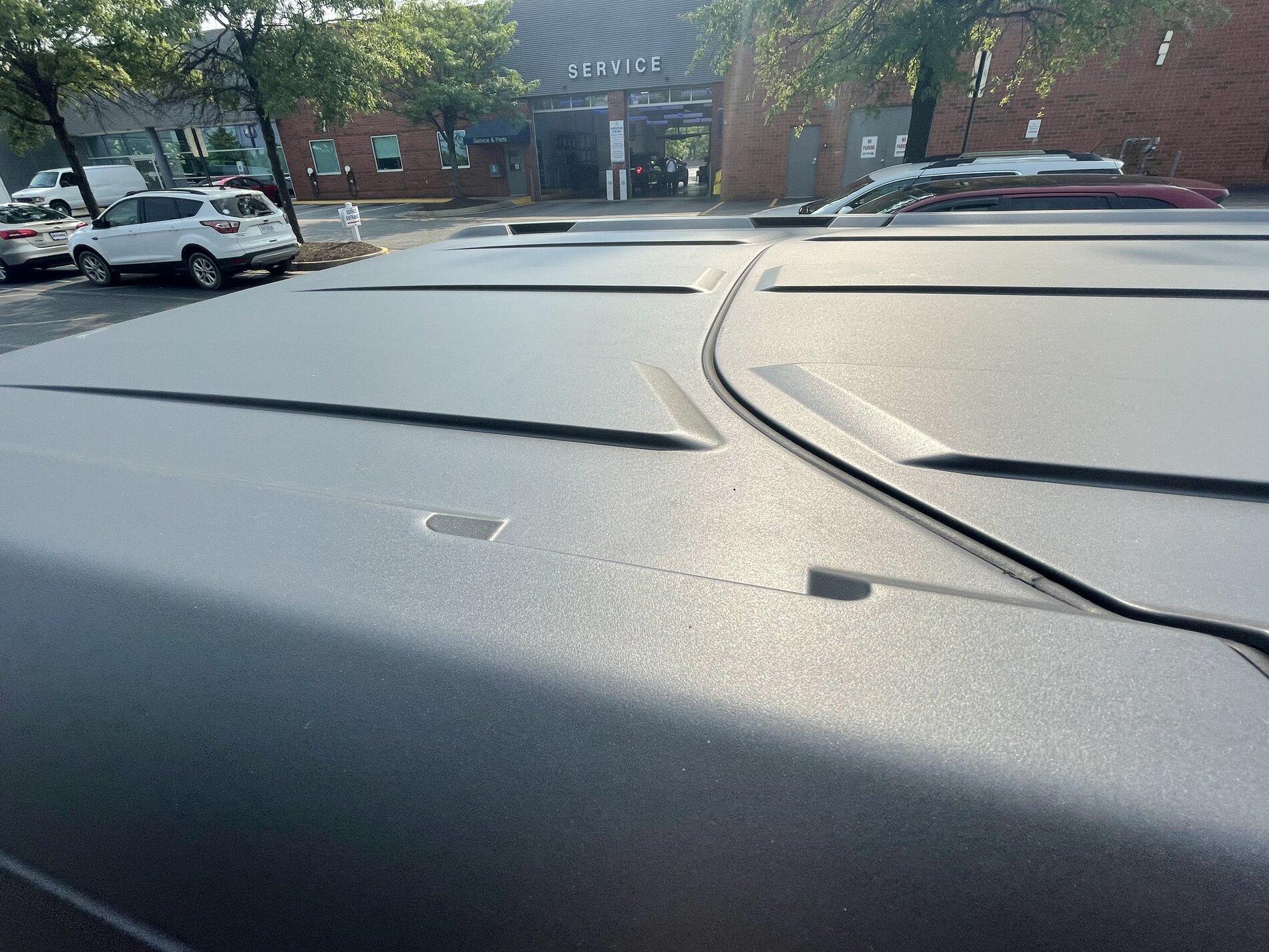

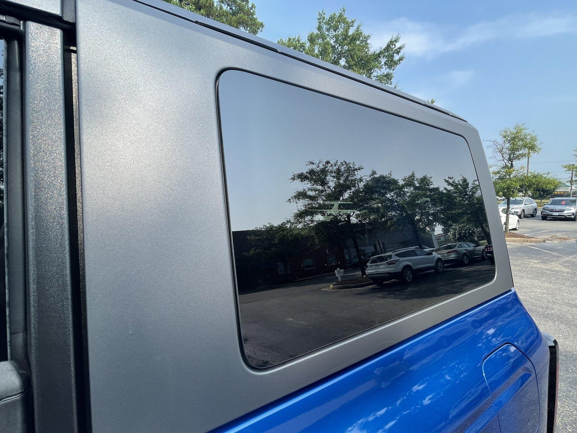

On another note here are some pics of a MIC top on a First Edition that just pulled up moments ago.
I was never a fan of MIC, but this one looks ok to me. It definitely has a texture, but nothing near what the OP’s photos look like. Have a good day everyone. I hope you enjoy your Bronco’s when the arrive. I’m still very much looking forward to mine.

It that a 2 door? Can't really tell.

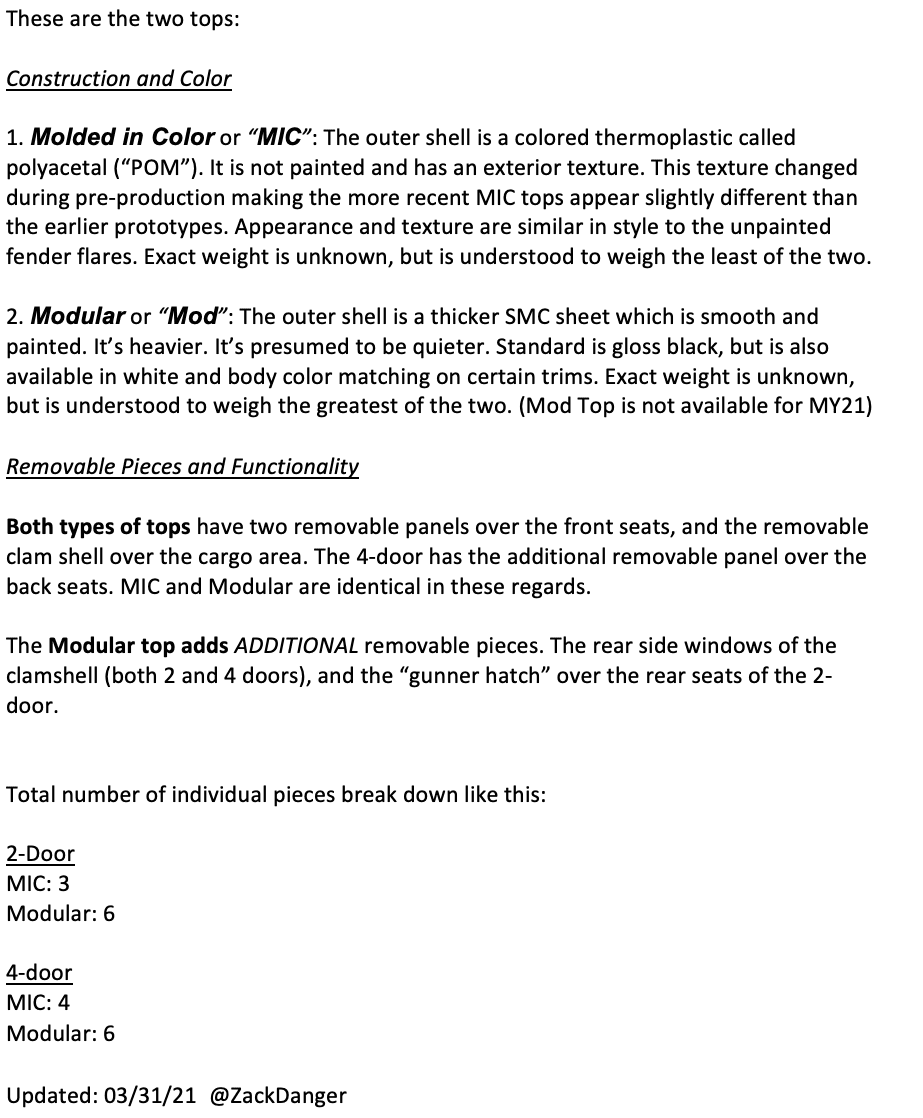

AFAIK SMC is the process that will be used to make the MOD tops, Not the MIC tops
Here is the info I've been able to gather over the past year about the construction. I don't know enough about these materials to know what any of the words mean.
POM for the MIC, SMC for the MOD
