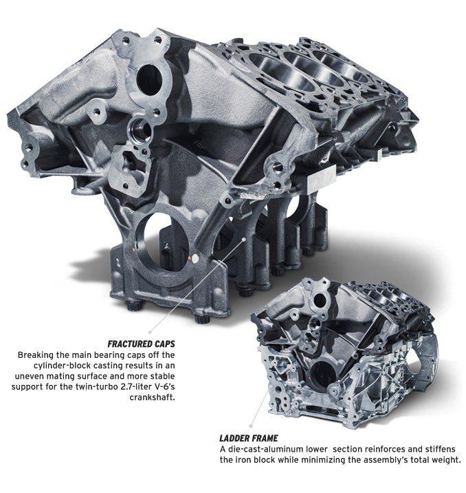

CGI in the block and aluminium in the head
Ford Bronco EcoBoost 3.0 V6 Nano leavetheironon-inline2-photo-587199-s-original
This is for the 2.7 nano, but I believe the 3.0 nano is the same construction. I think they also have (or had) another 3.0 ecoboost that was all aluminum. A smaller displacement version of the larger ecoboost V6s which are all aluminum. edit: I was thinking of the 3.0 duratec
