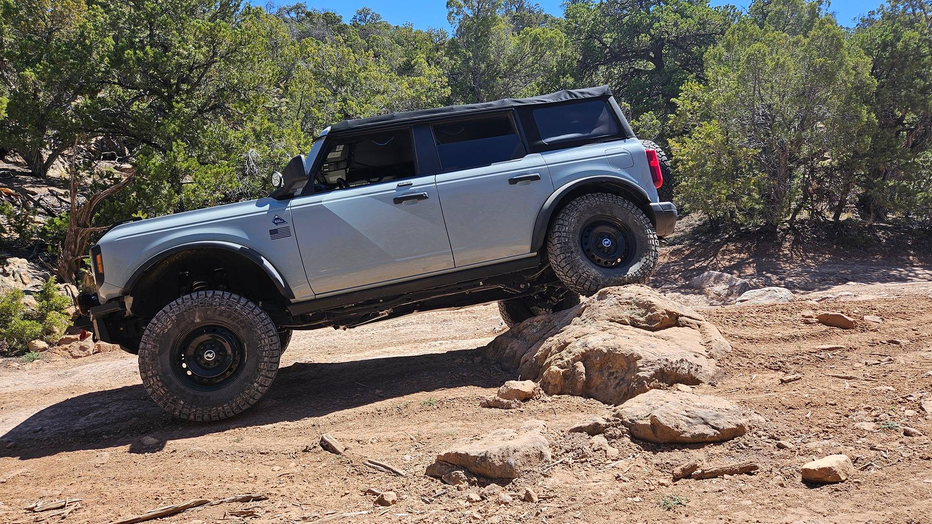

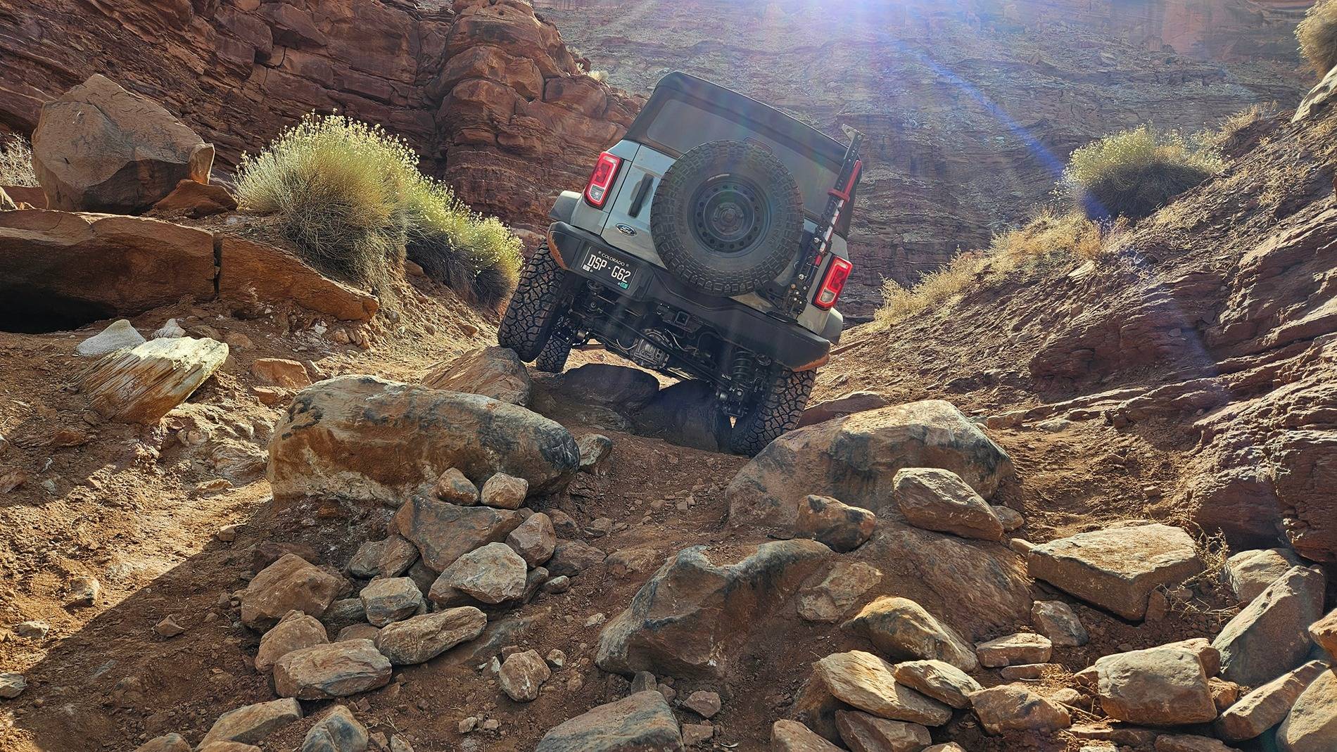

I know it's late to the party but I got the Eibach's and no sway bars installed and it drives great to me on the street. I don't do high speed desert, just rock crawling and slow trails.
