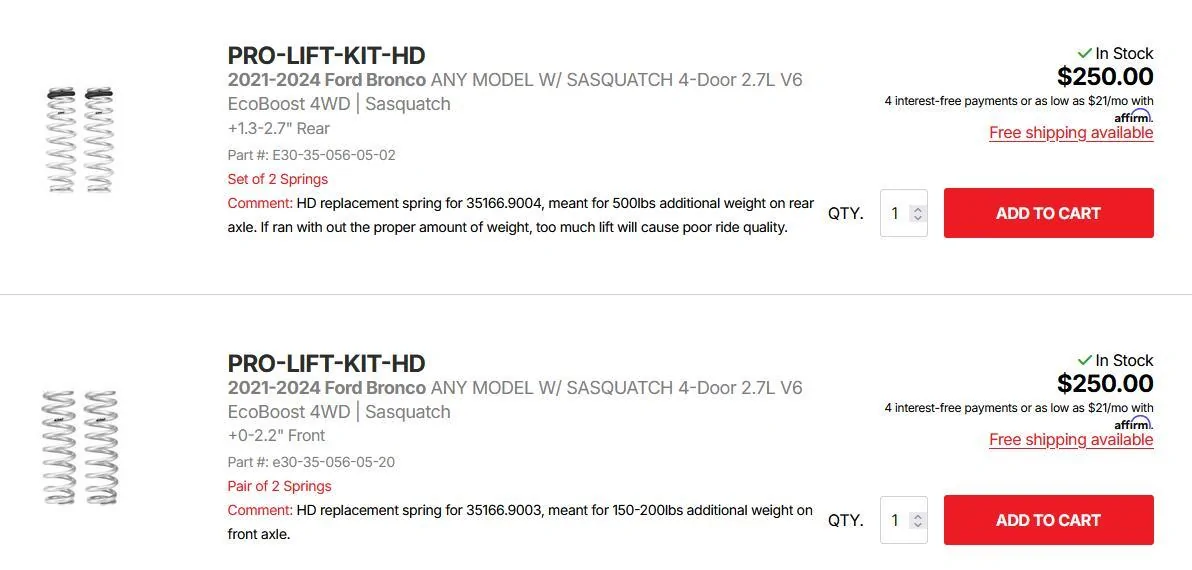

Eibach has FINALLY released the heavy duty springs for the PRO-TRUCK COILOVER 2.0 for the Bronco.
Ford Bronco Eibach has FINALLY released heavy duty springs for the PRO-TRUCK COILOVER 2.0 for the Bronco Eibach HD Springs
I have a 2022 Bronco Badlands SASQ 4 Dr with Rockhard 4x4 swing gate rear bumper with gas can mounts (about 225-250lbs over stock bumper), a diabolical rear cargo enclosure (50 lbs), Rockslide Engineering power steps (around 100 lbs), a BAMF front bumper with winch (150+ lbs over stock), plus at at least 100+ lbs in rear cargo for frig, tools, gas cans and recovery gear.
With all this added weight I lost about 2 inches in the rear with the factory SASQ Bilstein shocks and about 1 in in front. I opted to go with Eibach's PRO-TRUCK COILOVER 2.0 which, in theory, are adjustable from 0.00 to 2.75" of lift for factory weight. I went with them to basically get my stock ride height back and ended up with somewhere between 0.5 and 0.75" rear lift with the Eibach set near max ride height and the fronts are at about the middle of the adjustment range to level out the Bronco.
I have a set of the front and rear HD springs now on order with an estimated delivery around 9/6. I am hoping these will be enough spring to move up to 37s on the factory wheels. I will report back once I get them installed.

Is there a rating (lbs compression / inch) of the standard eibach springs and these?
