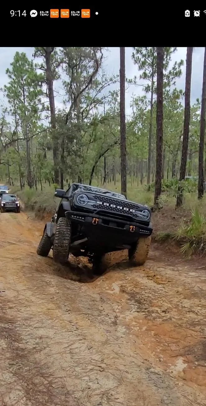

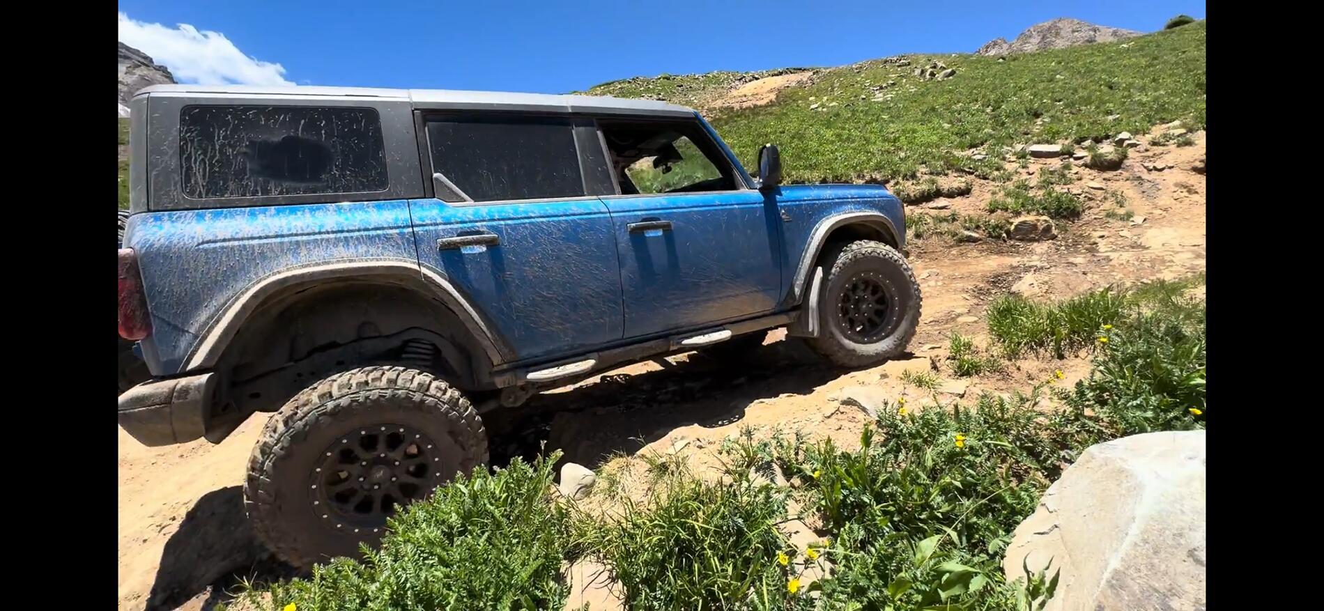

Finally had a chance to articulate them out on the trail. vids attached. Really like them so far. Non Sasquatch BD. No sway bar.
Ford Bronco Eibach Pro Truck Coilover 2.0 -- articulation videos IMG_1120
Ford Bronco Eibach Pro Truck Coilover 2.0 -- articulation videos IMG_1113

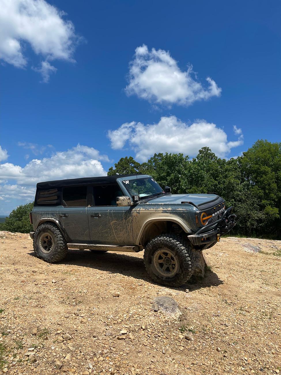

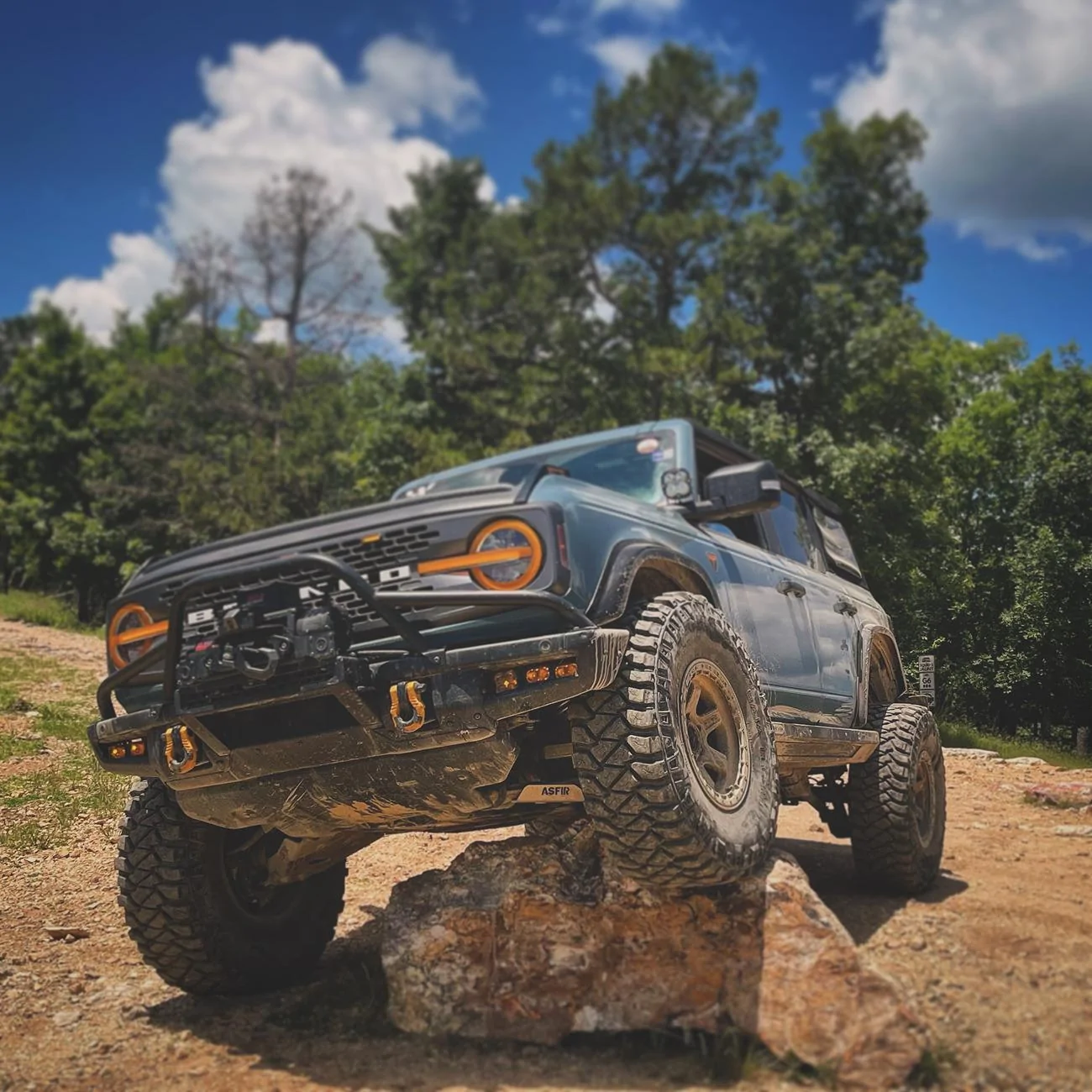

Almost twins
Ford Bronco Eibach Pro Truck Coilover 2.0 -- articulation videos 57F737BE-A96B-4AEF-9973-0D00FFB2A64C.JPEG
Ford Bronco Eibach Pro Truck Coilover 2.0 -- articulation videos IMG_3694.JPEG
