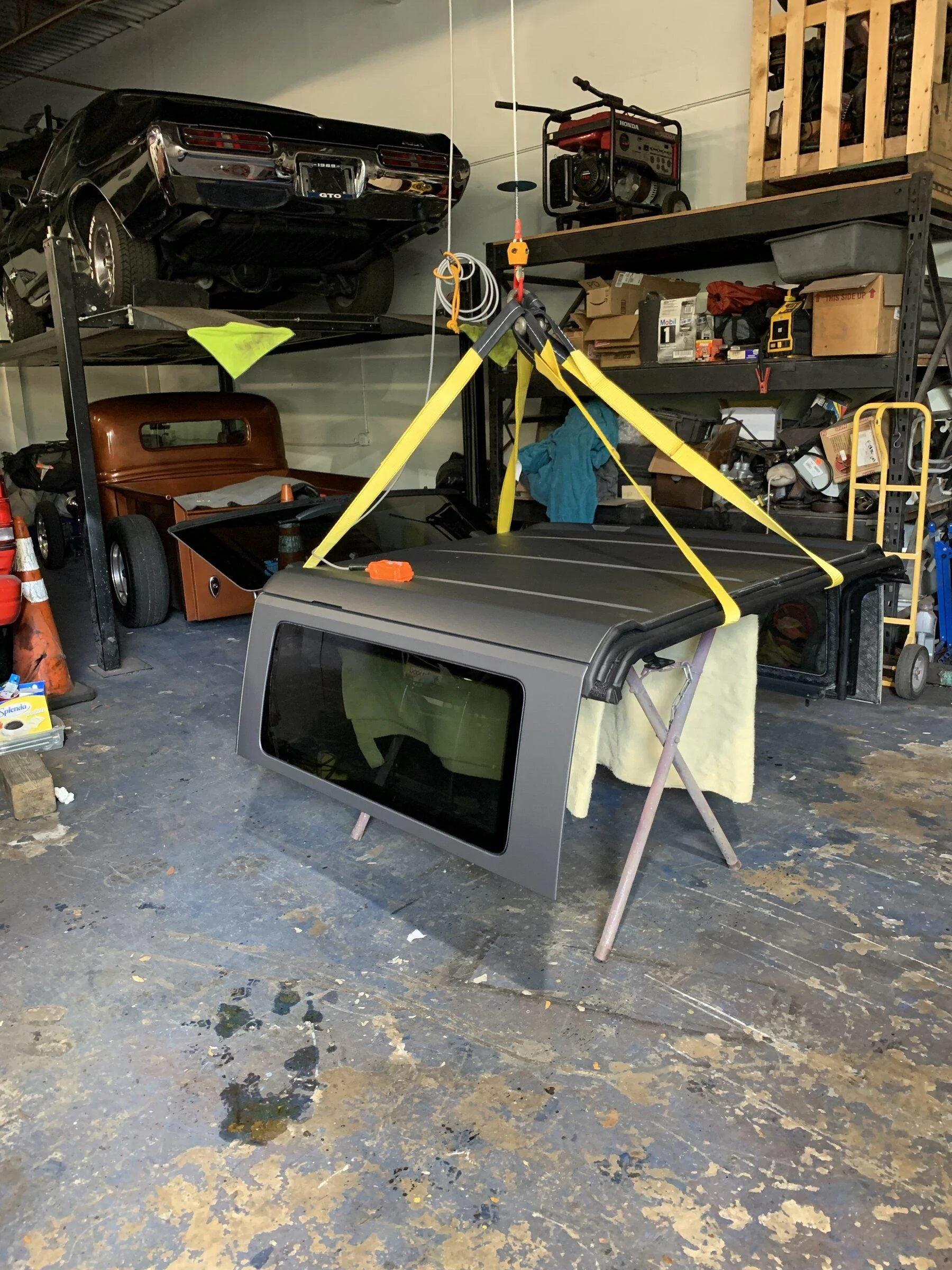

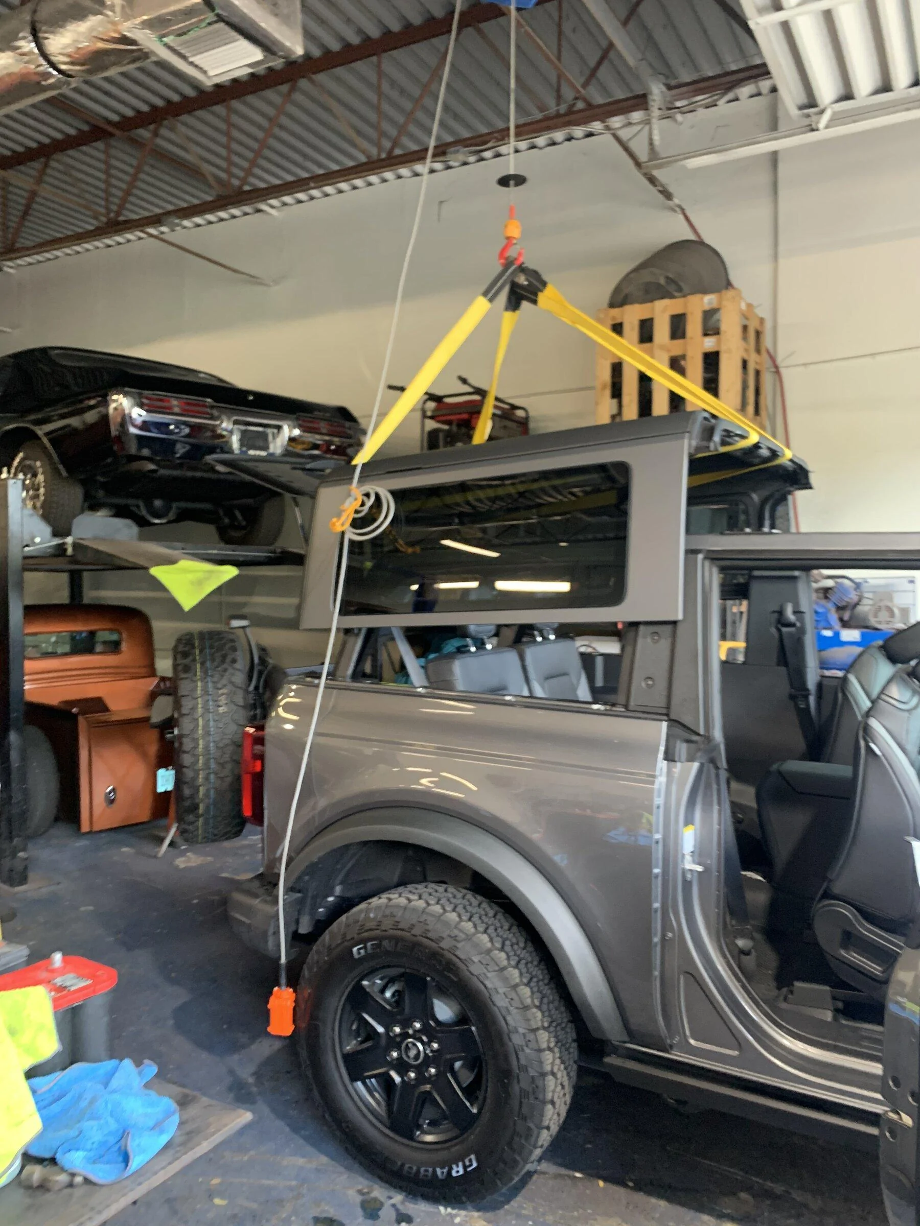

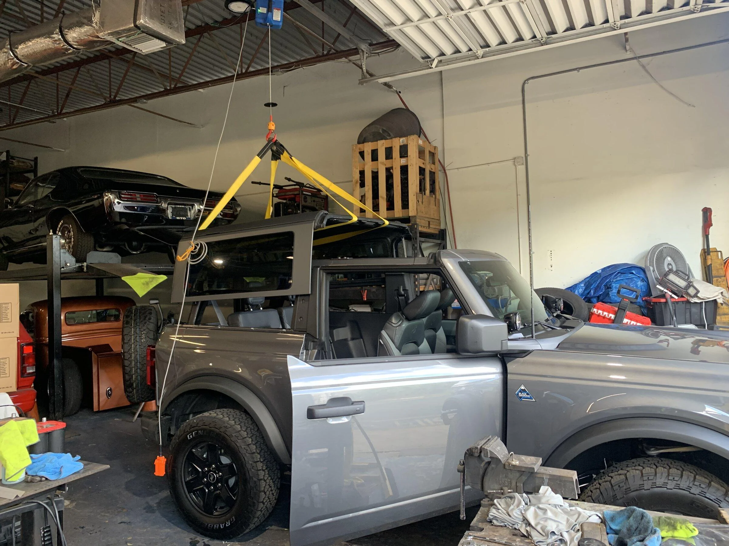

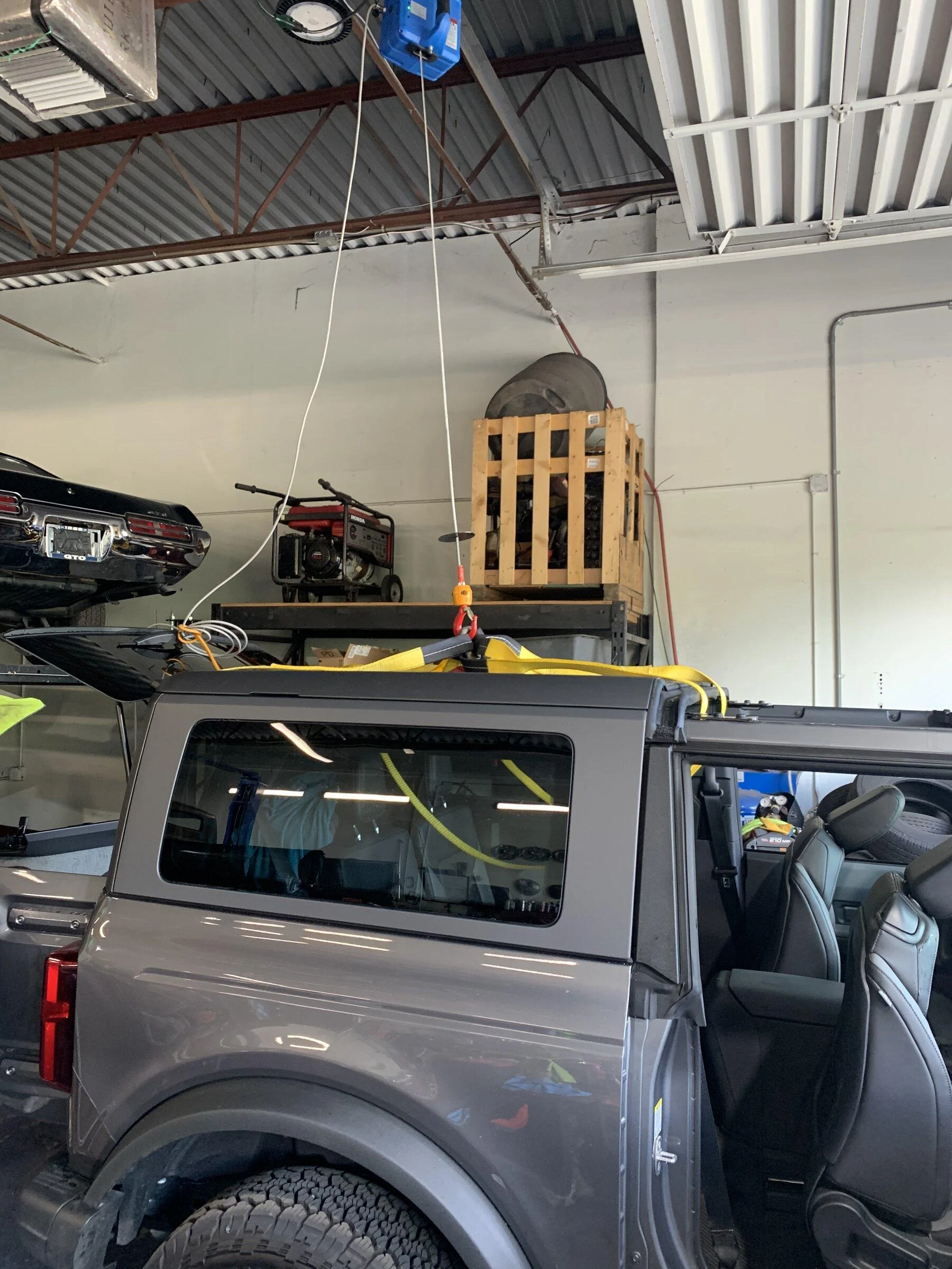

I used 2 12 foot x2 inch flat lifting straps with loops on end attached to my hoist
