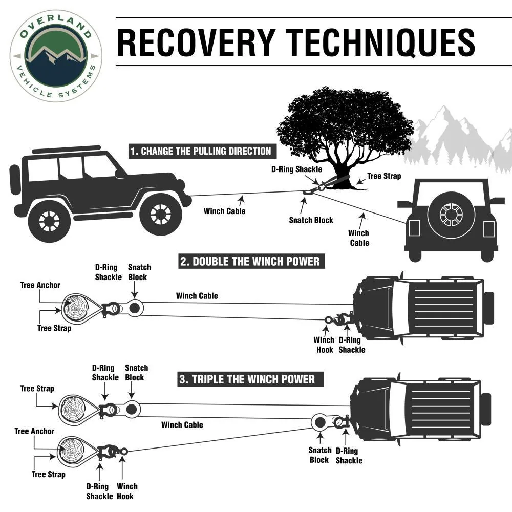

Depends on how stuck you are, and how good you are at pulley math. :wink:
Obviously your OuterBanks weighs more than your winch is rated for, but you can over come that with more line and doubling back and forth with snatch blocks .. it's just physics. It will take more time, but assuming the circumstances allows you to set it up properly, in theory you should be fine.
