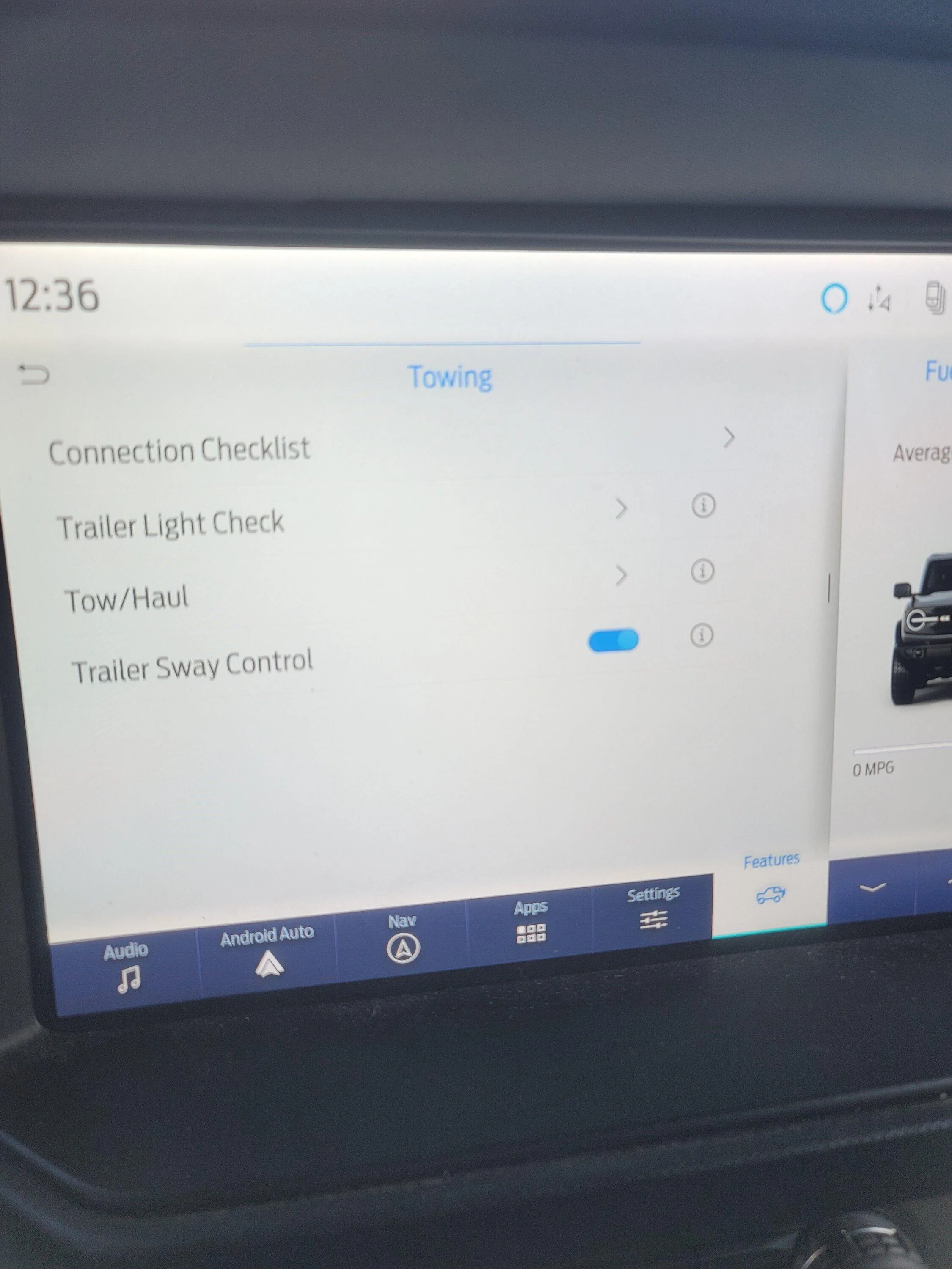

Yeah I have a spot that says trailer sway control that is on but this is for like the selectable modes except it automatically does it when trailer is plugged in. I tried getting it in the goat modes but it didn't turn on and made the modes glitch.
Mine has the towing package from factory and these are the only options I get.

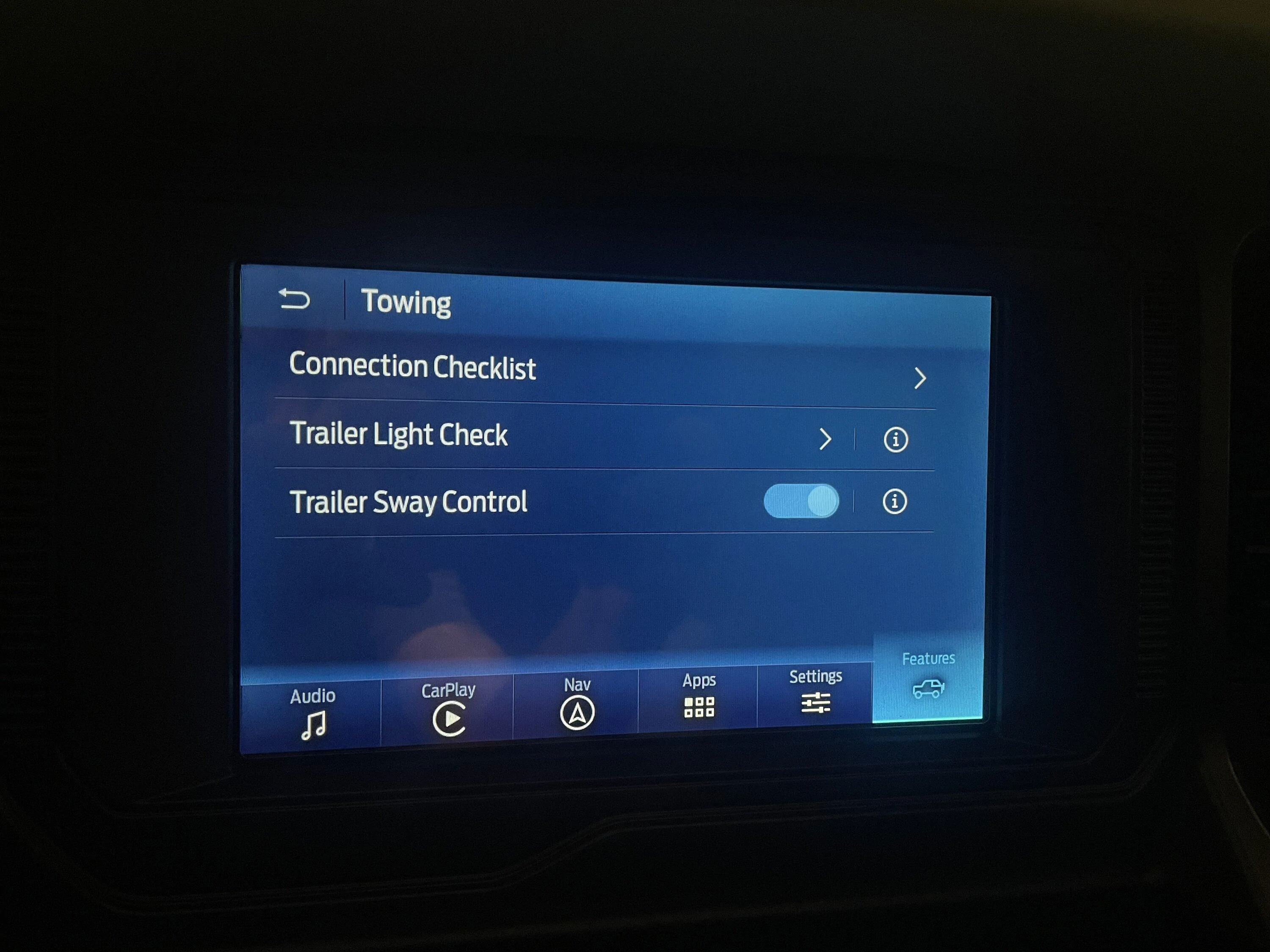

Oh I'm missing that Trailer Light Check from my retrofit. Wasn't aware that existed. I'll have to look into getting that coded so mine will be 100%
I don't remember where at but it is in the easy modes.

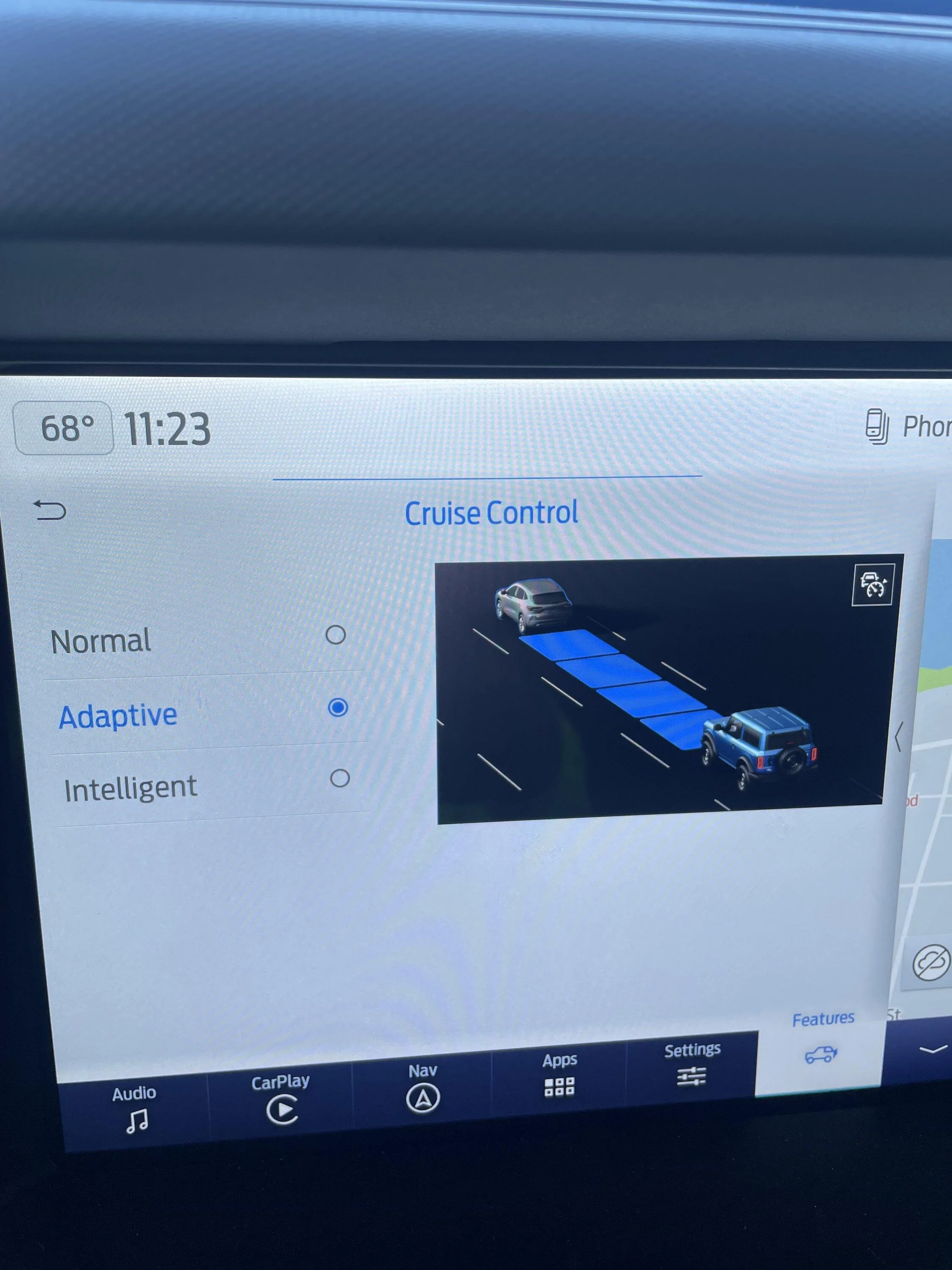

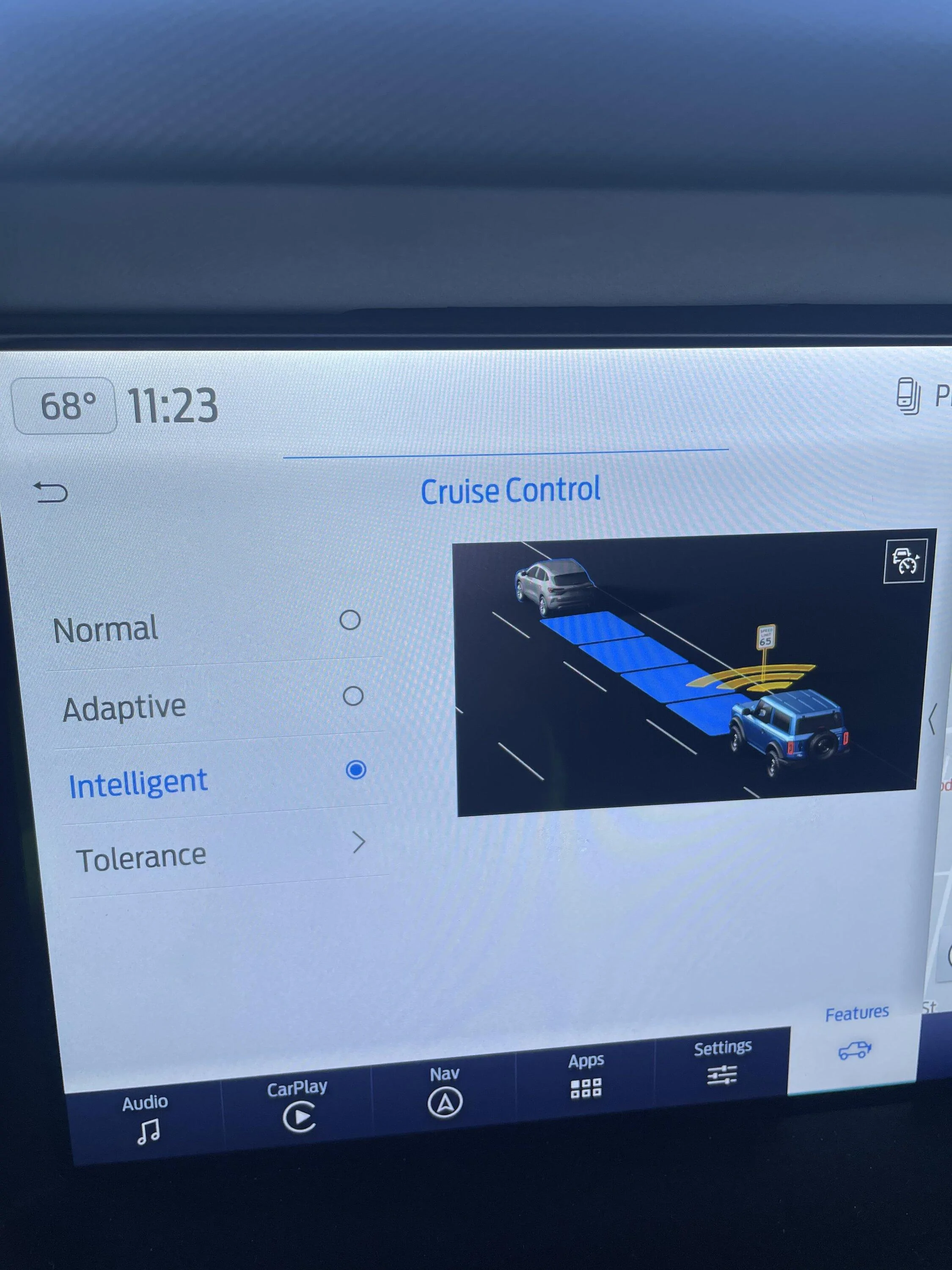

A few things to note, see attached photos for reference:
1. Speed limit sign reader still doesn’t work when in the “intelligent cruise mode”.

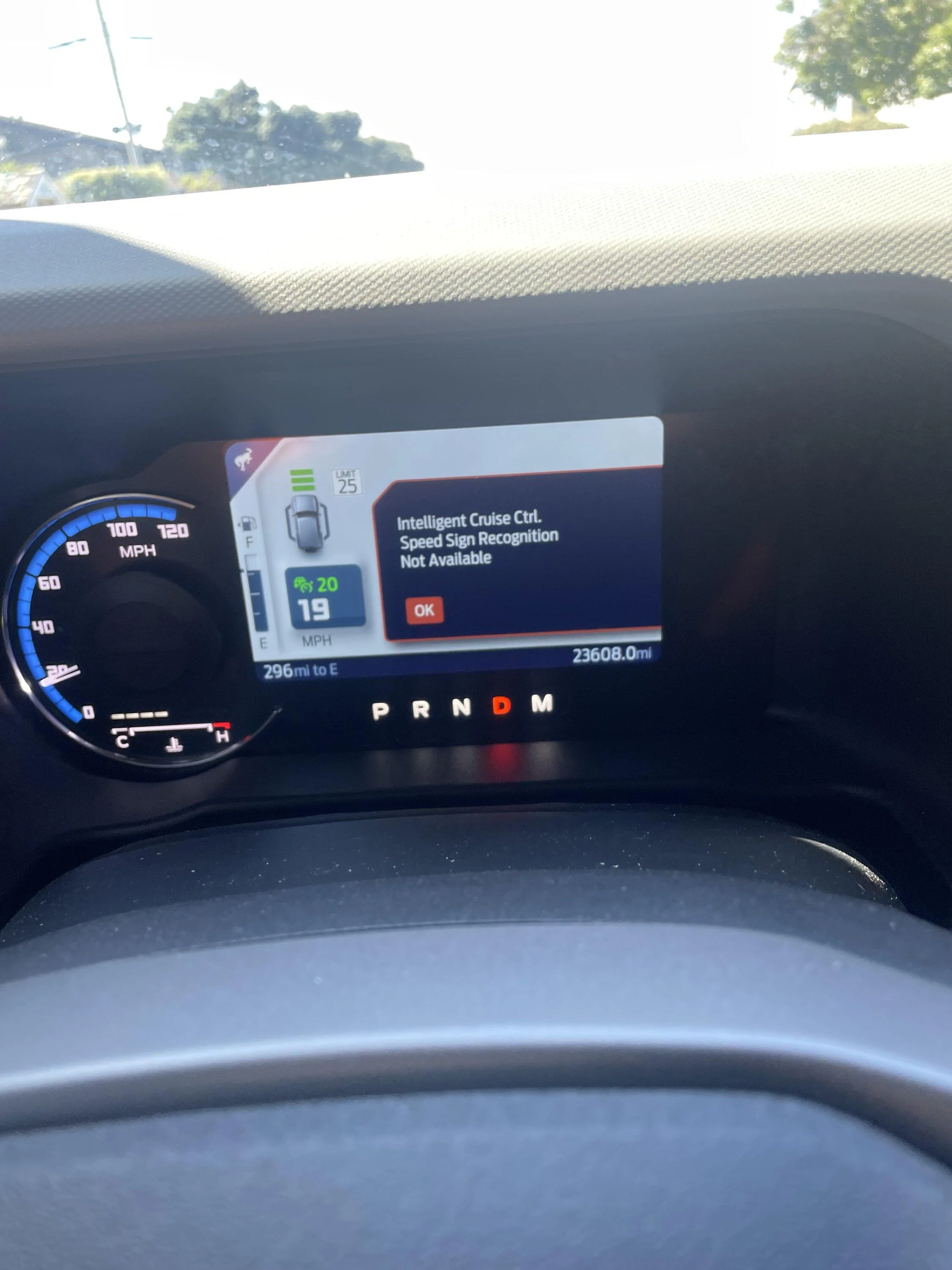

2. IPC displays this message when intelligent is selected and you turn on cruise at steering wheel button. The message only comes up once and goes away so it really isn’t that annoying.

3. Stop and go works in both adaptive or intelligent mode. So until I, or most likely someone else, figure out the sign reader, I will be leaving in adaptive mode.
