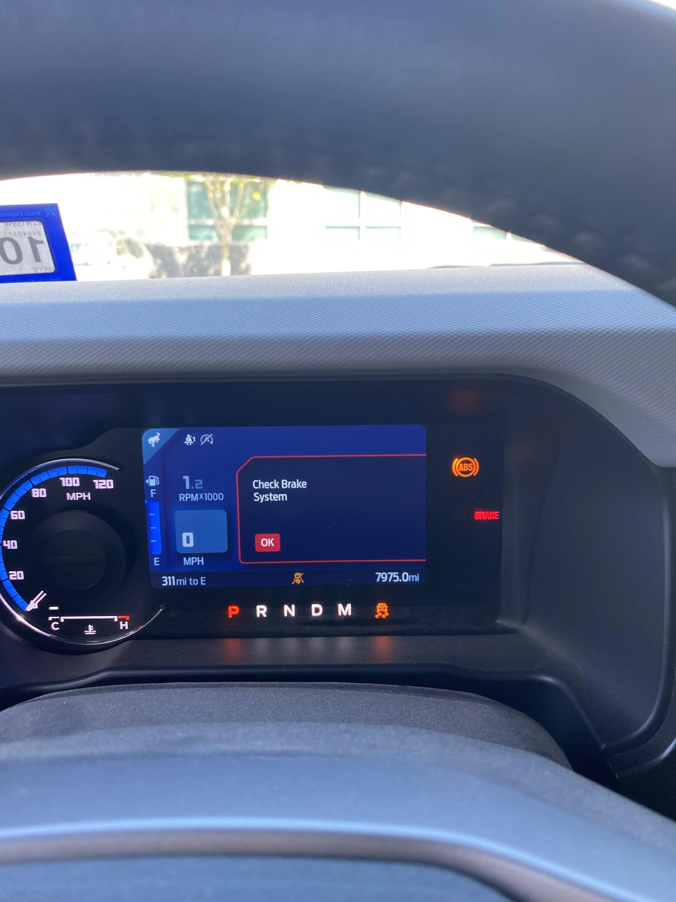

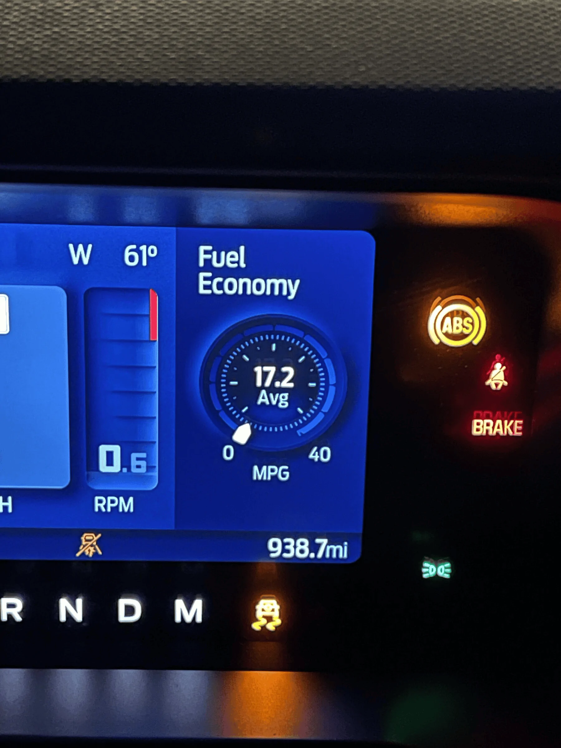

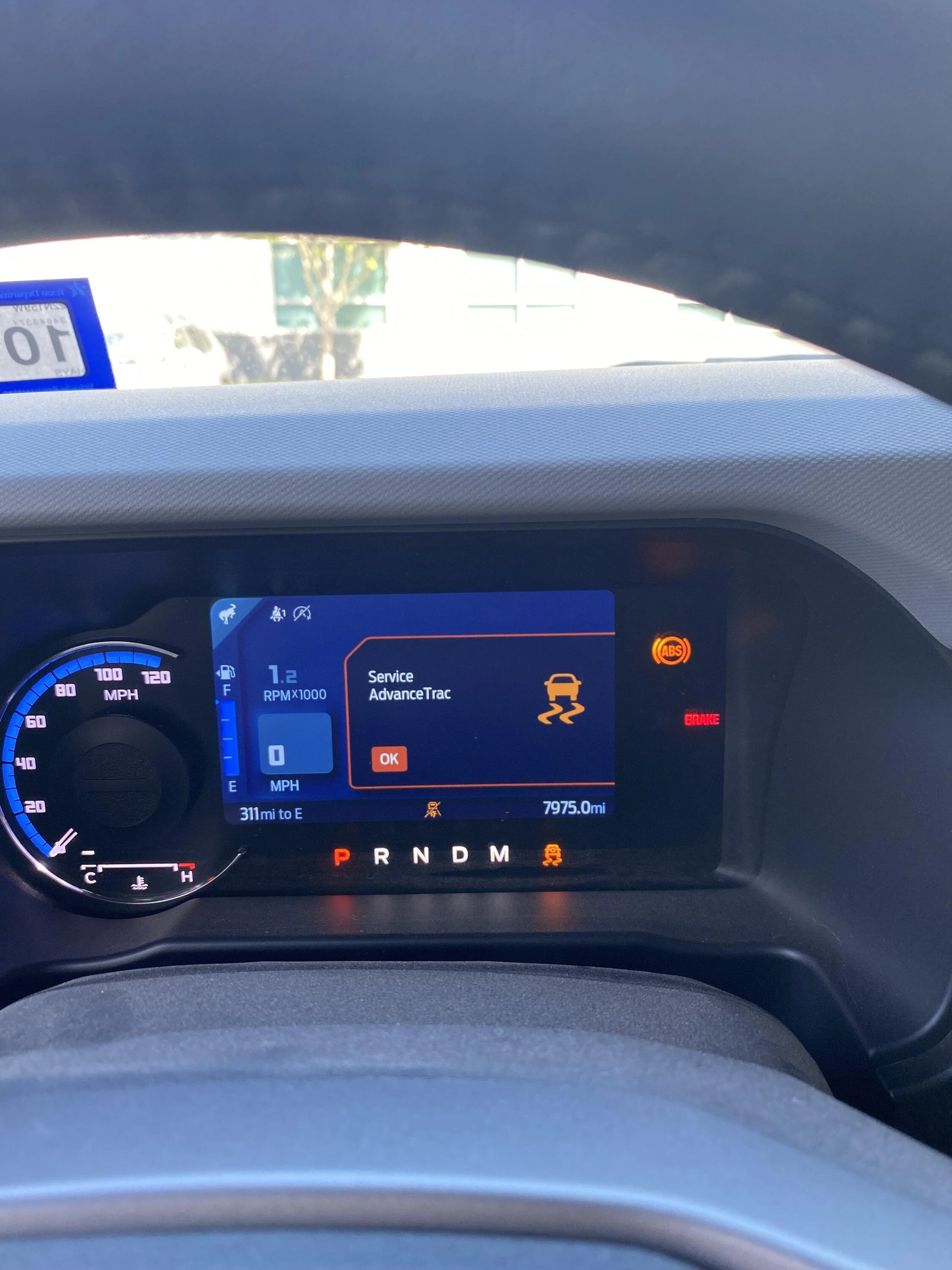

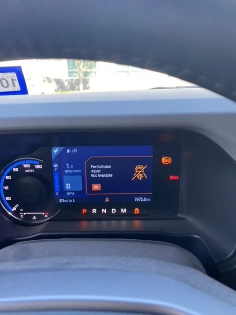

Please help me out if you know what is going on here.
About 3 weeks ago someone decided to run a light in front of me and I had to slam on the brakes. I could feel the ABS doing it's thing and a crash was avoided. My Bronco drove away fine and for a couple of days It was business as usual.
Days later I get:
Ford Bronco Error messages mayhem. IMG_2391
I hit ok, start driving and it goes away.
For the next 5 days I get nothing. On the 6th day it happens again.
Nothing again for 5 days. Keep in mind during this time the vehicle drives completely normally. Zero warning lights on in the cluster.
The next day I get these:
Ford Bronco Error messages mayhem. IMG_2506
Ford Bronco Error messages mayhem. IMG_2507
Ford Bronco Error messages mayhem. IMG_2509
Again, I put it into Drive, start going, and they all go away.
What is happening??

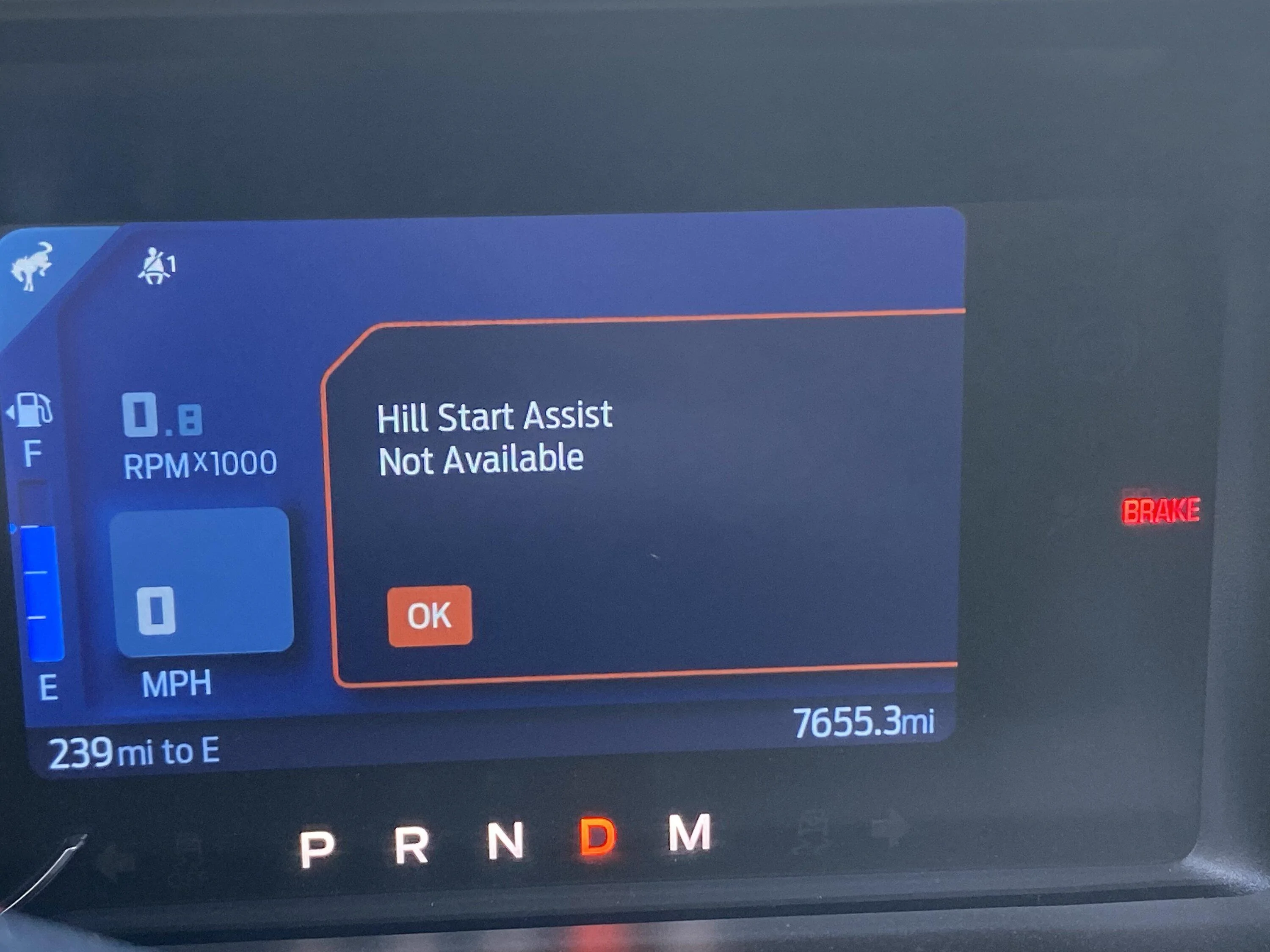

I got the same "hills tart assist not available" on my Fordpass App.....

May be related to the doors being removed. Several folks (including me) get all of those alerts when starting up with the doors off. Parking brake is engaged but after disengaging and driving off everything goes back to normal and seems to work ok.

I would check the ABS wiring that follows the brake lines to each wheel...maybe one was re-connected improperly and the hard braking pulled on it/pinched it? This sounds like a sensor issue, so just checking that all the wires are connected and not pinched anywhere...maybe a bad ABS sensor?
Dealer will help, but its a toss up if they will cover it after the lift was installed, its up to them mostly I believe.
EDIT:
I see your doors are off, when starting it, make sure you buckle up first. That has helped keep a lot of my messages from popping up.
Not a bad guess but the first messages came in before the doors were off. The latest round also happened with the doors on.

Yep, this is absolutely because you dared to remove the doors. The system goes haywire. There are other threads about this, but I believe it's especially pronounced when you start up the car, with the doors off, before you have buckled your seat belt. If you buckle first before starting, I don't think it happens as much or at all.

Step on the brake pedal hard when you go to start it. I have found I don't get those errors if I do that.

Agree with buckling up first before starting when doors are off. I had the same issue before I started to buckle first, now just a door error and parking brake on warning.

Happened to me as well, abs sensor needs to be reseated or cleaned off. Just go to the dealership, should be a quick fix.
Cool. Glad I'm not alone. I'll be going on the 20th. Thanks for pointing me in the right direction.

I got these errors once after sitting in the car with just accessory power and driver door open. After starting the car and driving away all the error messages came on but went away. Still had the hill assist warning in my app. Nothing has happened since or I would have taken the Bronco in.

Please update after your visit to the dealer. After a couple of days with my doors off(and after posting on this thread...), I am getting the same messages/warnings popping up. I just ignore them and drive normal and they go away, but if there is some easy fix at the root of it, i'd like to know.
