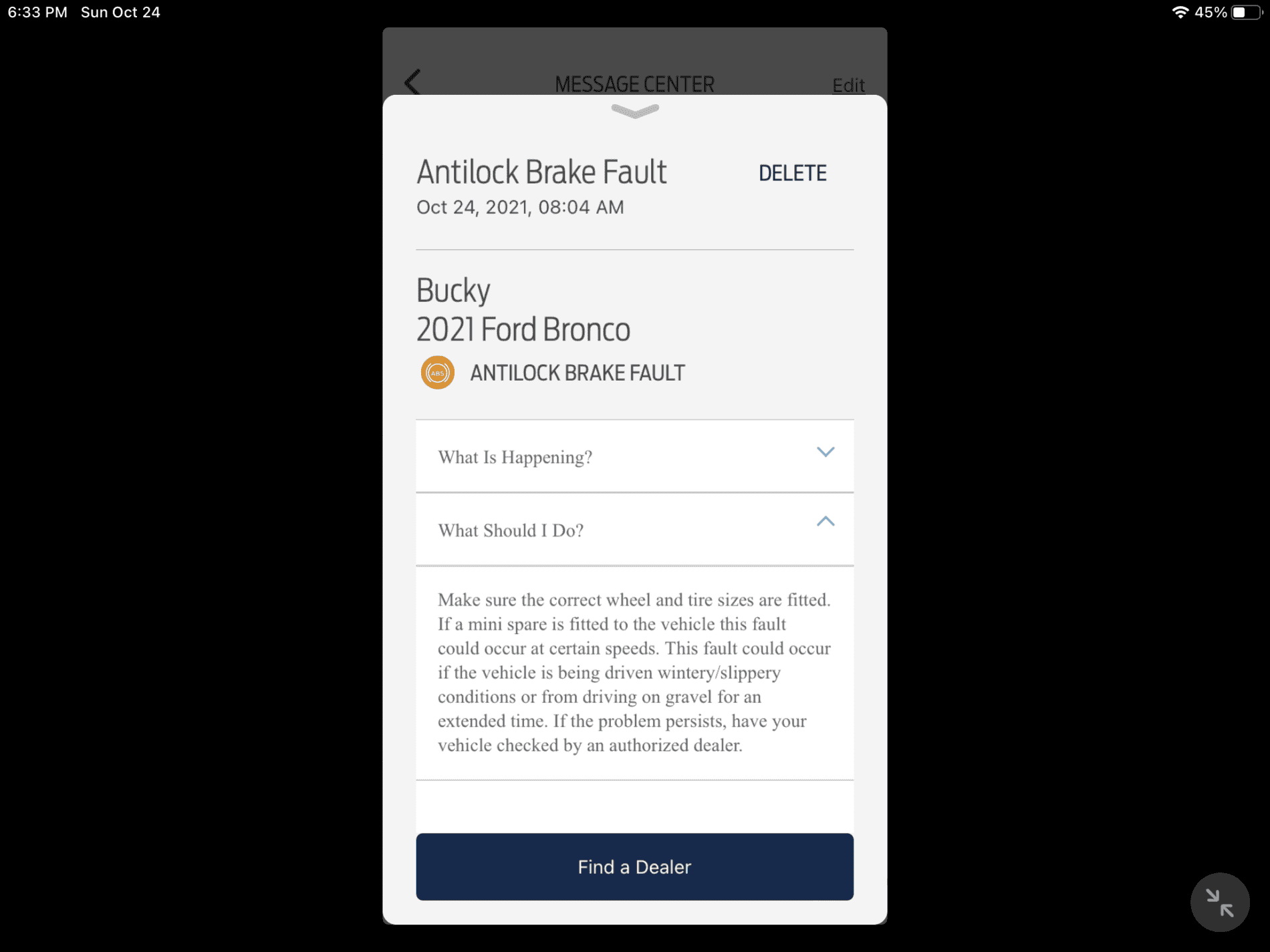

I’m in the process of plasti dipping my Sasquatch bead locks to make them black vs silver. I had two re-installed (driver side) and had two still off, when I had to take a quick drive down the highway (100 miles or so). I was cruising at about 75 when things got weird.
Suddenly my idiot lights started chiming - ABS, traction control and collision avoidance all threw warnings at once. My Speedo went from saying I was doing 75 to saying 35 even though I had barely slowed down (both digital and the old analog looking one). I tapped the brakes trying to figure out what was happening. I pulled off the next exit, cycled the car but the problem remained.
The Ford pass app captured and displayed two warnings: Anti lock break fault and pre collision assist not available. When it gives these errors it also gives some additional info. One thing it said was something about it possibly being related to traveling at certain speeds with a mini spare… which made me realize that without the bead locks I have a pretty significant weight difference between wheels. I stopped at a hardware store, bought some tools and took the two installed rings back off. No issues since.
Does this sound plausible? Anyone ever have similar issues? Damn thing freaked me out on my new Bronco.

Just a point if clarification, those are beauty rings and not beadlock rings. Unless you beadlock mounted your wheels, but then you wouldn't be driving 75mph after removing them.
I think it is more coincidence than related to the removal of the rings. They probably only weigh a couple of lbs each and it's not like the Bronco is measuring rotating wheel mass while driving. There is also not any electrical connections on the rings that would signal they have been removed.
You could always take them back off and see if the error reappears. If it does reappear, with or without the rings, I suggest taking it to the dealer asap

I will have the dealer check it out…. Any auto engineers or techs on here with experience here?

It has to be something with the rotating mass and possible tendency of lighter wheel combos to want to rotate faster, and if any traction loss, will. The warning about a donut, which would due to smaller diameter rotate faster than a standard wheel is an indicator. You did not change tire diameter and you did not change unsprung weight by much but the system just might be that sensitive.

My guess is system sensors on parts of the drive train or traction control collectEd data that was outside the normal operating parameters and threw alarms.

I took it to the dealer to check it out. They saw a code for the sensor on one of the non bead lock wheels. They though it might have been a loose sensor connection, but didn’t find it… I didn’t mention the bead lock being off.
They found some dirt in the sensor they thought could have been the cause, but it sounded like they were just trying to find a likely cause. The good news is, they gave it a thorough check and didn’t see anything.
I will post back if it recurs.
