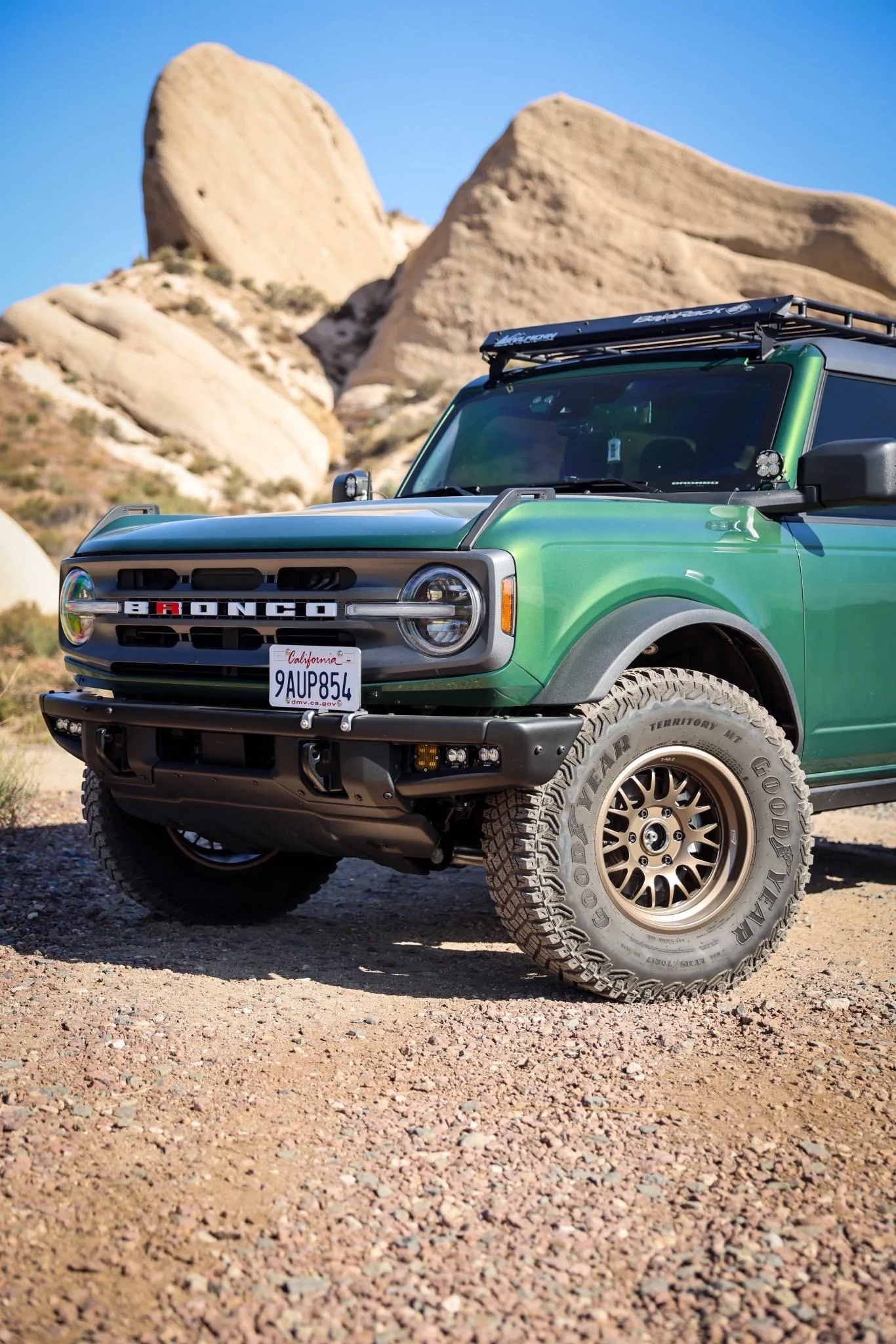

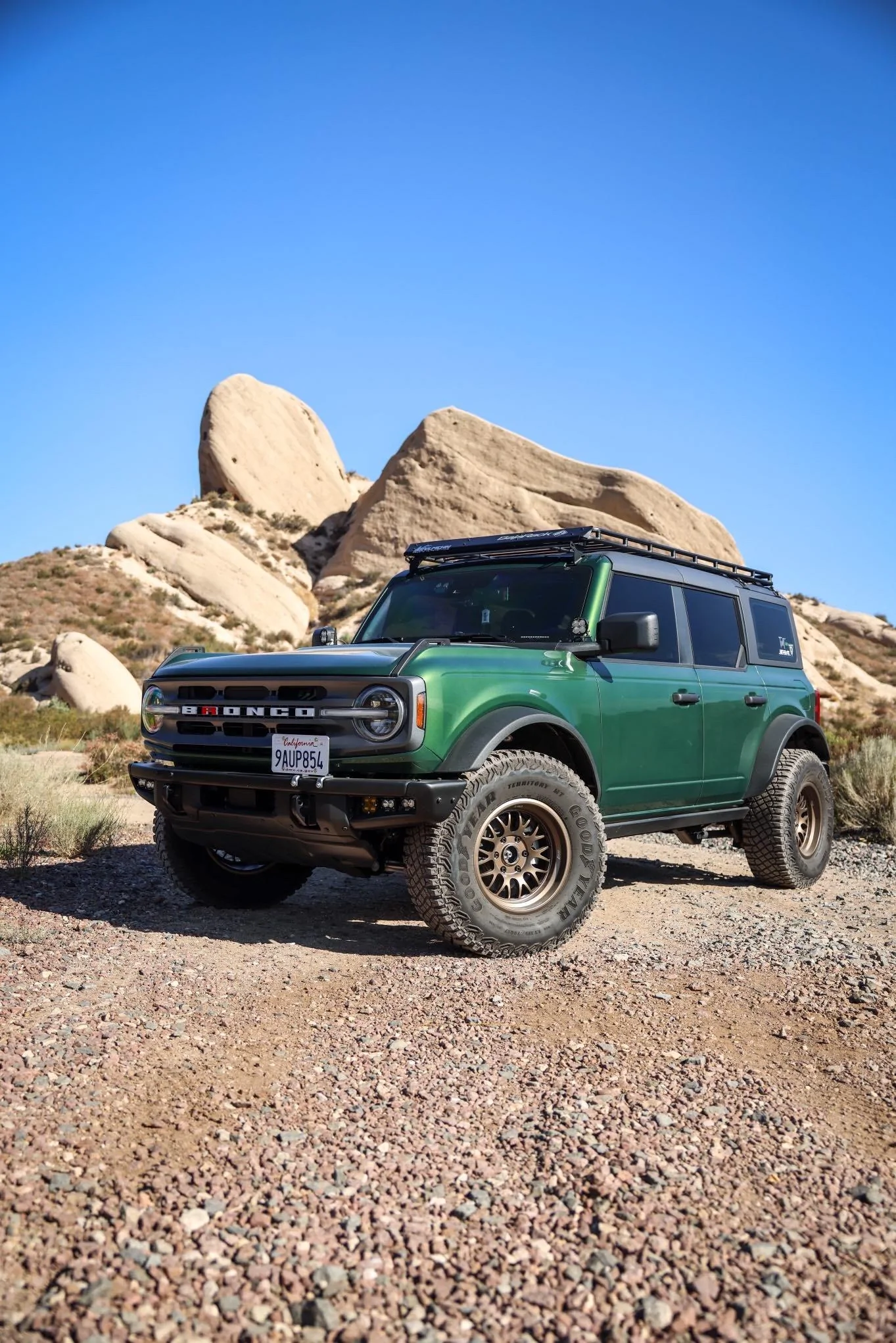

Soooo, I was driving up to Pismo Beach from LA this past weekend and it was dark when I left. I was driving with cruise control when the sun started to come up, behind a silver minivan. As the auto headlights turned off, I saw in my reflection that the DRLs turned amber.
During a gas stop, I went out to check and to my disappointment, they were white again. At the pump in front of me was white Land Rover, and when I switched to drive, I saw in the reflection that they turned amber again.
Then I remembered that this only works in R and D. So my question now is, HOW did you take a picture of your rig with the amber DRLs on?
Put in neutral with parking brake on.
