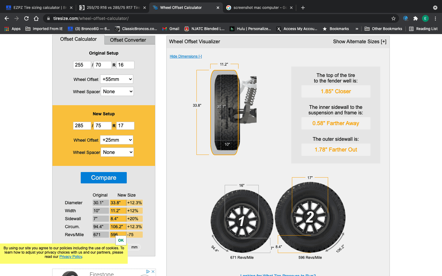

Look at the offset calculator at the tiresize.com site.
https://tiresize.com/wheel-offset-calculator/
HoosierDaddy
__ Eric
Mar 6, 2016
6,029
15,735
Indiana
Here's a Base 16 vs a 285/75-17 on +25mm wheels.
That info on the right is precious.
Speedo error is listed below but not shown on this screen cap.
Ford Bronco EZPZ Tire sizing calculator 1626062202226
