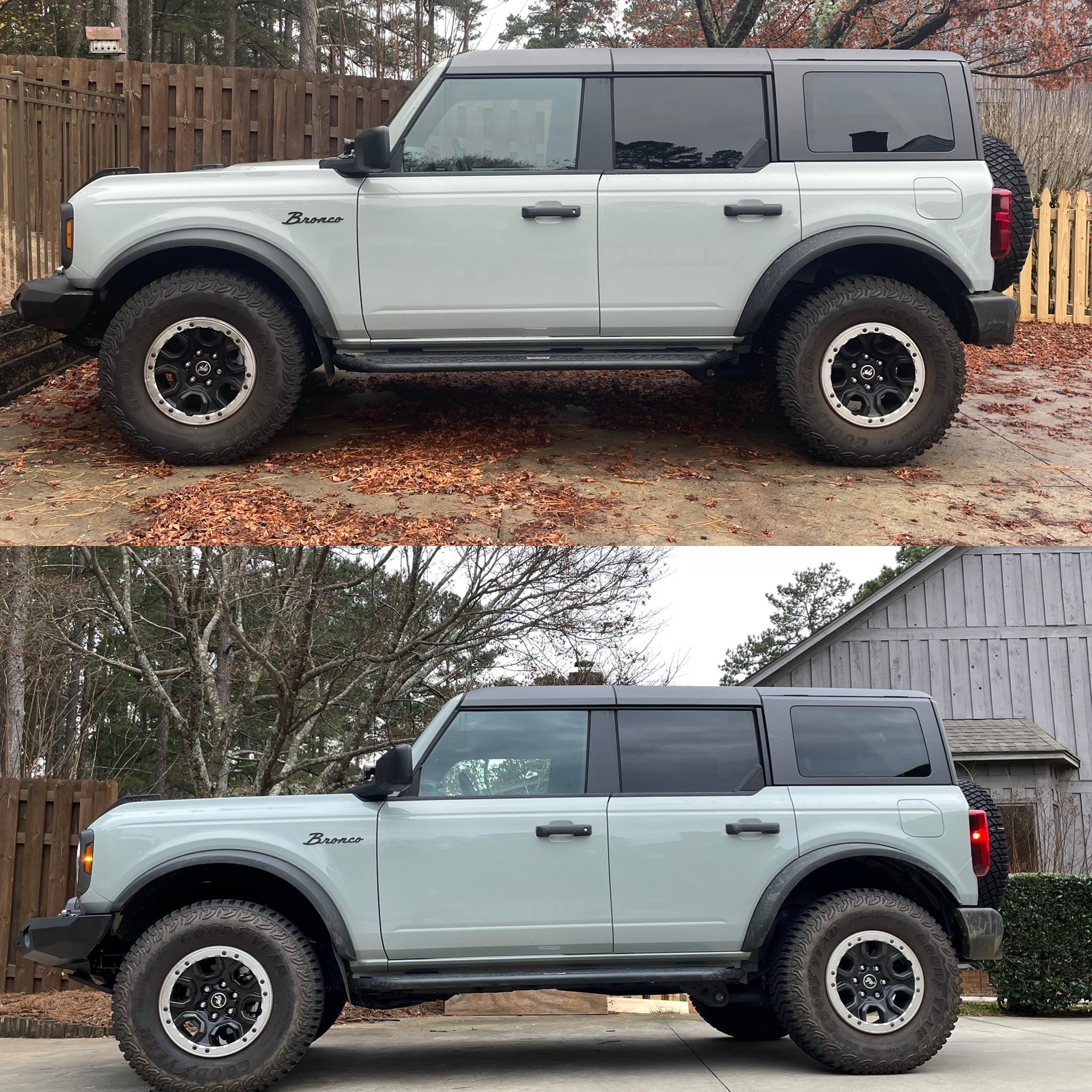

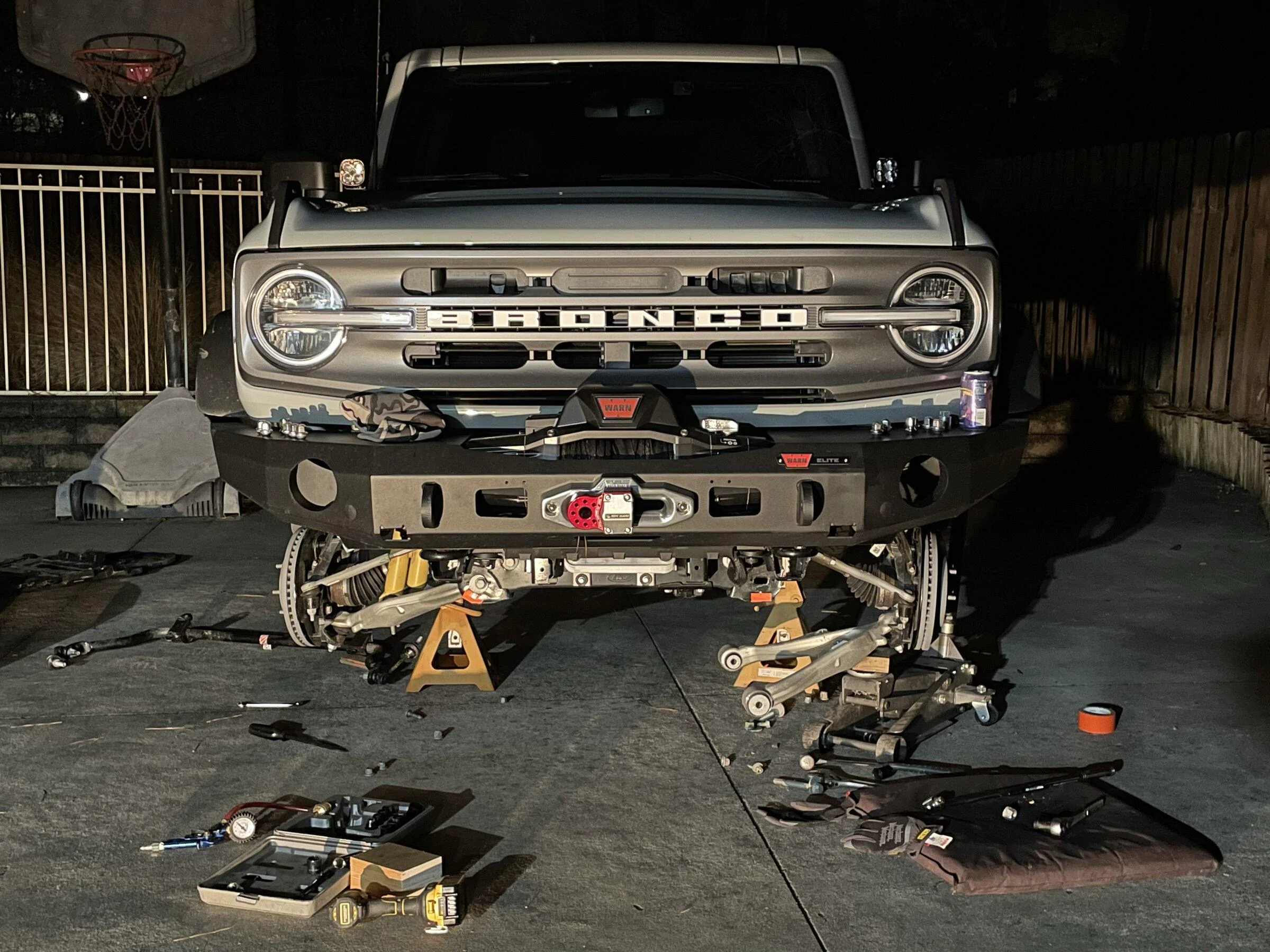

I installed one on my SAS Big Bend last week. After I lost about 1/4 of height due to the extra weight of my Warn bumper and winch, the front was even more obviously low than when it was stock. The fab-tech lift is sold as being a 1.5" lift, but I got almost 2" of lift with my kit (although I didn't re-measure after the alignment was done.) Not sure if it will settle in and end up 1.5". YMMV. Here's a couple pics of the before and after. They are not the best comparison shots because they weren't taken from the same angle but will give you a general idea if you look at the space in the wheel well. Mine is almost exactly level now and I'm very happy with the results. Very high quality billet aluminum spacers. Install wasn't exactly fun but I saved some money doing it myself and learned a bit about the suspension in the process. I didn't exactly follow Fab-techs instructions, instead I went with the method shown in the video that Stage 3 has posted on installing a leveling kit. (Dropping lower control arm.) Not sure if this method was necessarily better because detaching the lower control arms was a PITA. You'll need a McPherson strut coil compressor to do the job with either method as well as an alignment when you're done. I used some of my ford pass points so didn't pay a dime to have it aligned at my local Ford dealer (Tires Plus wouldn't touch it due to the lane assist/collision avoidance system associated with the steering so the dealer is pretty much your only option.) The dealer did a great job with the alignment. Steers perfectly straight and the steering wheel is perfectly centered.

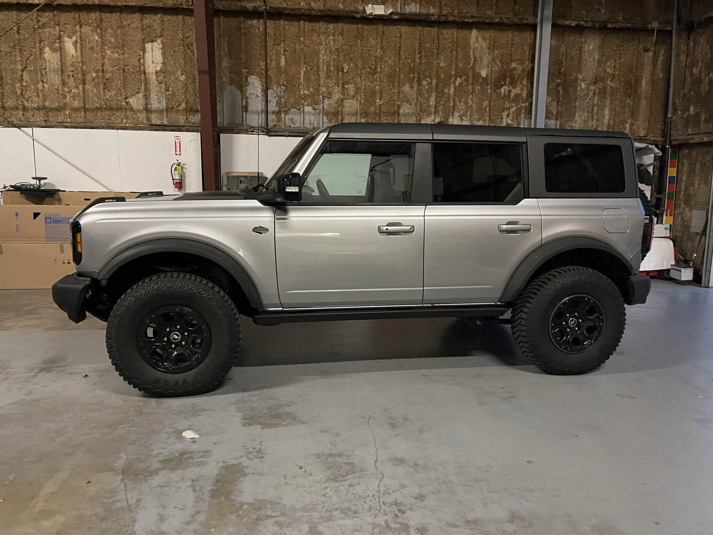

Well I got it installed the other day. It is a noticeable difference. I’m hoping it settles a bit in the front because it measured a bit higher in the front. New 35/12.50r17 Nitto Recon Grapplers are getting put on as I speak.

It will settle and be perfect, congrats

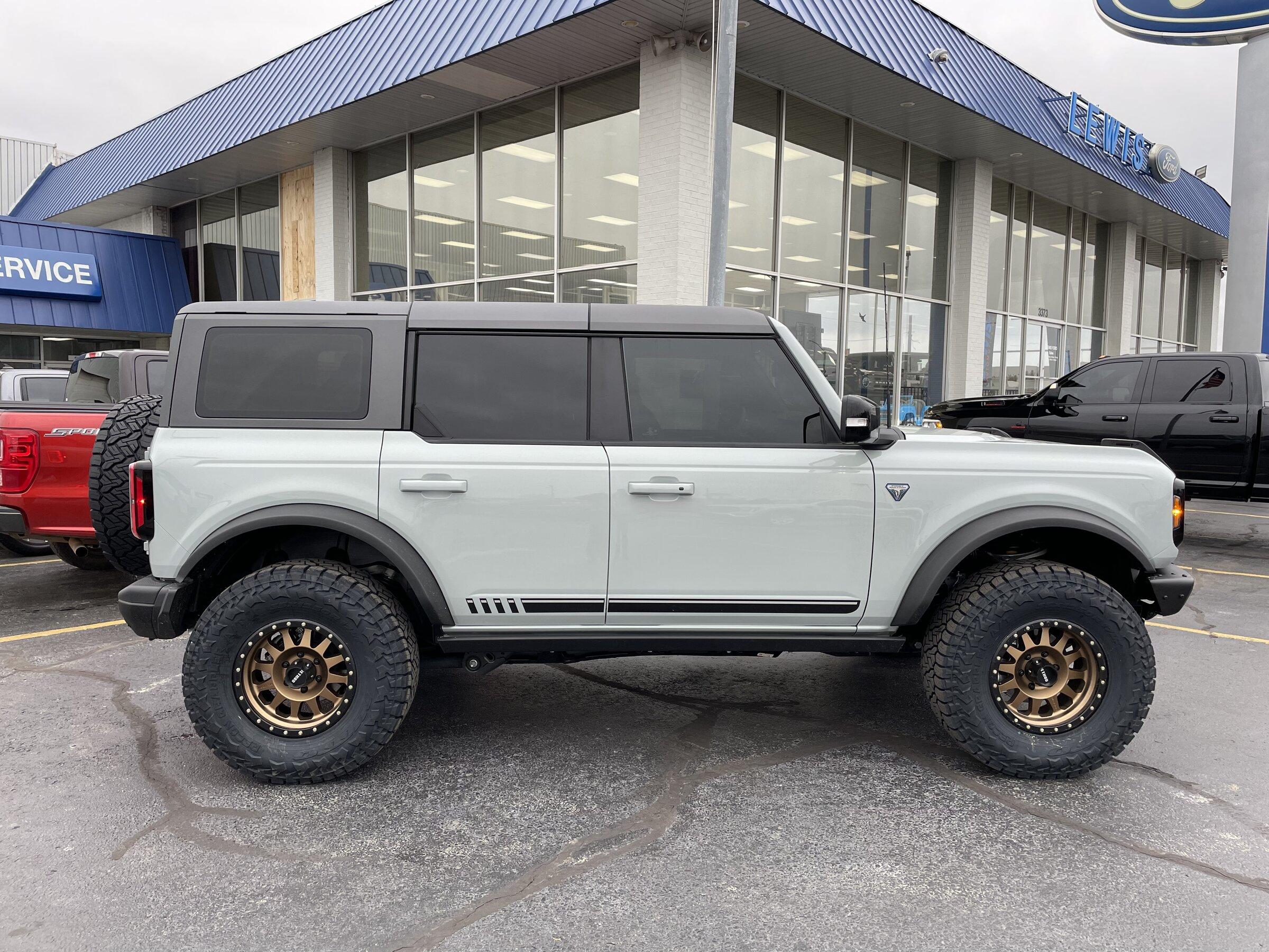

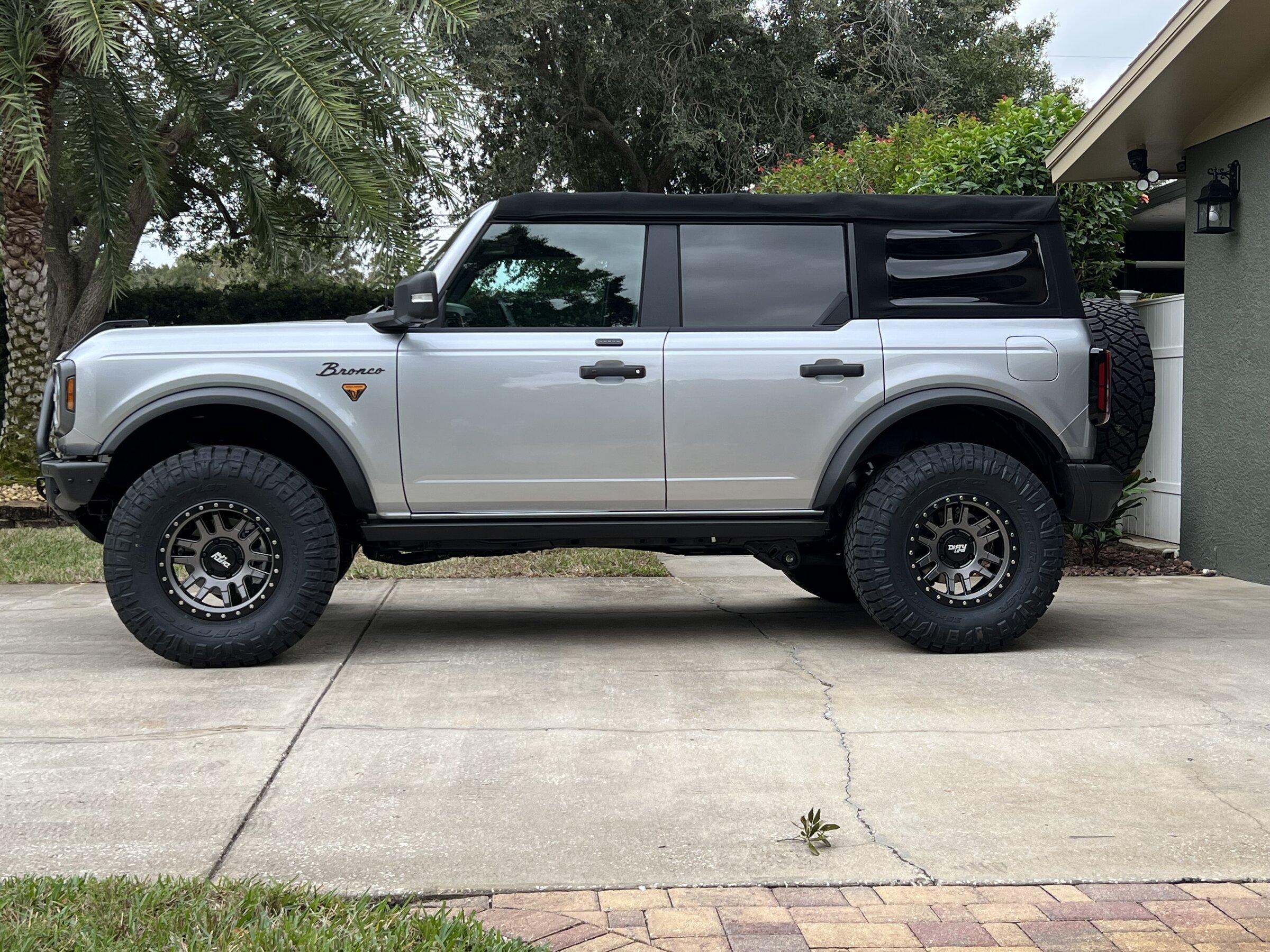

Do you guys think it will fit 37x12.5x17 tires using the Sasquatch wheels? I just installed, looks like there is enough clearance. tires look almost too small now.
TxMike
Miguel
Nov 24, 2021
61
Ford Bronco

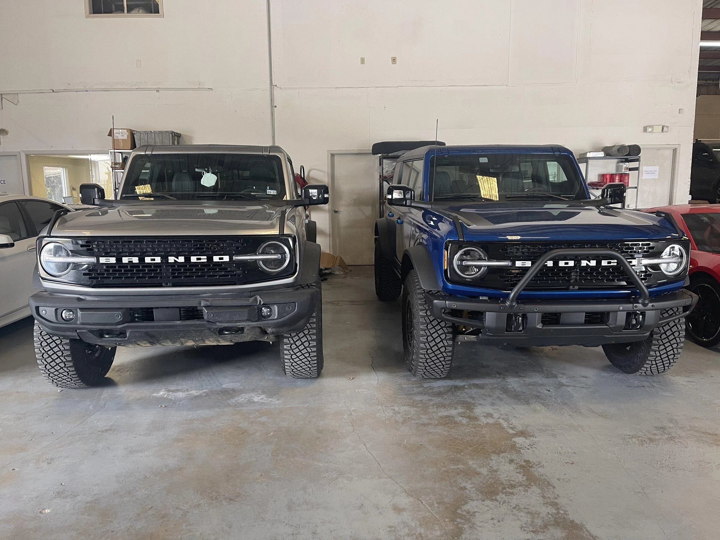

You can tell the silver wild track is now taller than the blue first edition.
TxMike
Miguel
Nov 24, 2021
61
Ford Bronco
I would go with ko2’s given they come in more at 36.5 inches.
