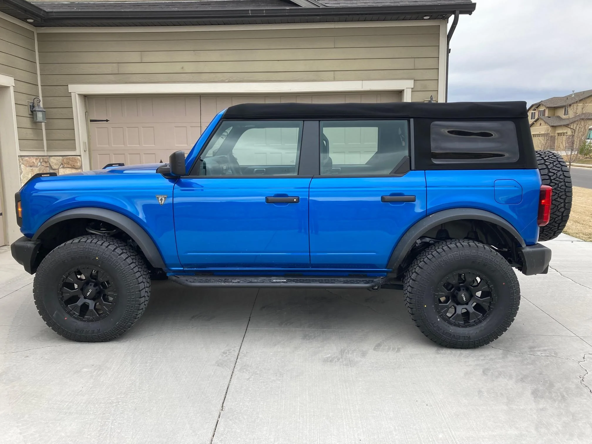

Do you guys think it will fit 37x12.5x17 tires using the Sasquatch wheels? I just installed, looks like there is enough clearance. tires look almost too small now.
Absolutely they will fit and look better too!

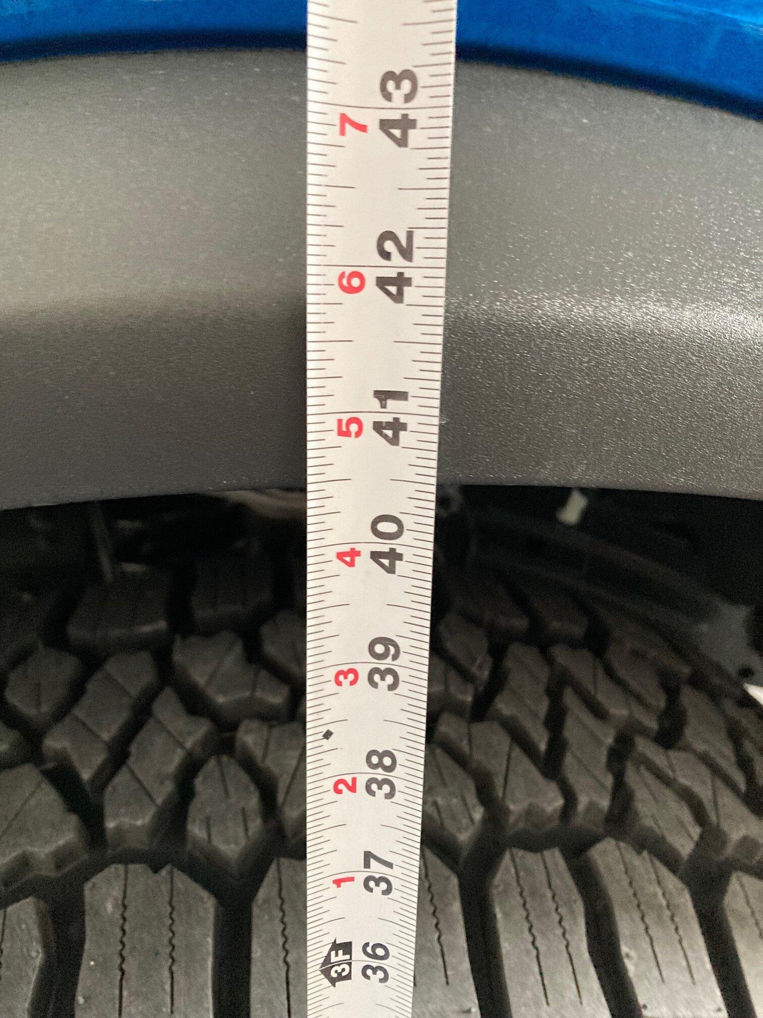

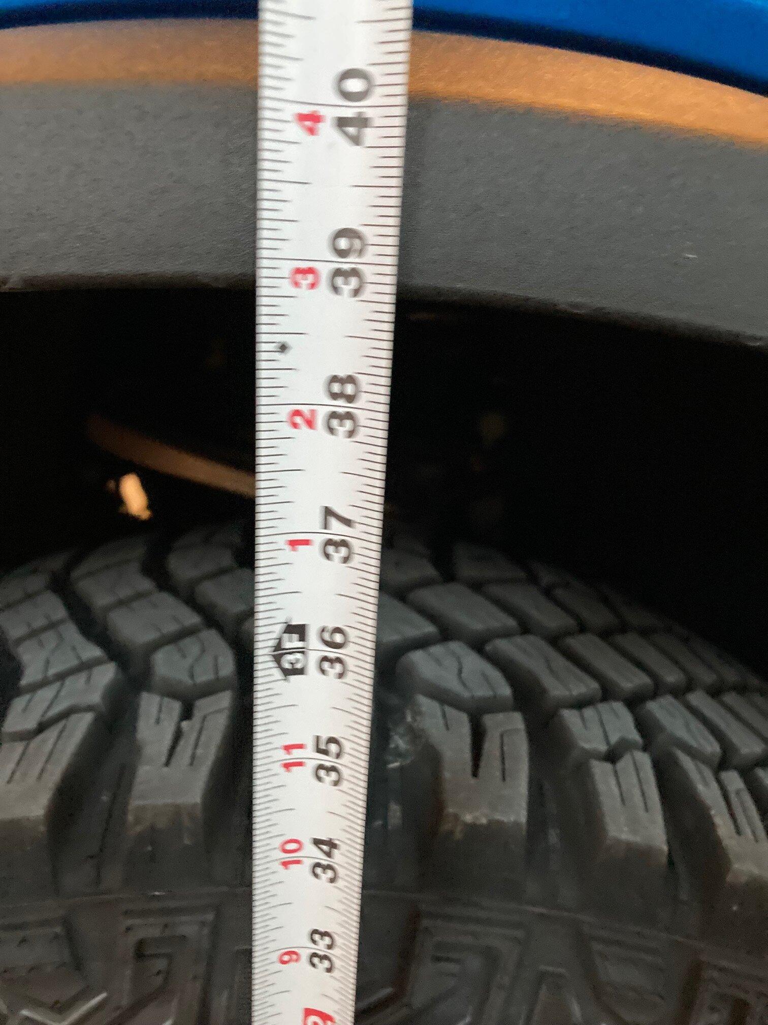

Mine went up 1.5" as it was supposed to. I also added .5" left to the rear. Total I have 3/4" of rake.

Very happy how ours turned out! I finally got the time to install it this weekend and it looks freaking awesome. Got a full 1.5in of lift out of it. We bought some Sas takeoffs from facebook market and they look perfect in my opinion. Still need to add a little lift in the back but pretty much exactly level all the way around once its settled a bit. Call it the CheapSasquach! lol
Fenders are all right around 39 1/4. Back is a tad low with a full tank.
