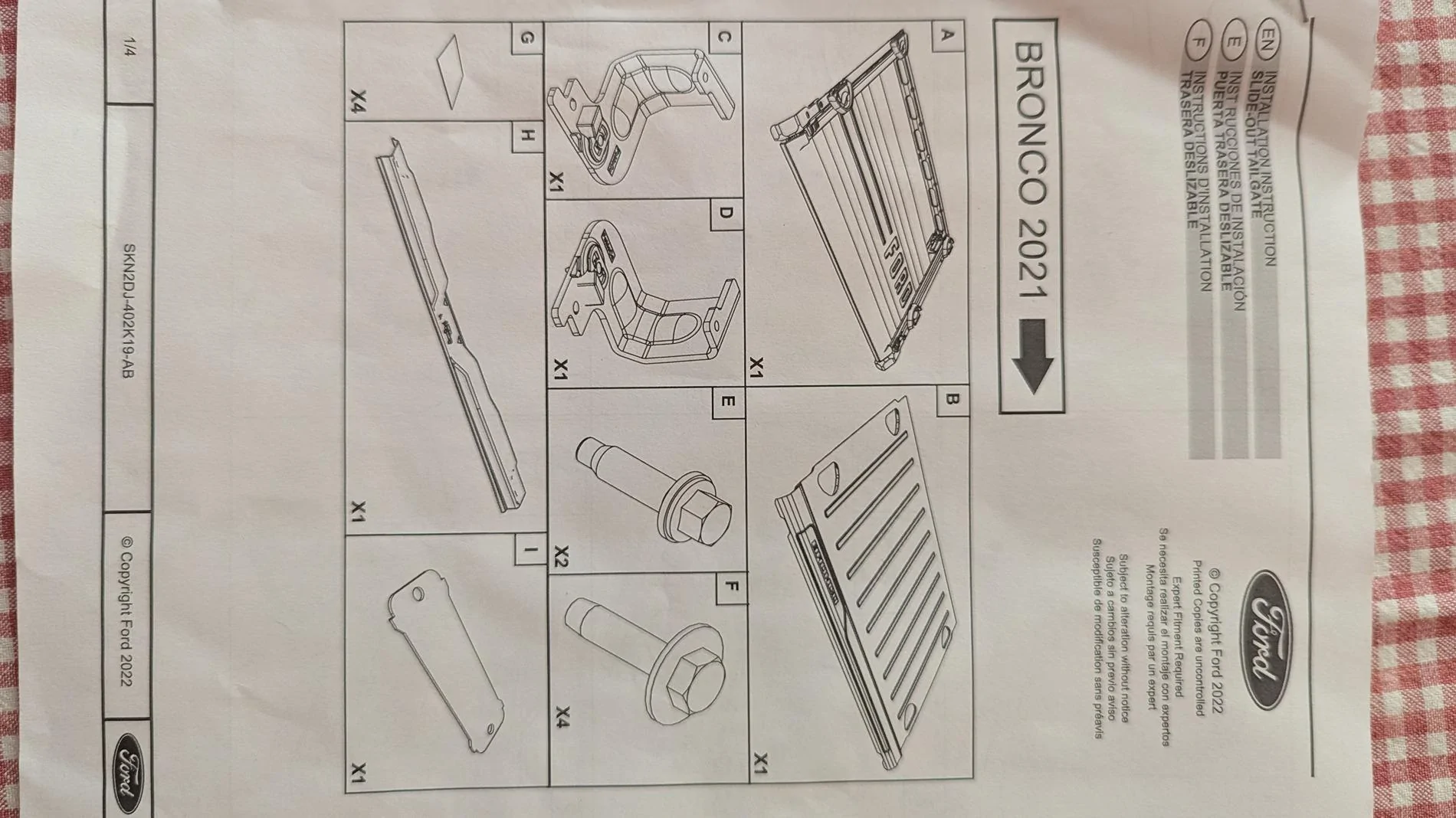

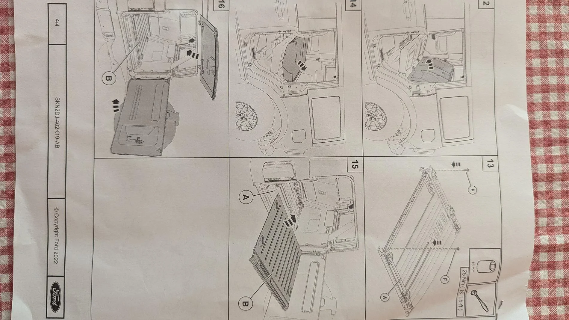

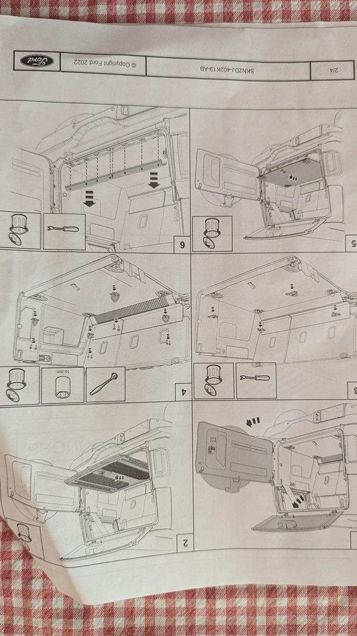

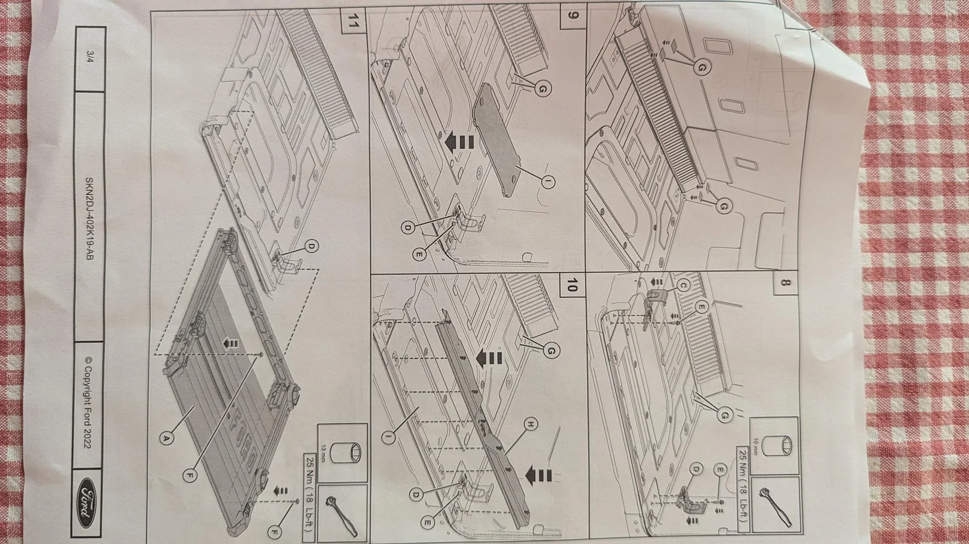

And also the door threshold replacement this might help just follow in reverse.
Ford Bronco Factory-installed slide-out tailgate removal PXL_20240702_123725695
Ford Bronco Factory-installed slide-out tailgate removal PXL_20240702_123712488
Ford Bronco Factory-installed slide-out tailgate removal PXL_20240702_123734420
Ford Bronco Factory-installed slide-out tailgate removal PXL_20240702_123743380

Just sent the instructions to you via msg. Everything that shows being tossed into the trash is the parts you need to replace the SOTG.
