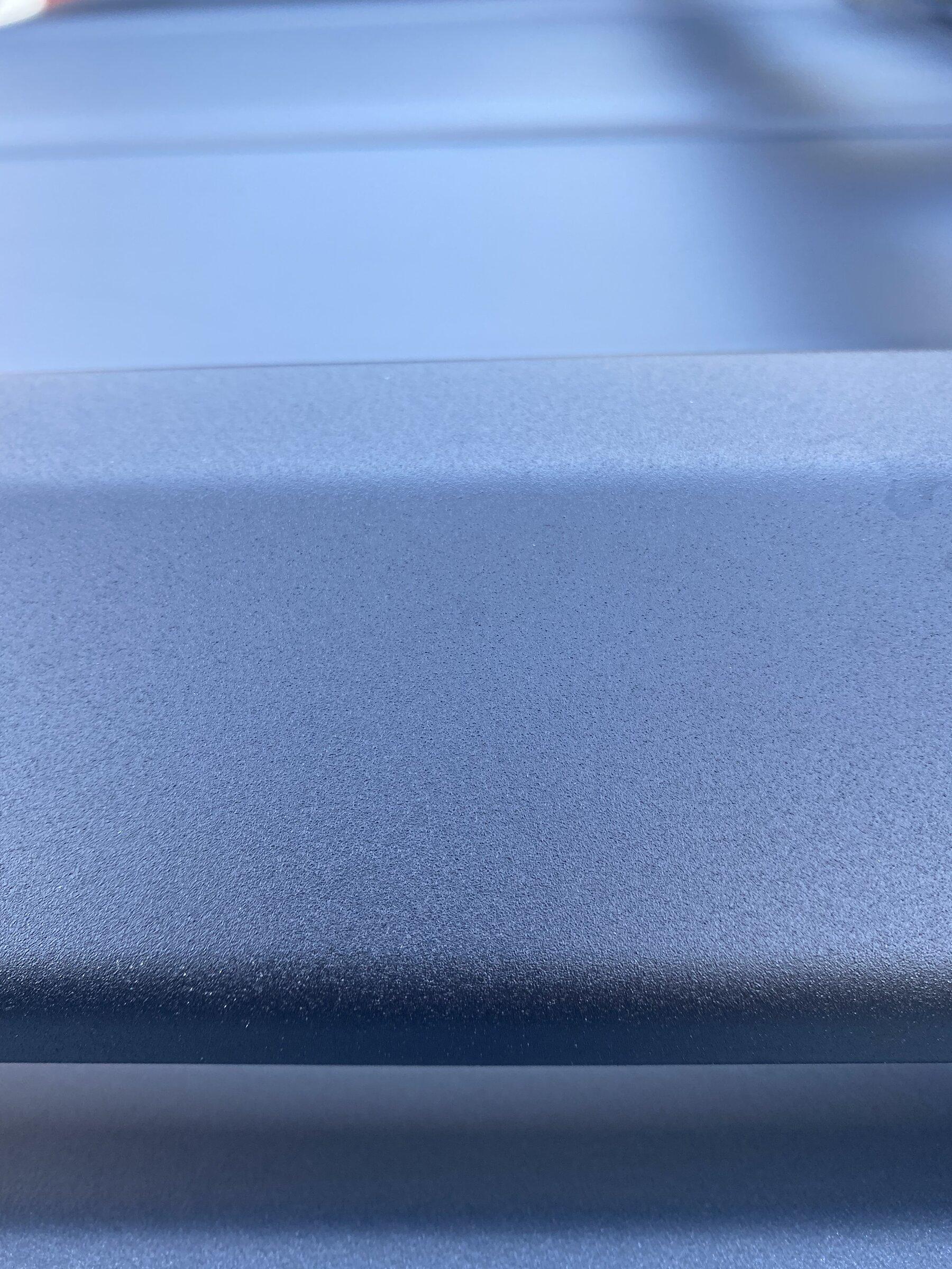

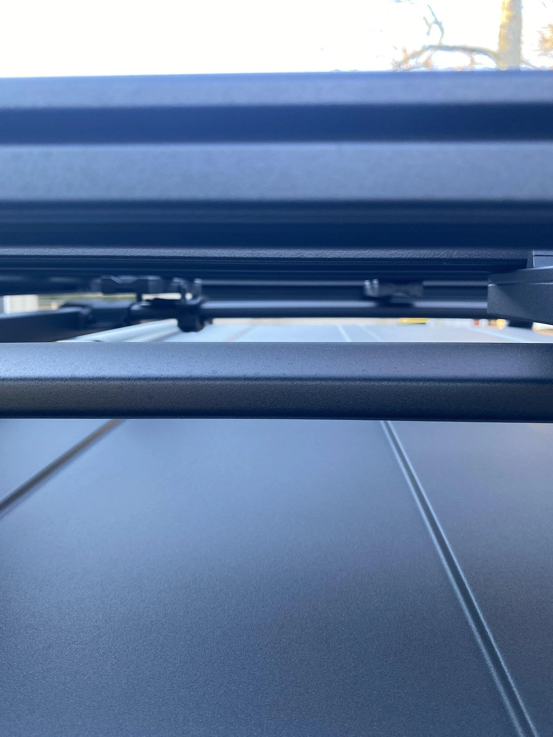

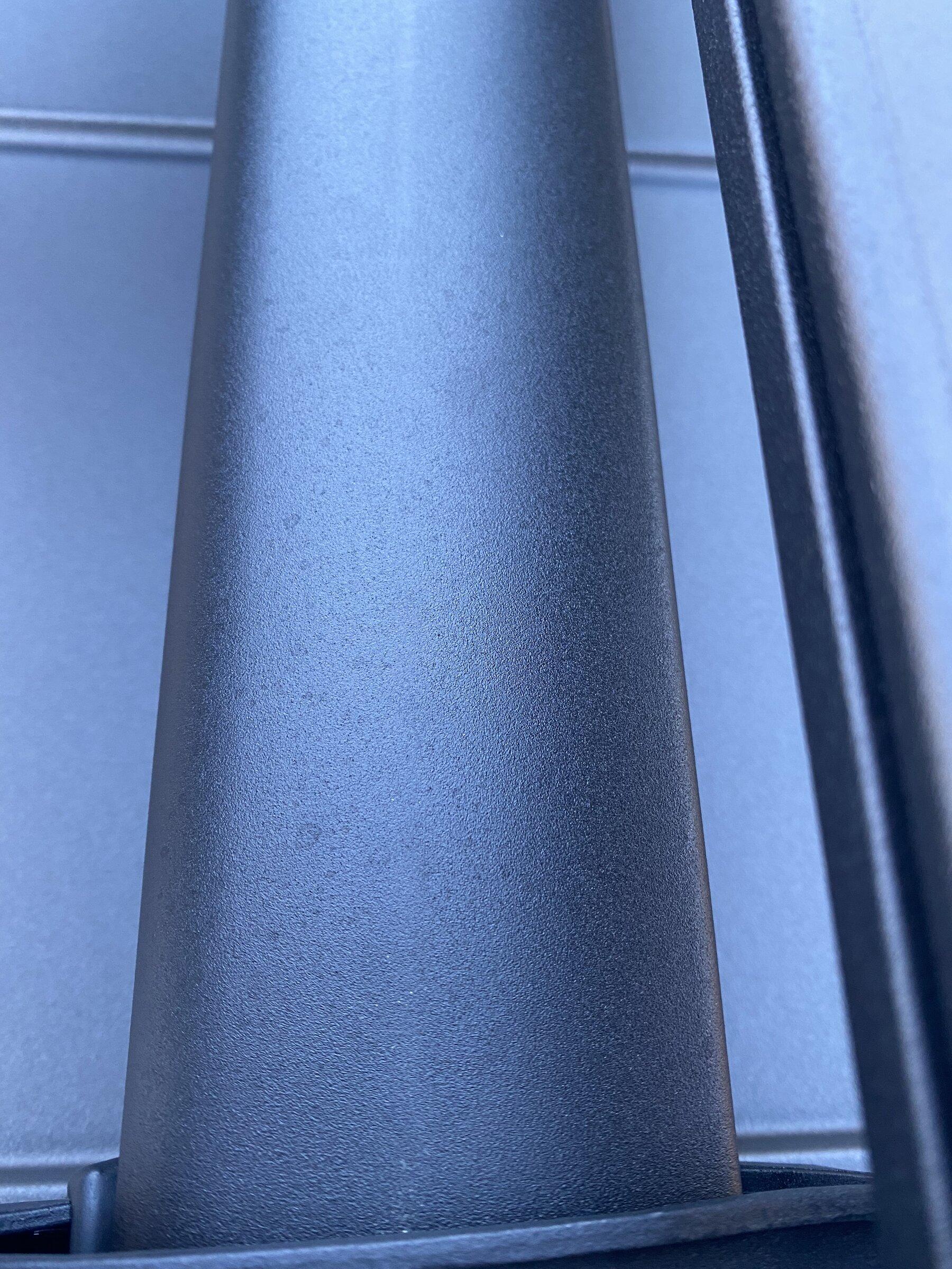

The first two pics are of the cross bar and the last one is from the side of the roof rail that runs front to rear.

Do you have the width and height of each bar?

Thanks! do you have the width and height of each bar. The mounts I am looking at are for up to 3in did bars... I hope the cross bar will fit even with the non circular design or its back to the drawing board.

I have the factory roof rack on my two door. The cross bars are just under 3 inches wide. I didn’t do the height - it’s not much - maybe a half inch.
The side rails are three inches wide and 2 inches high. It’s not square on top. It tapers a bit towards the inside.
