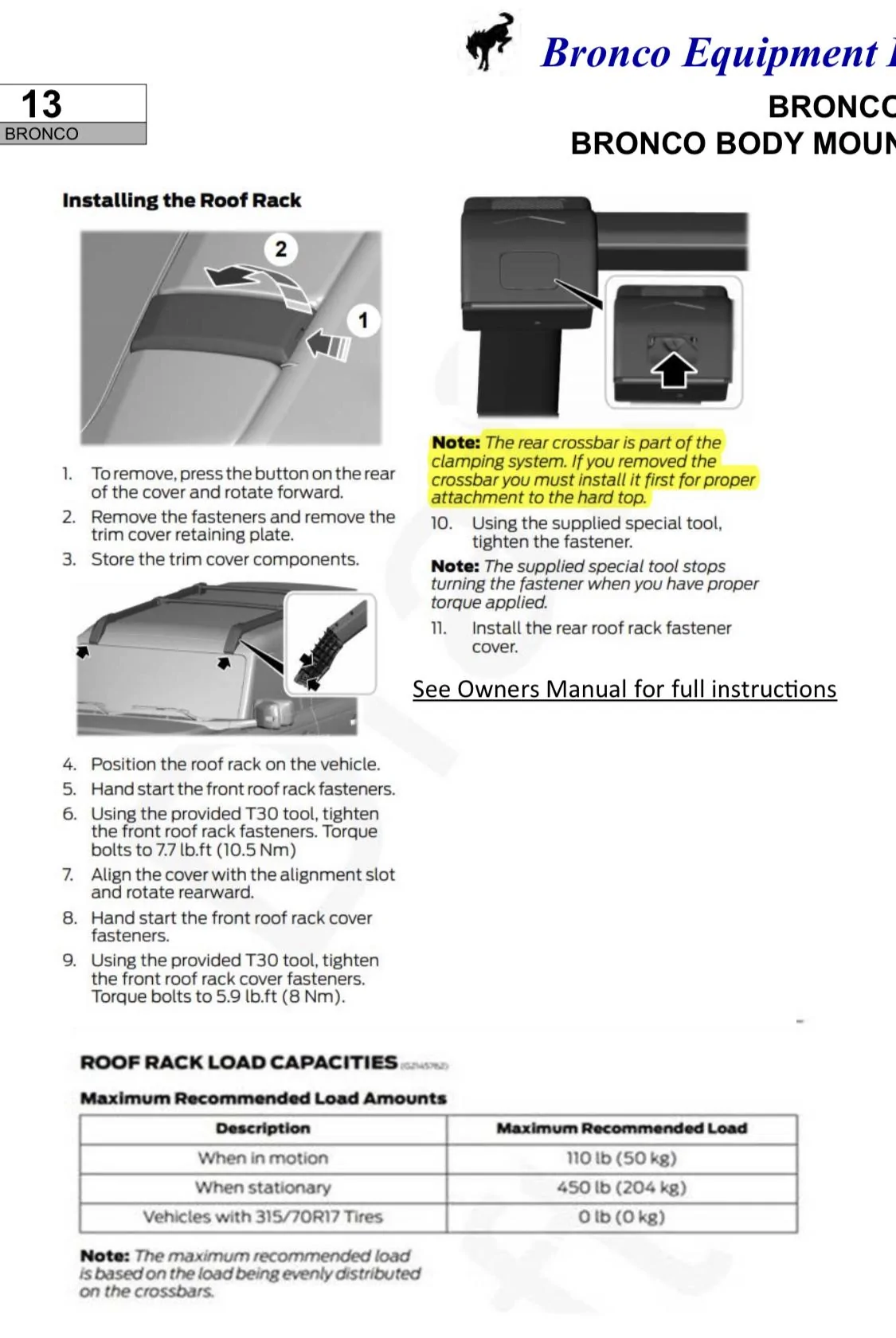

Pretty sure the rear crossbar just presses into the two end clamps. Grab one of the end clamps and tug it towards you, away from the vehicle!
Yeah it kinda does. It sits on the clamp with a rubber dampening liner in between to reduce scratching and rubbing. The clamps can't be pulled enough to clear the lip of the MIC. At least I haven't figured it out yet. The video is so misleading, which is part of my frustration. The two guys literally lifted it off like it was just resting on top of the roof.

Does this help? Maybe work the installation in teverse
Ford Bronco Factory roof rack removal from MIC 89839B7B-91C6-4142-BC68-A6A02DC14B58
I don't think so but I didn't try removing the rear cross bar. It doesn't say to in either video but it's worth another look. Appreciate the photo though.
