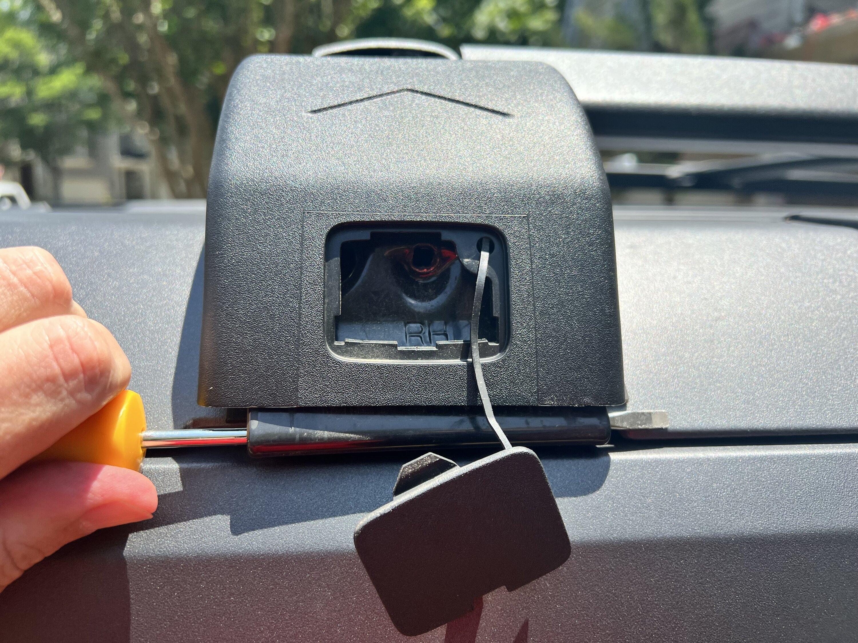

They are sticky under the the triangular bolt. I had one side that dropped down and out of the way, the other needed some prying to break free and slide down and out. keep wiggling it with a bit of screwdriver prying and it will work.
Did you separate the rack from the rubber liner with the screwdriver? Is that how yours separated?

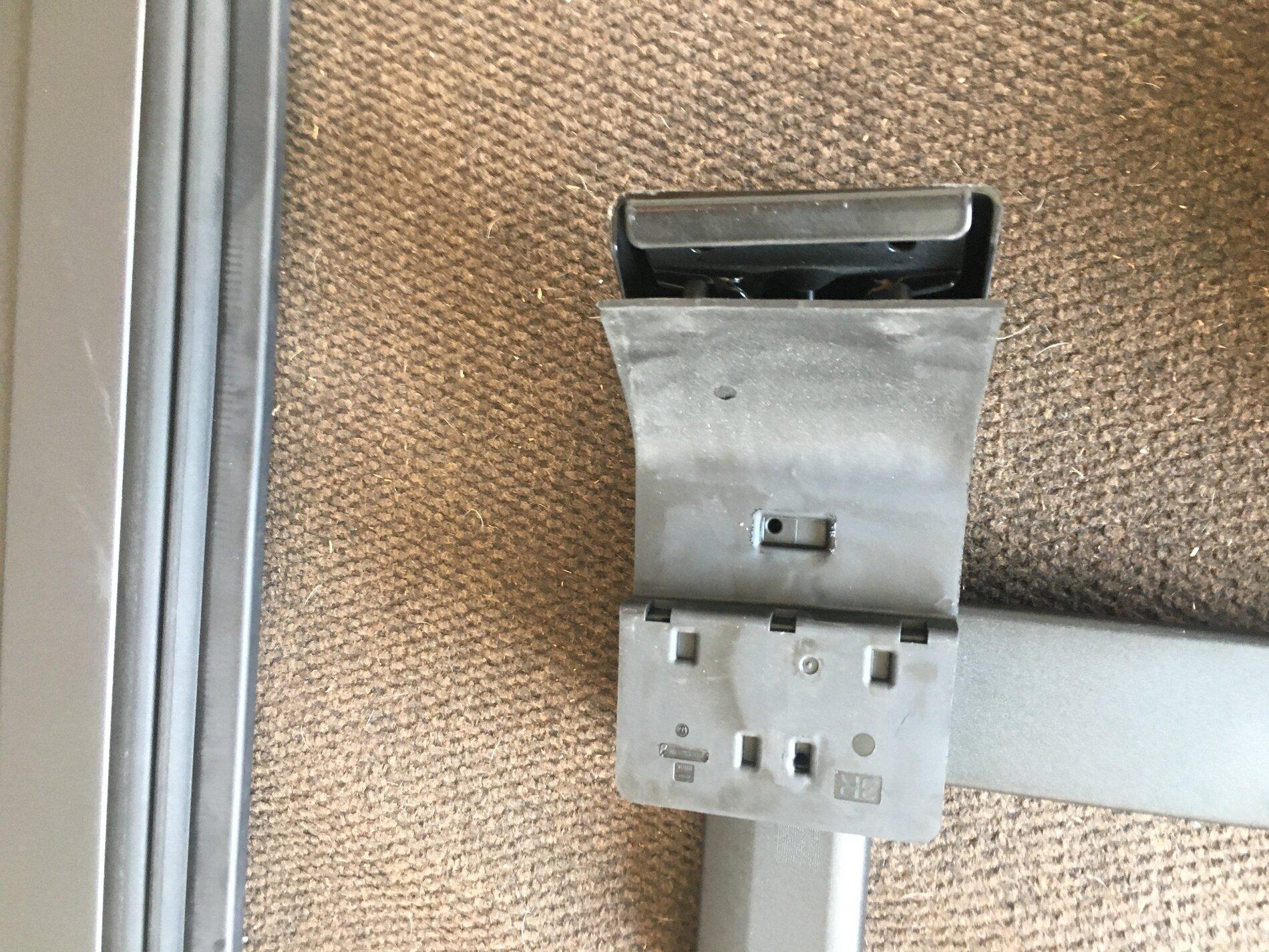

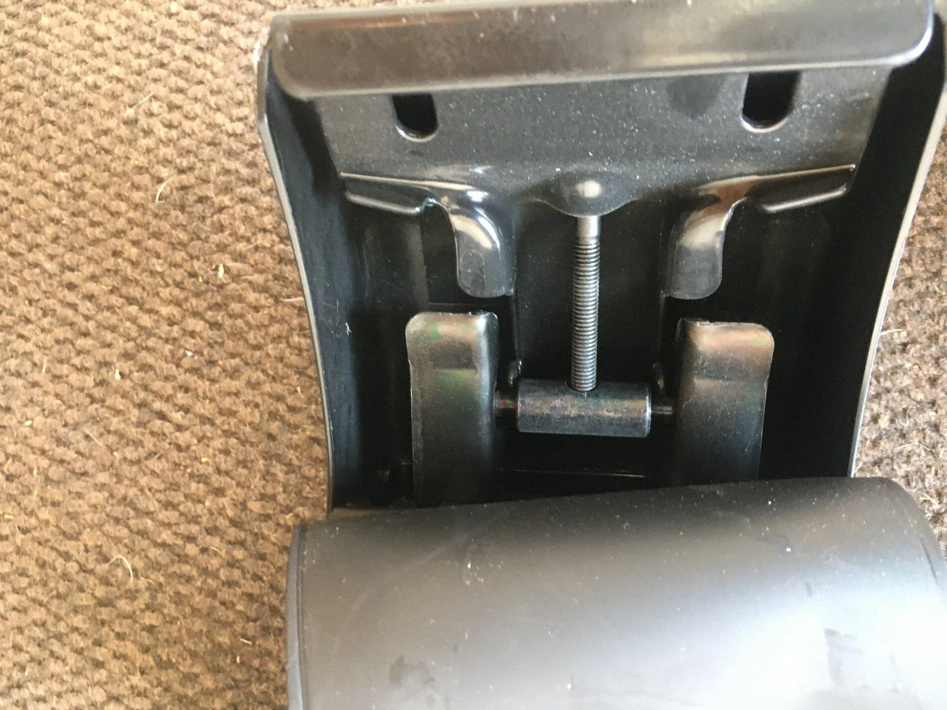

So here is what the clamp looks like on the underside. First time I removed it I took one bolt all the way out. I'm sure that is not the intent but I just reattached it. Watch spinning the barrel nut as I think it only goes one way. It's better to keep it attached.
It actually gets easier after the first few times.
You don't need to remove any crossbars. I remove the front mounts and cover the windshield and MIC roof at the front before doing the rear clamps.
I loosen both sides and then shift it to one side and put a small wood shim to keep one clamp from reengaging the MIC.
Follow the torque settings for all bolts. The rear clamp tool is preset and will click once and reset.

Old thread, but me too. Took my rack off so I can take my middle panel out and I could not get the thing to come off. Felt like an idiot. Finally got so frustrated I just started yanking on those stupid clams and they finally let go!
I had even backed one of the screws out so far (thinking it wasn't loose enough) the thing came apart on me.

Yeah... Once I got the rack off, I could see the long bolt, how it worked, And there's a little "retainer" If you can call it that, that's supposed to help you know you've backed out far enough. I just had to put that retainer back on the threads.

(35) 1/2 Turns on each side is enough to drop the clamps to remove the top, and not too many turns where the triangle bolt spins loose from the barrel nut on the other end.

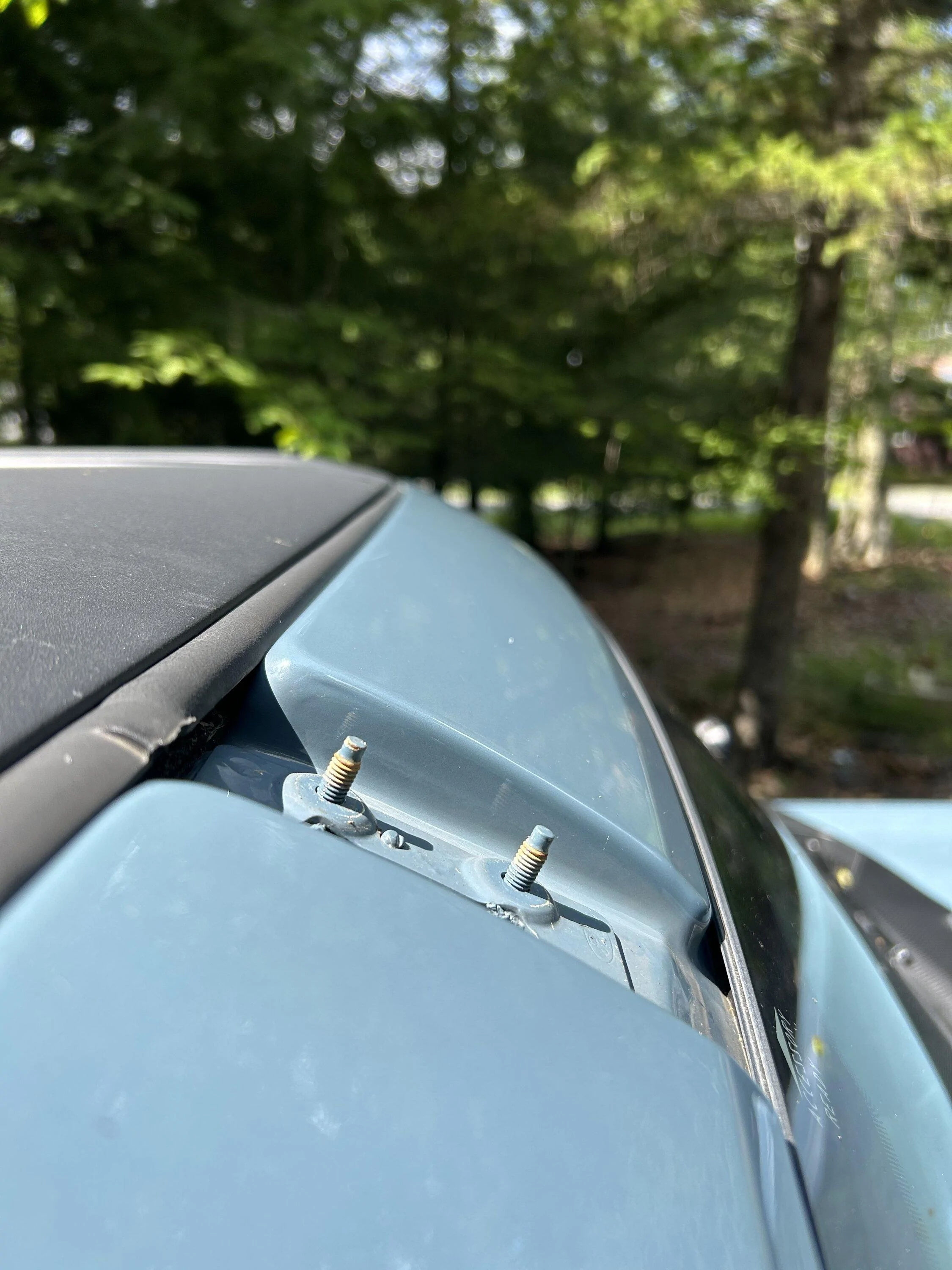

No, it’s a valid question. I’ve had the rack off/on multiple times and just happen to be re-installing at the moment. The reason I don’t think it will work is that the front roof rack mounts need to move forward about 1/4” due to the angle of the mounting studs to remove while the clamshell can only move straight up due to the B pillar.
I suppose it might be possible to lift the clamshell a couple inches to clear the pins and get enough play to get the front rack mounts off but I’m not willing to try it. Plus, aligning 8 points with the additional weight going back on might be a beach.
