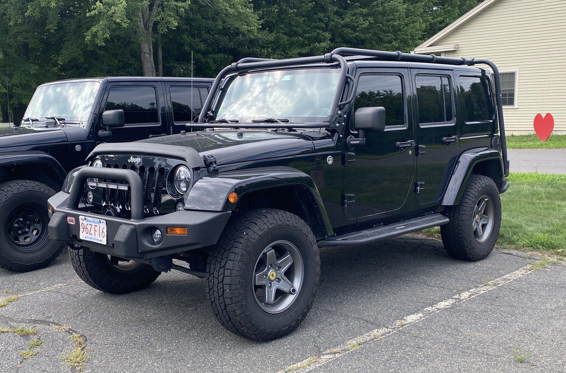

Vehicles with removable or composite tops (Jeeps, and now the Bronco) don’t have a very robust structure to support a roof rack, so dynamic loads are relatively low compared to a vehicle with a solid roof.
If you need higher capacity, you either need to go with an aftermarket rack that reinforces the hardtop roof from the inside (and prevents easy removable), or go with an exoskeleton type system that attaches to the body and the frame down lower (and allows roof removal or even soft top use).
Here’s what’s on my current Jeep. Dynamic load is over 400 lbs:
