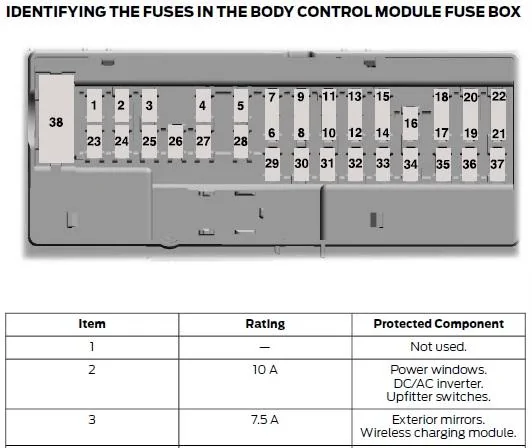

Yeah, definitely should have a switch. Our Tacoma has one.
Fuse #3 under the dash is the one used but it also controls the mirrors.

Just splice in a switch- then you only have to take it apart once. As far as I know there's no other way to turn it off.
da_jokker
125
6,173
7,104
Jeep Wrangler JKUR
Yeah you could totally do that. I've drilled a couple holes in my center console on either side of the 12 volt plug. You could totally get yourself one of those round little toggle switches and wire it in to the charger.
Of course just make sure that the switch can handle the amperage (maybe tied in through the negative side?)
