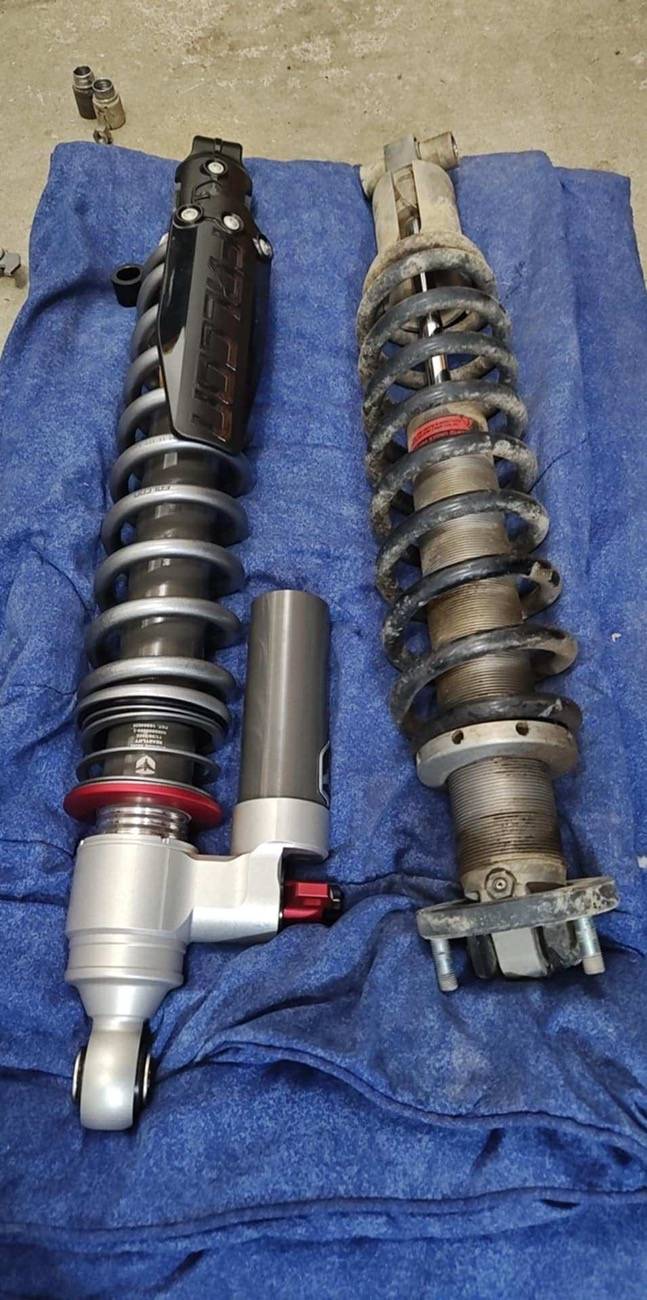

I seriously looked at the Falcon shocks but decided I didn’t that much of a lift. I ended up going with the Bilstein 6112.
hope you like them. 👍🏼
