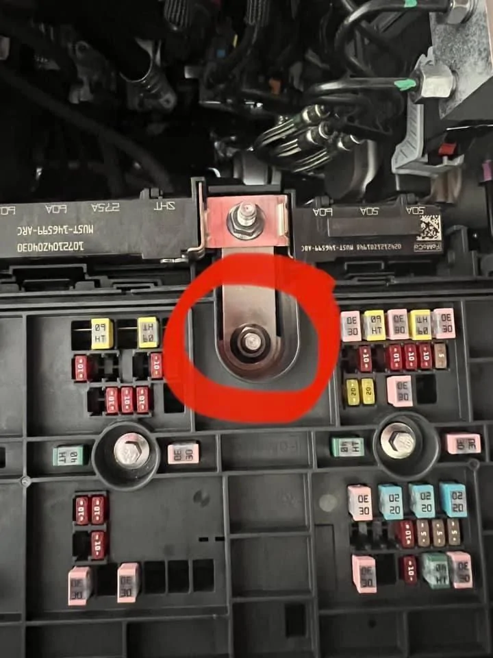

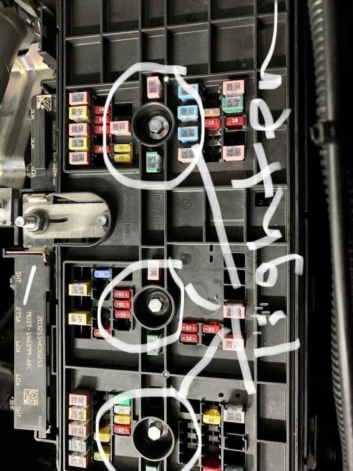

Sounds like the loose fuse block screws issue.
I had heard of loose connections, but thought I had heard it was at the power distribution box near the battery. They were secure. Thanks for the pictures, had I more time (I have extra people around for the holiday), I would have chased it some more, but it’s sitting at the dealer right now.
