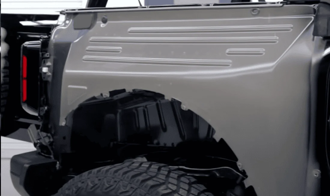

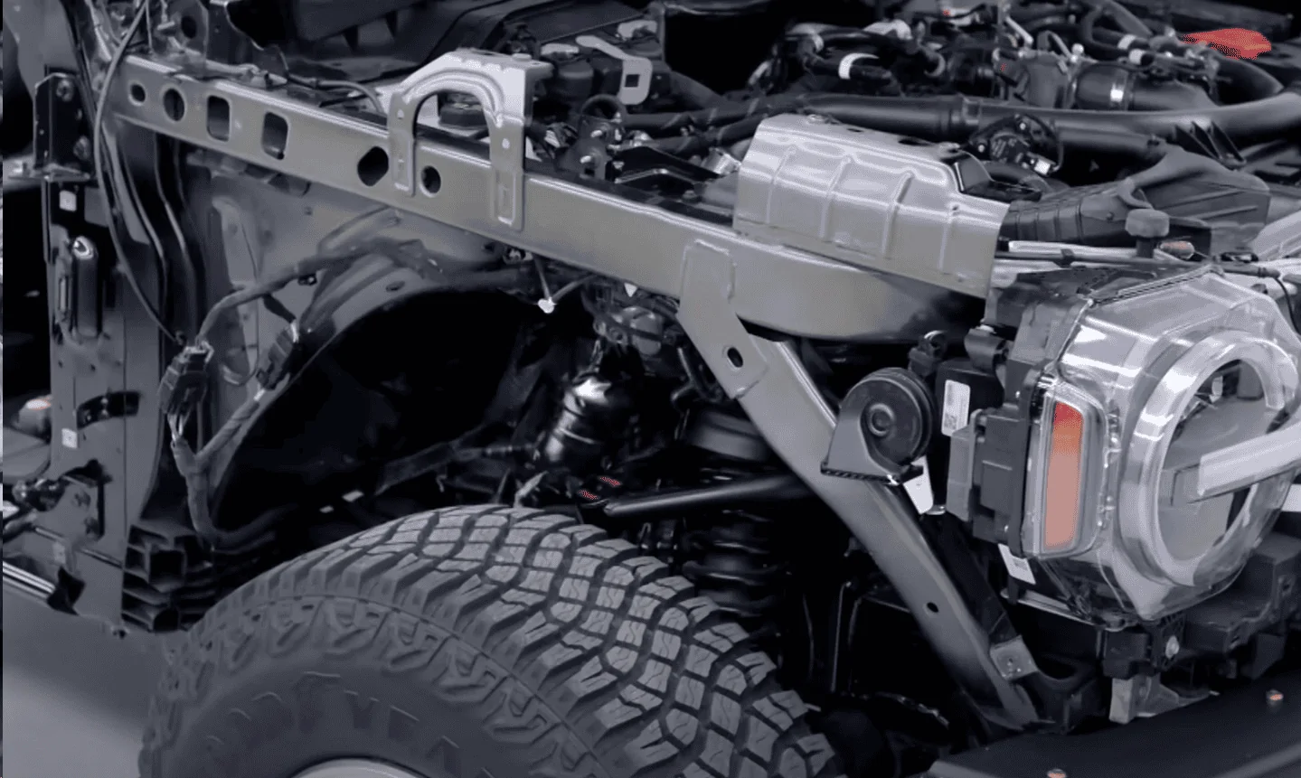

Except with
It’s usually not the outside that affects clearance, it’s the inside when you turn the wheel that will rub on something...
But on the Bronco you can replace not just the fenders, but also the body panels. I mean seriously.

I guess we will know the ins and outs of the options soon enough.
Clips taken from the SEMA build
