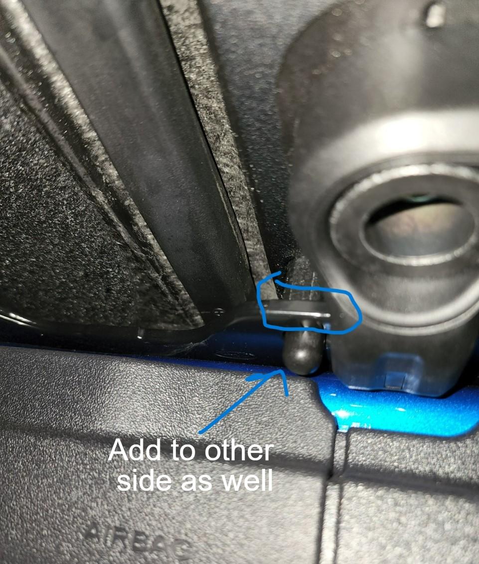

Hello everyone.
There is another thread talking about using some grease to fix the clicking noise from the MIC top, however I don't like that method since it leaves a residue that can get on your hands when removing or replacing the top.

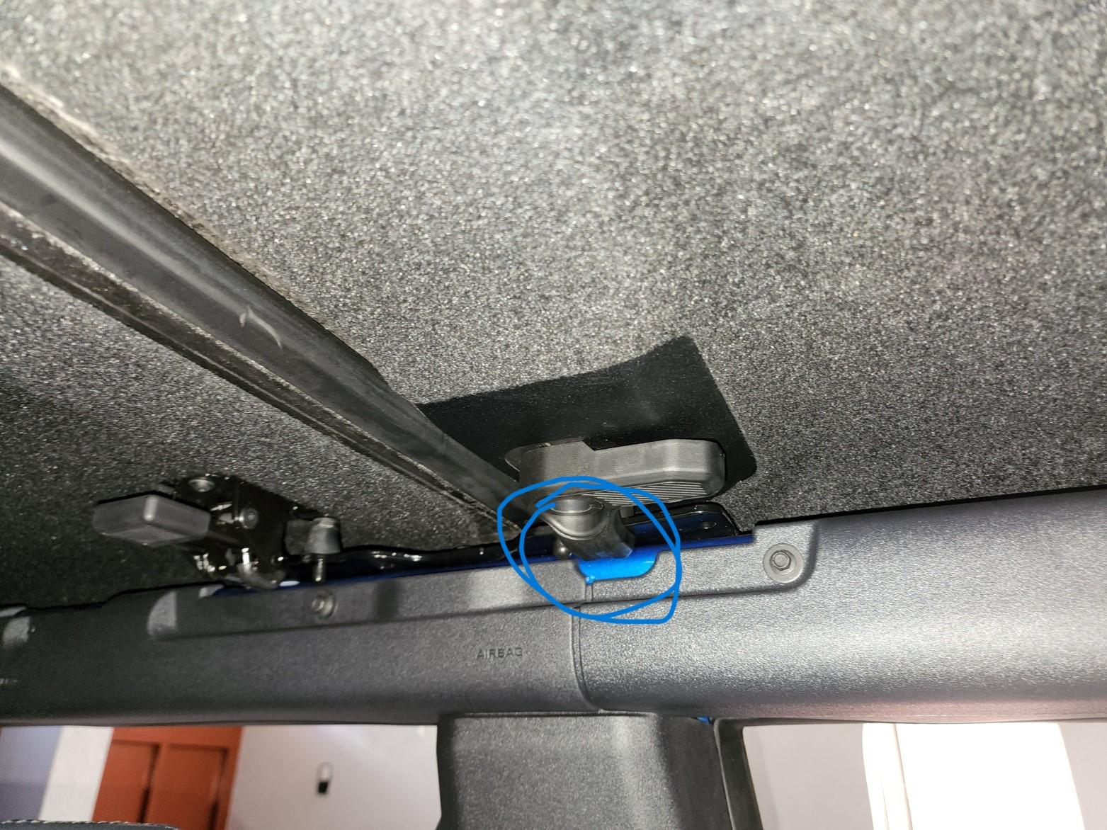

Here is a method that works for me and only requires some electric tape.
Place electric tape on the sides of the hole where the guide pins are inserted (see attached photos).
It is only necessary to do so in the left and right passenger guide pins of the front panels (not the front pins or the second panel pins).
You need to place the tape on both left and right side of the guide pin holes.
No noise after that!
YMMV.
Good luck!

People have already been using electrical tape or shrink tubing for a while now. There are several videos on you tube people have made about this.

Ah, did not know that. I only found 1 thread talking about the silicone grease.
