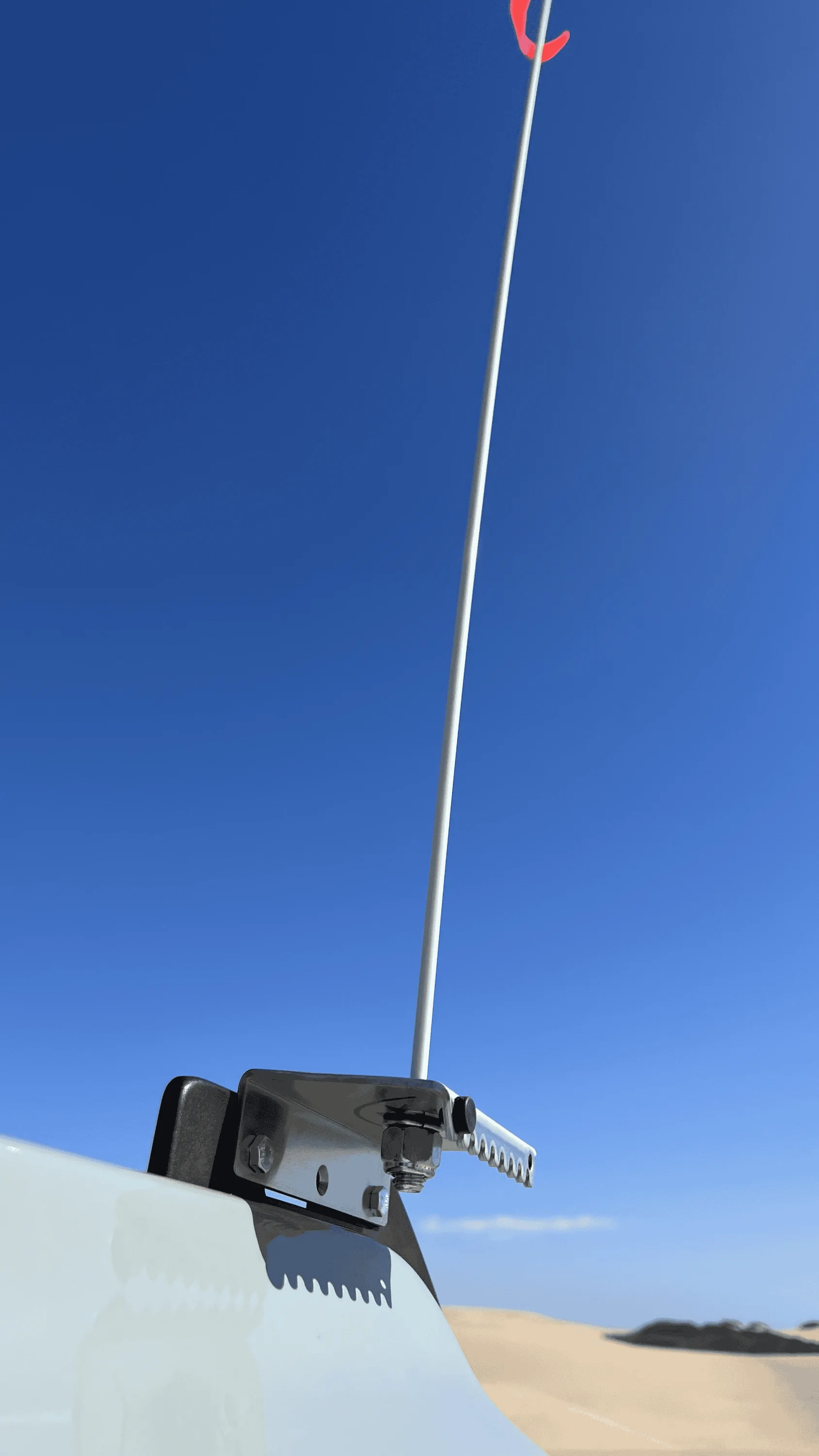

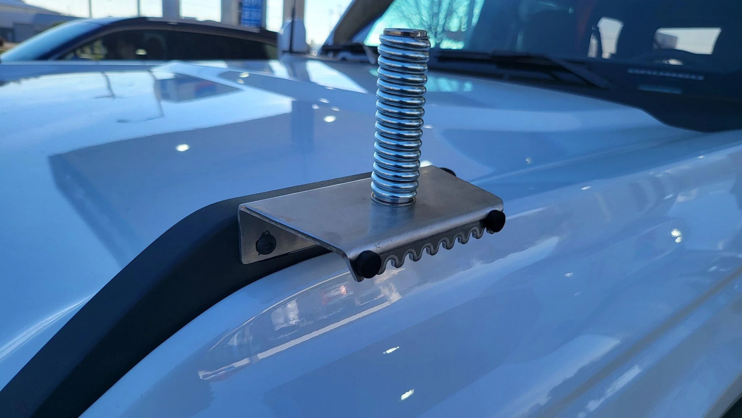

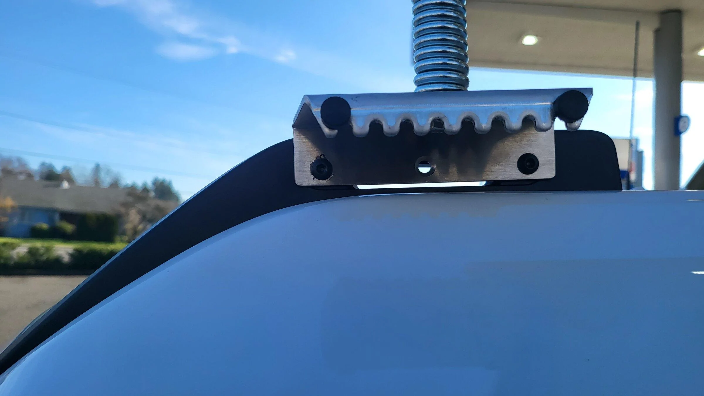

I had to figure out a quick install for a flag whip to go to Sand Lake Oregon. I went to a local depot and just walked around looking for something that would work. I thought worst case I will get a Simson Clip and add to tie down on hood. I came across Hands Free Foot Door Opener and it worked perfect!!! Holes lined up with factory screws perfectly. The only thing is the one I got is silver in color and I just noticed online they have a black one. I think this may work better and look better than others I have seen online that are actually made for the flag whip. Hope that helps some of you! See attached pictures!

Not bad when you’re in a pinch. At Home Depot they cost about as much as the ones they sell at Bronco Graveyard.

Thanks for sharing. I like your idea. The costs are the same between the HD and Bronco Graveyard, but the shipping from BG is minimum $10 on a $19 part.

Thanks for the idea and link. I would add that you need to buy 2 M6 - 16mm bolts to attach it the trail site (stock bolts are too short). Also the stainless is really hard. Completely destroyed my bit trying to drill the hole. But it works great. Just ran with it on Oceano Dunes (Pismo beach).
