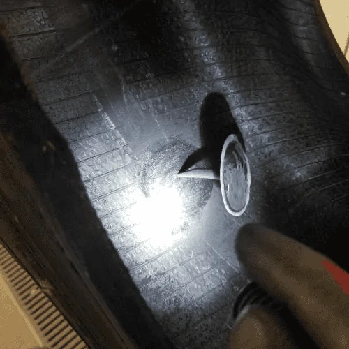

If the hole isn't too large a combination patch plug is a proper and permanent repair.
Ford Bronco flat tire while "off roading" my Sashquatch 1635205369007
heh... haven't seen those before. I did have a tire repaired last summer and I noted that they plugged and patched it. Here I thought they were going the extra mile. Surely they just used these.
