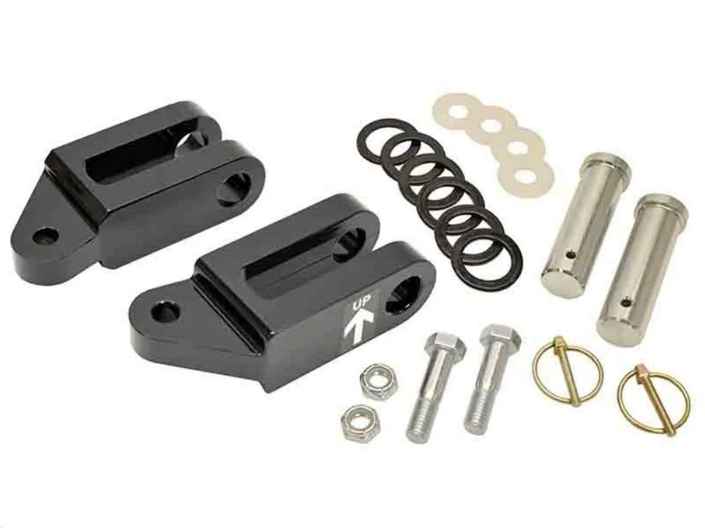

Blue Ox has a new 7/8" pin adapter the part number is BX88357 it has a deeper throat.

Blue Ox has a new 7/8" pin adapter the part number is BX88357 it has a throat.
Ford Bronco Flat Tow Equipment Availability? BX88357
But what is the clevis opening dimensions? I am not milling out and weakening the arms, just my luck they would let go and coverage denied due to unauthorized modification of safety equipment. :) I will wait for a Bronco specific adapter, it will be along soon.
