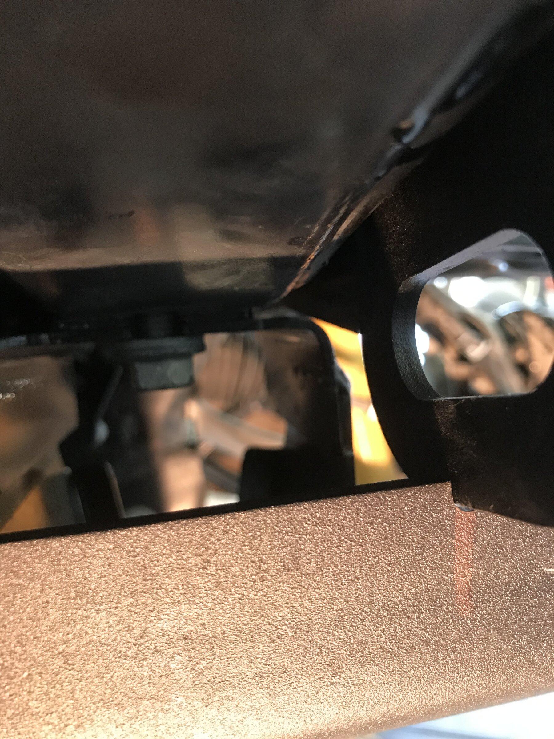

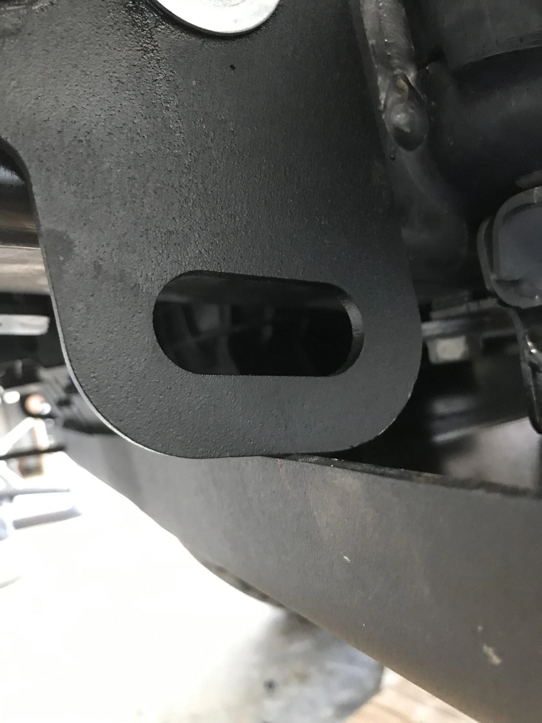

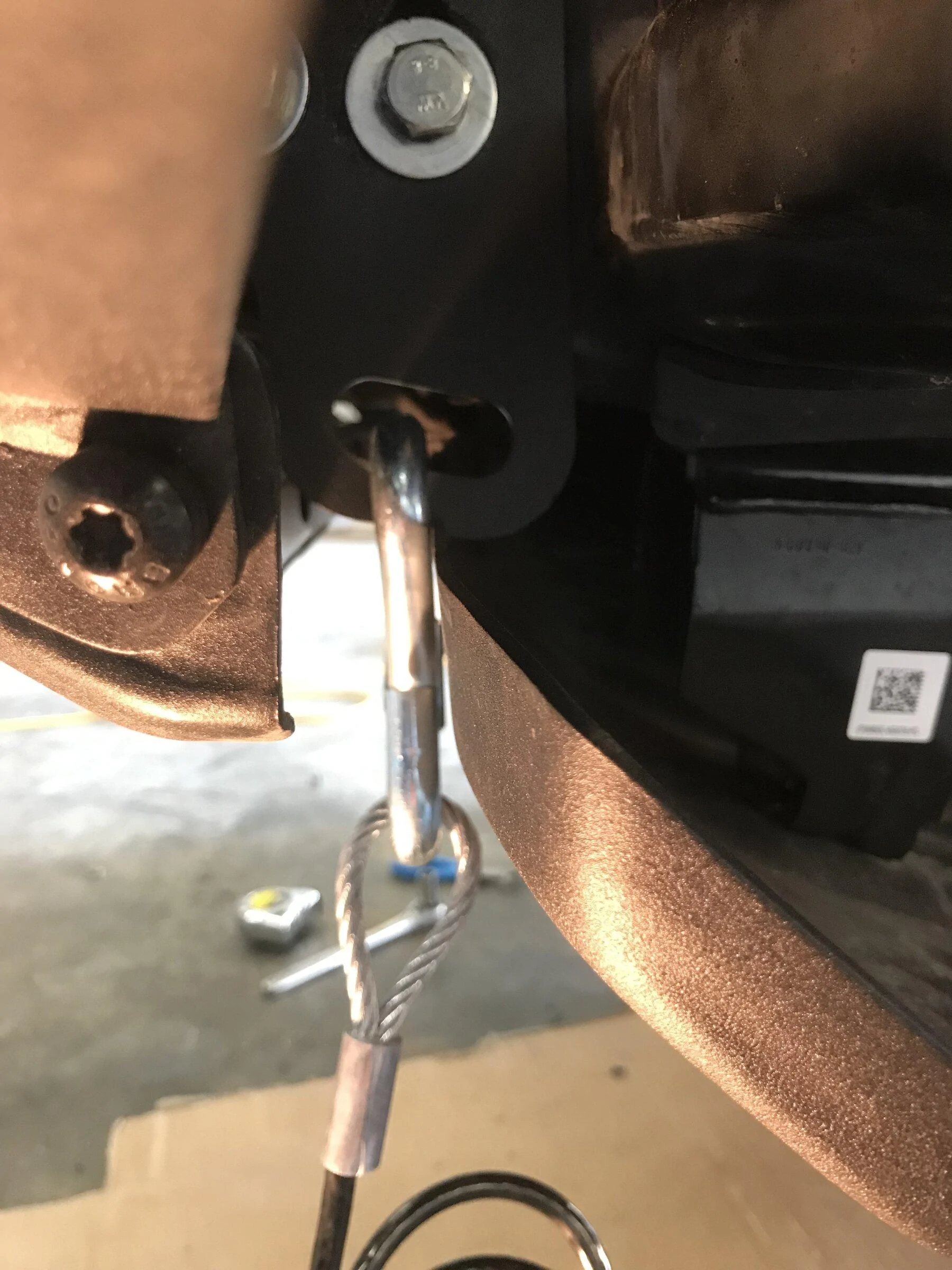

On the modular bumper with factory bash plate the safety hook plate does fit!
My safety hook plate and front bash did bearly touch when the bash is completely tight.
I notched my bash plate about 1/8 inch deep and just the width of the safety chain plate.
As LOD pointed out in a previous post a washer under the bash would get the proper clearance, but I would lose a washer.
Also, the safety hooks fit. Just have to reach under the bumper a little.
1st pic is where everything touched. The next shows with a notch.

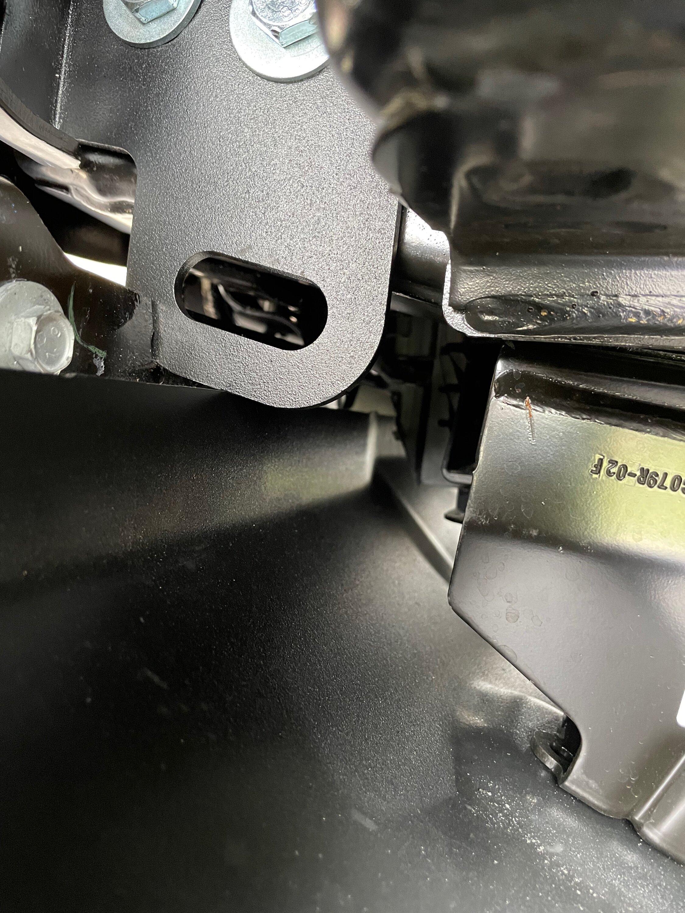

A sincere thanks to this thread. I decided to install the LOD frame tie-in brackets in combination with my OEM modular bumper, both to reinforce the tow bar connection and to give me a connection point for safety cables. I had a couple hiccups, mainly that I couldn't get the bumper to fit back on without cutting some notches in the back where the LOD brackets are. I'm not sure if I missed something, but as you can see it wasn't even close to fitting without the notches cut, and even with the notches its a tight fit. It seems like it will work though.

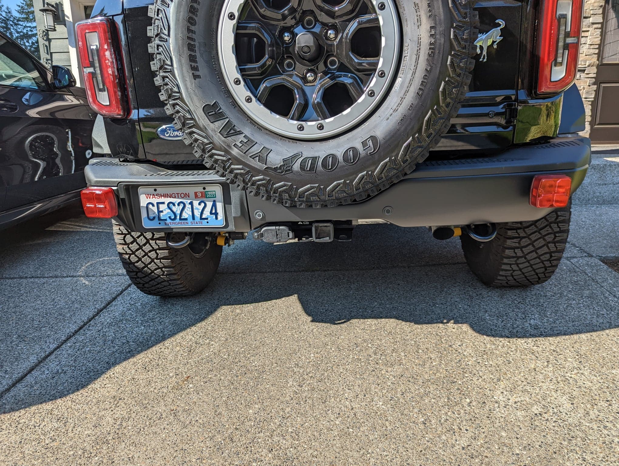

FWIW, I attempted the Curt kit for the lighting and got fast blinking tail lights on the RV and the front of the bronco, nothing on the back. Before I messed up anything, I just went with the wireless lighting from Amazon, and they're working great!
Setup is:
TOAD: 2022 Bronco Badlands 2.7l Automatic
RV: 2019 Newmar Dutch Star Spartan Chassis
Towbar: Roadmaster Nighthawk All-terrain 8K RM-676
Modular Bumper Adapters: Roadmaster RM-035-1
Braking: Roadmaster Brakemaster RM-9160
Wireless lighting: https://www.amazon.com/dp/B0936C6SCZ?
I did need to rework the factory air connectors on the Dutch Star to fit a 3/8" automotive pneumatic lines, which made me also need to change the (bus side) air hose connector. Works great. People that tell you you cannot use anything but the Air Force One are incorrect, other than the physical connection needed a trip to Lowes to marry them up.
With this setup I do not need to use the 7-way connector, so have a jackery trickle charging the battery on the drive.

Where did you place the lights that the magnets worked?
The bumper. Worked great!
For peace of mind, I ordered 30" velco straps to make sure the lights don't fall off, but they stuck pretty well without them over a couple hour drive. The individual lights have a U bracket on the back of them that has the magnet attached to it. It would accept the velco strap easily.
Ford Bronco Flat tow equipment needed to flat tow the 2021 Bronco? 309631065_1433510830461532_2932179490946845170_n

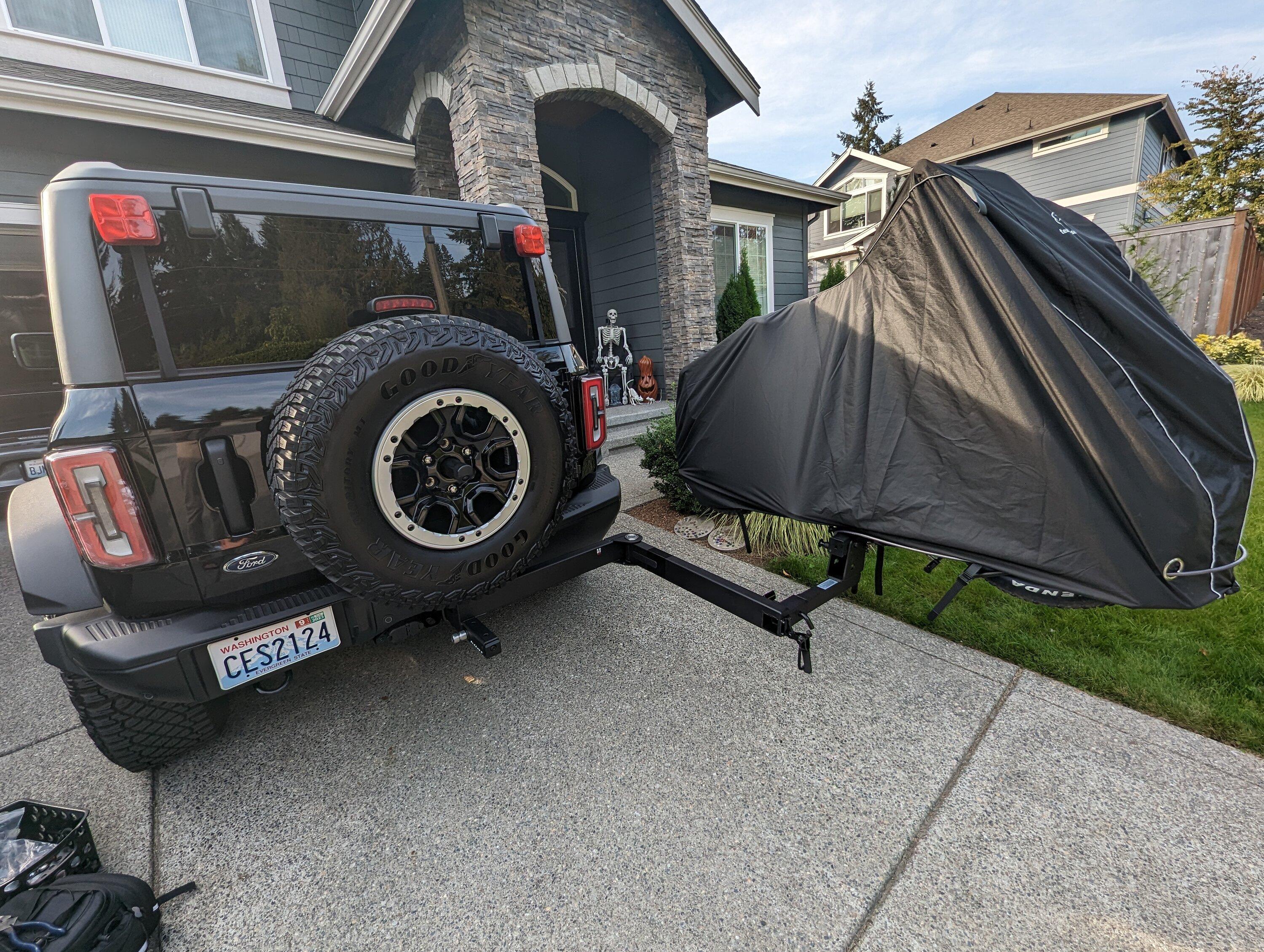

Update. Since we are also taking our fat tire e-bikes tomorrow on a Kuat rack and cover, all lights were 100% covered. Used the same Velcro straps I mentioned and placed lights on top left and right. This also works great, if we are taking bikes.

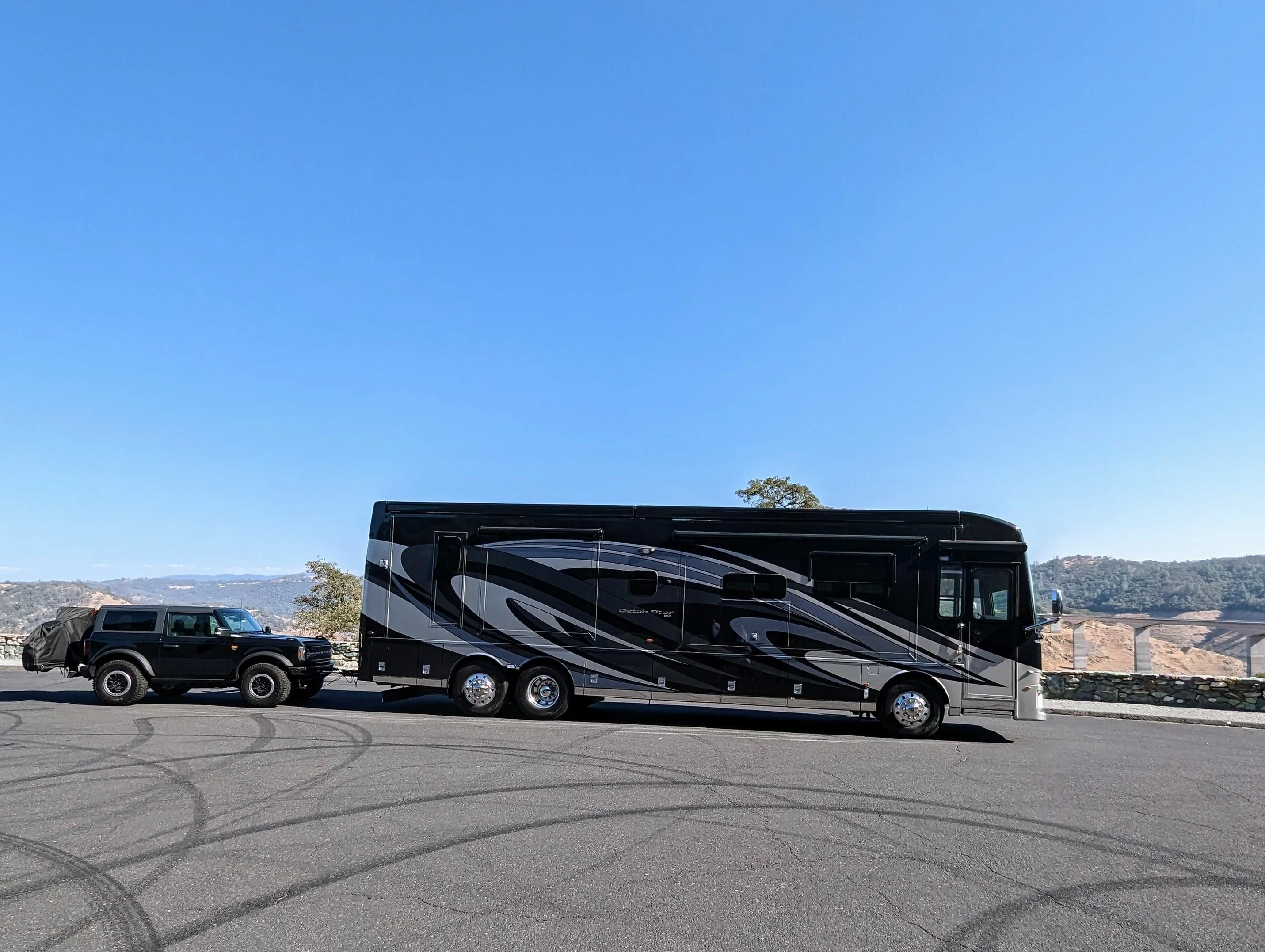

Setup is:

980 Miles over the last two days, zero issues and safely at Yosemite. Heading into the park tomorrow, then off-roading on Tuesday.

Nice Bronco and Dutch Star, good to hear flat towing is going well.
Is that a motorcycle on a carrier in back of the Bronco?
It's two fat tire e-bikes. Between the length of the coach, the hitch, the bronco and the bikes, she's a large package!
These incredibly twisty roads out by Yosemite were insane, all hooked up! 😂
