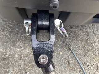

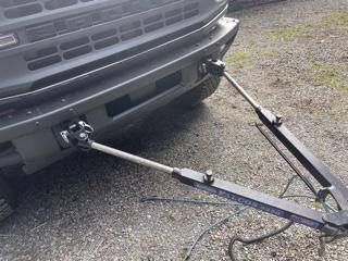

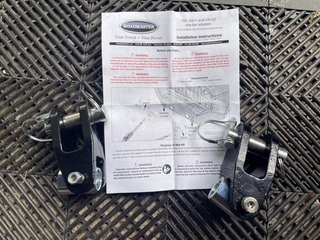

Well I’m test fitting the Roadmaster 035-1 adapter On mod bumper. I’m new to flat towing and using a hand-me-down tow bar from my dad. But to my untrained eye it appears to fit well. A little play. The adapter comes with a 1” sleeve that doesn’t fit inside hole without widening.
Doing it this way makes so much sense to me. When you say "The adapter comes with a 1” sleeve that doesn’t fit inside hole without widening" does that imply that you had to drill out the shackle holes? Thanks for posting this!

I didn’t drill out shackle holes yet. However, I believe it might fit tighter to drill out holes and slide in sleeve. But I had an idea. Because the sleeve and pin have some play I may cut the sleeve lengthwise. Then slide sleeve into un drilled Mod bumper shackle mount. If the pin and sleeve fit it “should” really tight up the slight play. I will try it and post my results…

I've towed a lot of stuff over the past 20 years but like you I’m new to flat towing but I don’t think a ”little play” is a problem. What’s the diameter of the holes in the bumper and the pin that came with the Roadmaster Adapters?
I ask because Roadmaster states the adapter will work with either 7/8” or 1” holes so per them a little play would be okay. See below in bold from Roadmaster’s website:
The 035, 035-1 and 035-G2 allow you to connect ROADMASTER motorhome-mounted tow bars to popular offroad vehicles. The bumper mounts can have either a 7/8" or a 1" diameter hole.​
035 — for bumper mounts that are ¾" thick.
035-1 — for bumper mounts that are 1" thick.
035-G2— for 1” thick mounts that need extended reach (such as Smittybilt Gen2 bumpers)

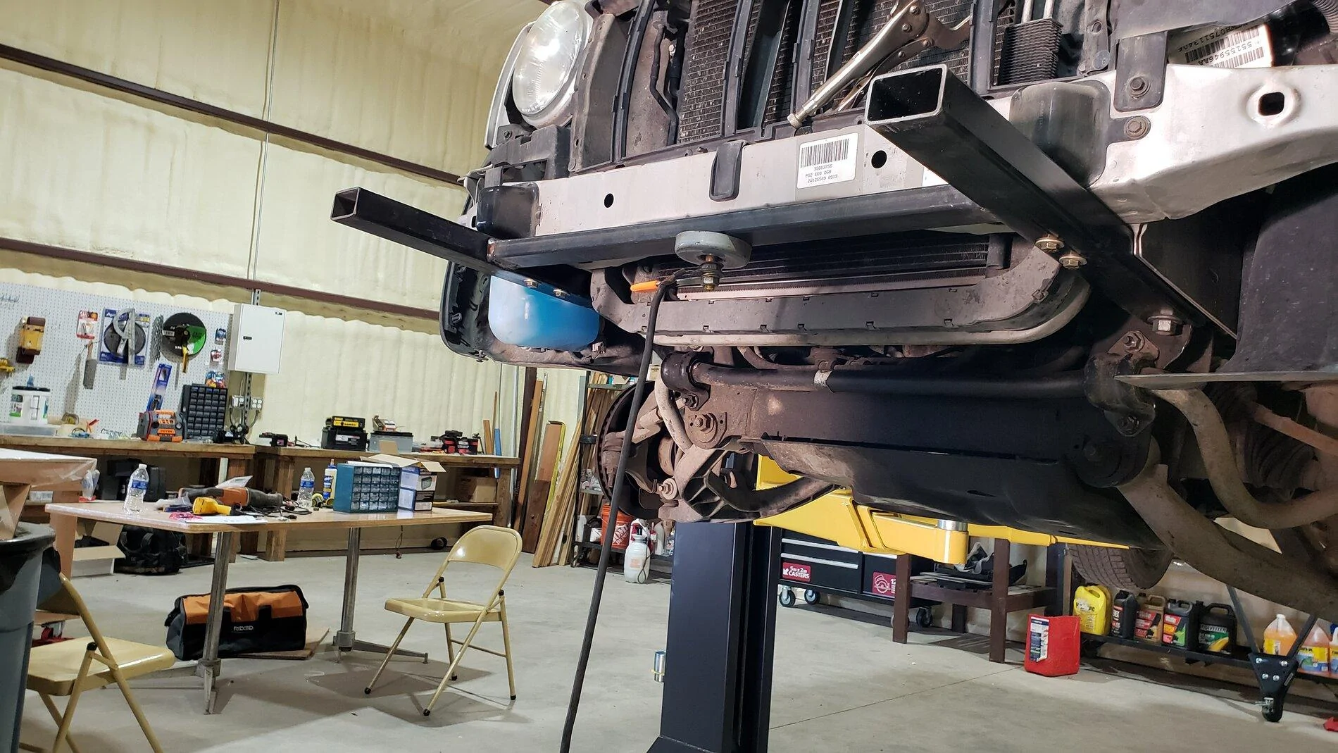

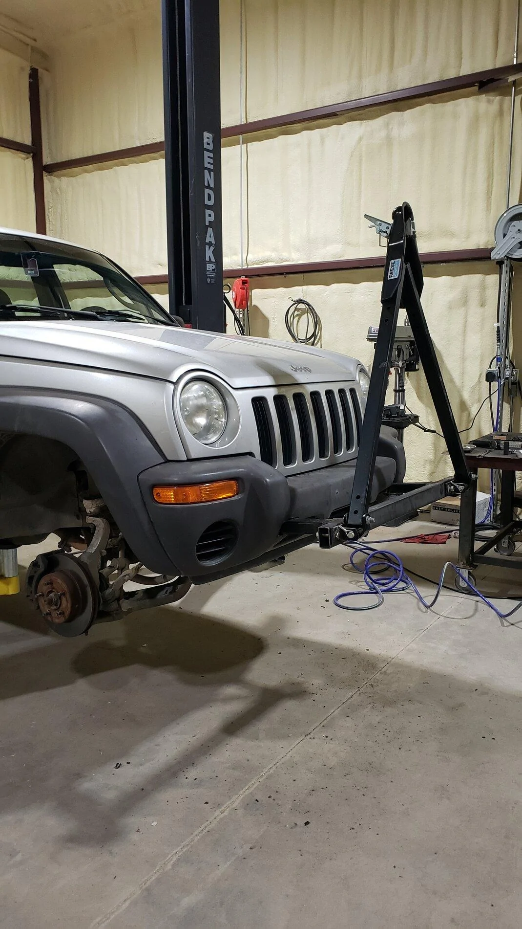

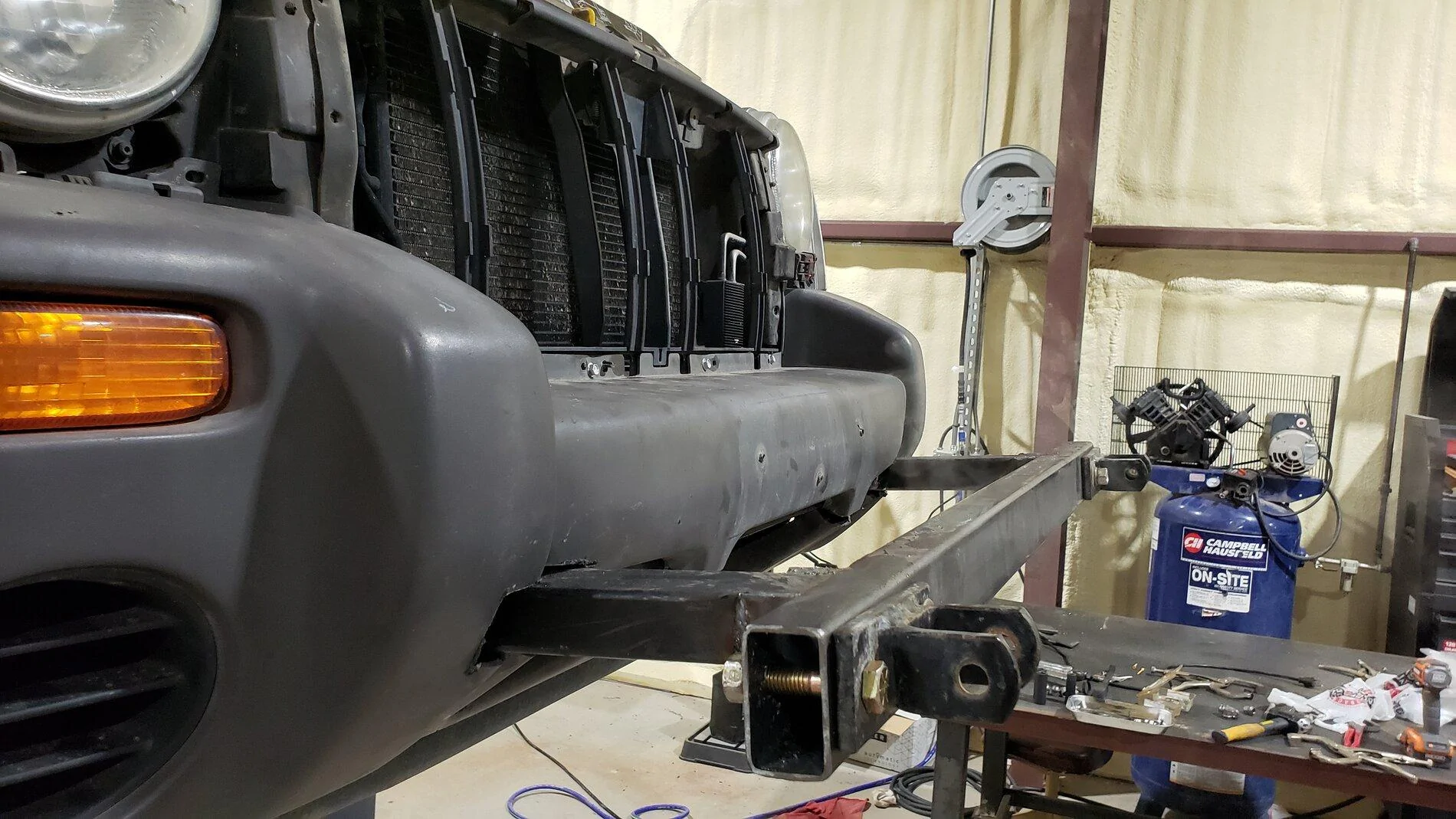

So my "in the meantime" ride I decided to do an at home install and make my own tow bar. The liberty ways alot less than the bronco so I won't be doing this when I get it but I learned a ton about flat towing set up making this.

Without precise measuring tool, I’m pretty confident the mod bumper shackle mount hole measures 15/16”. i did read towmasters description and the play when mounted Is probably totally fine to run. My mind just wants it to be solId and trouble free, lol. If that makes sense. I have to say this thread is refreshing. Rest of this forum is quite toxic lately

Some day I will have a shop like you. I love it!

72BroncoSand, the modular bumper shackle mount hole is a 7/8" clearance hole (.9062" or 29/32").
