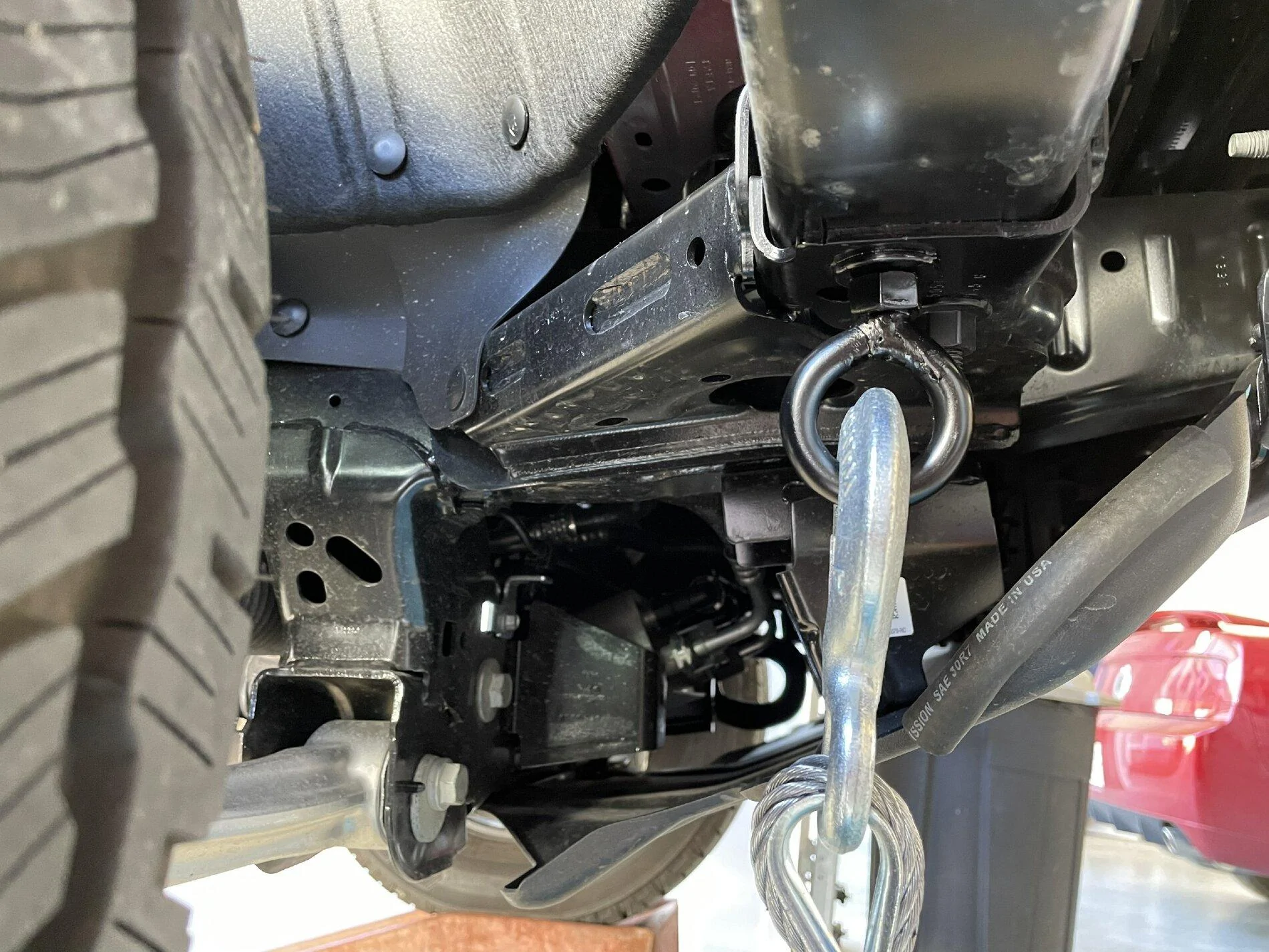

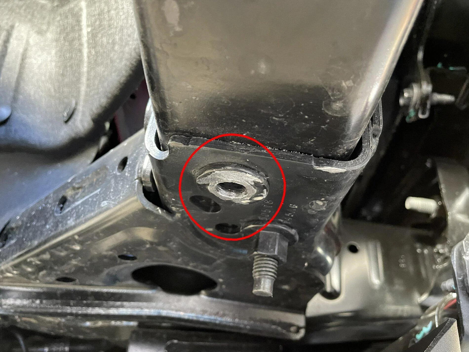

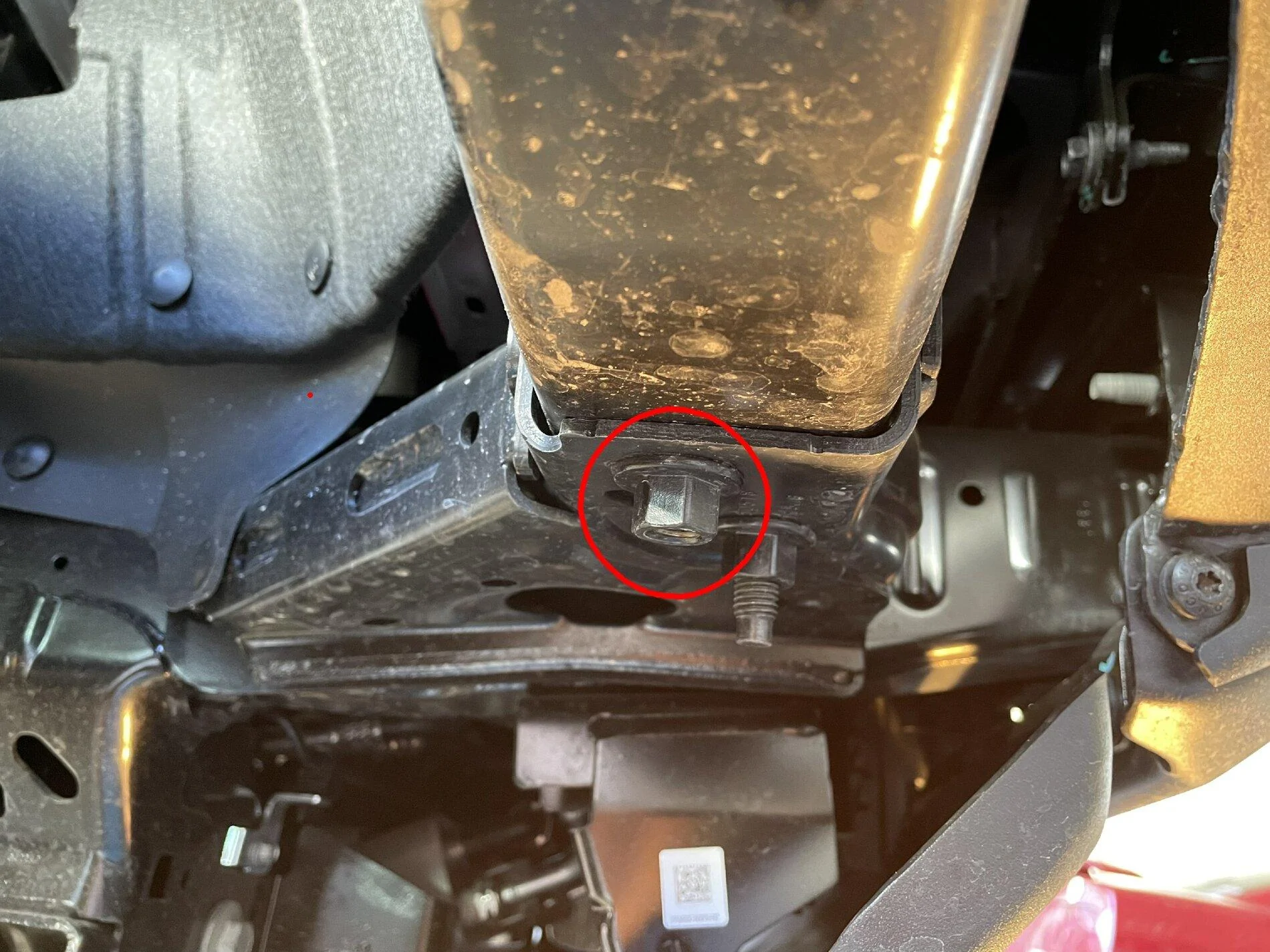

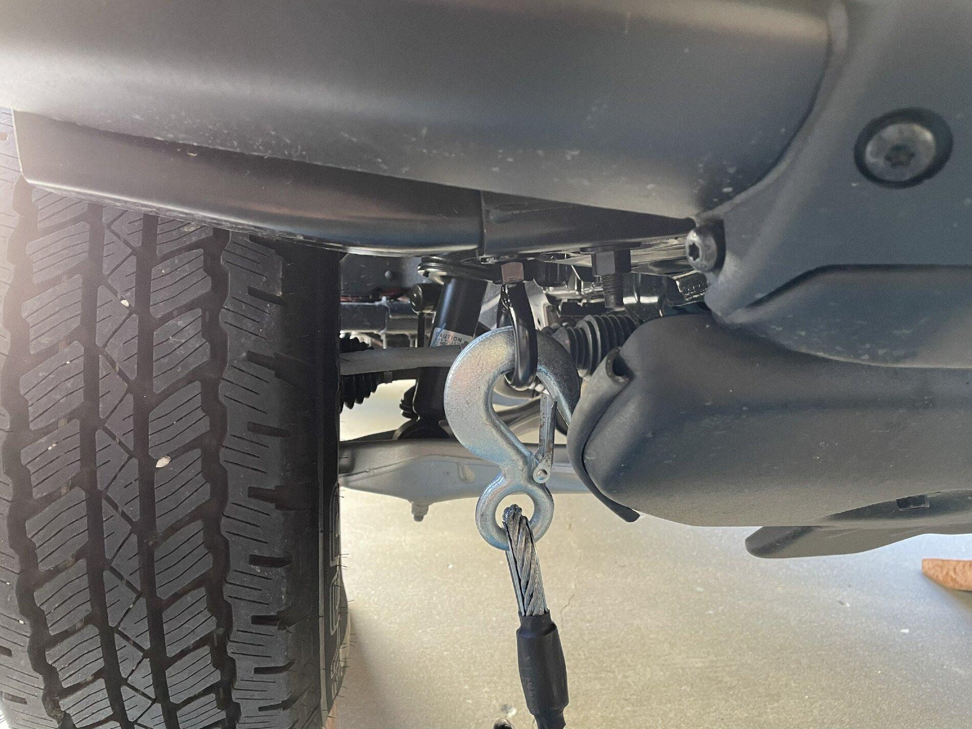

Tow Bar safety cable connection points. Finished installing the eye hooks this morning. Not plug and play as I though. Nuts on the bolts holding the front crash bar are welded to the frame. So had to remove and drill them out to 1/2". Added a bit of rubber hose to the edge of the bash plate to keep from rubbing the edge.

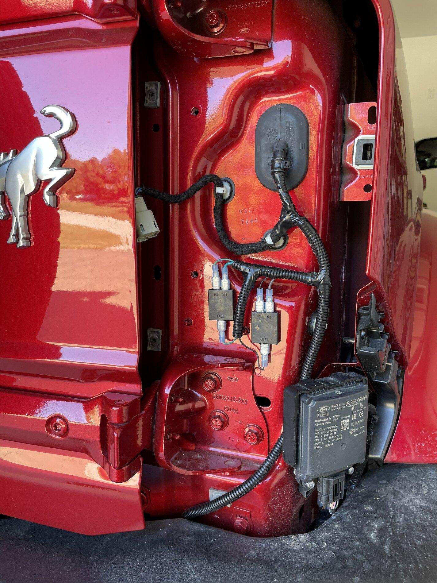

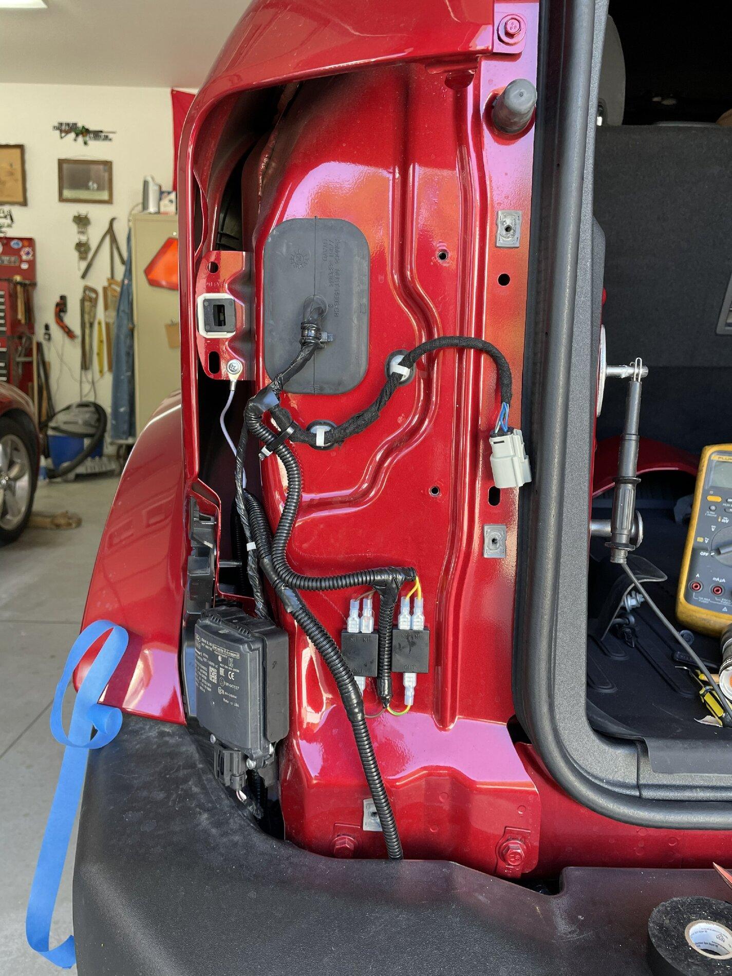

OK, some info on installing the Blue OX BX8848 Tail Light Wiring Kit, Diode. Two pictures and two documents that helped a bunch. One is instructions on removing the tail light assembly and the other is the wire color code.

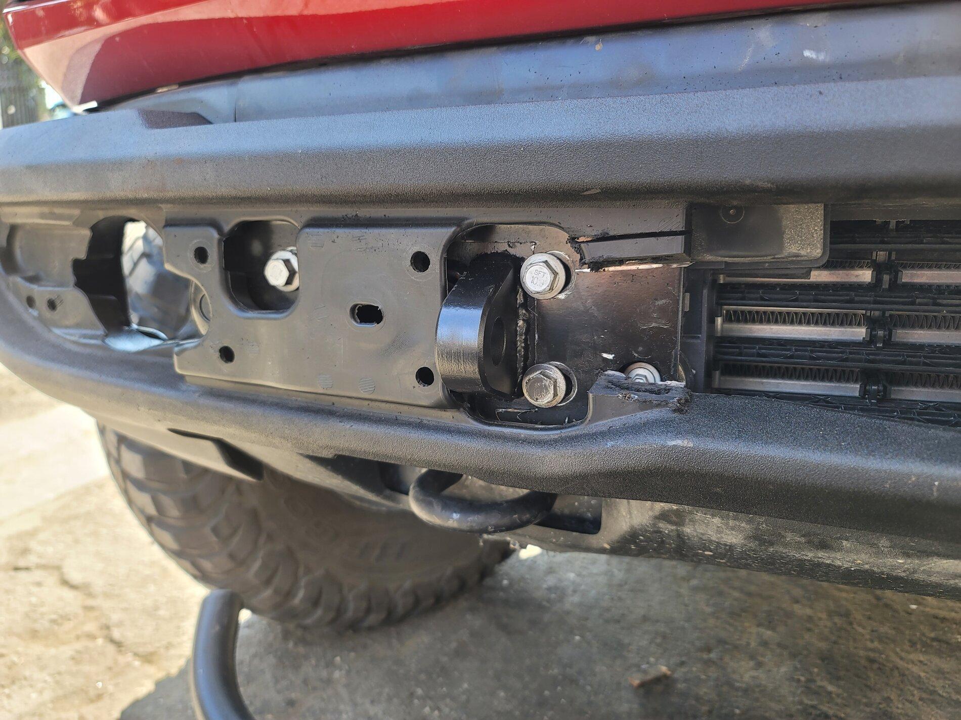

Without precise measuring tool, I’m pretty confident the mod bumper shackle mount hole measures 15/16”. i did read towmasters description and the play when mounted Is probably totally fine to run. My mind just wants it to be solId and trouble free, lol. If that makes sense. I have to say this thread is refreshing. Rest of this forum is quite toxic lately
I received my
I received my 035-1 adapters the other day and everything you've been saying now makes total sense. I took them, along with my Badlands, to a local machine shop to ask their opinion on what I should do:
1) drill the shackle mount holes to 1" to match the included bushing
2) try and find an even thinner bushing to match the roughly 15/16 hole on the shackle mount
3) just run the adapters with the 7/8 pin and a little slop
The guy said he has a ton of experience towing heavy vehicles and the play using the 7/8 pin is absolutely not a problem. So, I'm going with option 3 and will let you know once I get all the bits together. Thank you very much for coming up with this! It really seems like the least painful option out there for a mod bumper.

yourbudjim sounds like a great plan.
Will pickup my Blue Ox adapters from the machine shop tomorrow and hopefully have my Bronco back from the paint shop on Thursday. Will send pictures after I put it all together.
Ford Bronco Flat tow equipment needed to flat tow the 2021 Bronco? Right Side
Great information, thanks for sharing it! I've been flat towing my Bronco with drag lights because I've been hesitant to start cutting into the harness to install the diode kit. This info is helpful as I decide whether to continue holding out for a plug-and-play umbilical kit from Ford or other aftermarket company, or bite the bullet and install one of these universal kits.

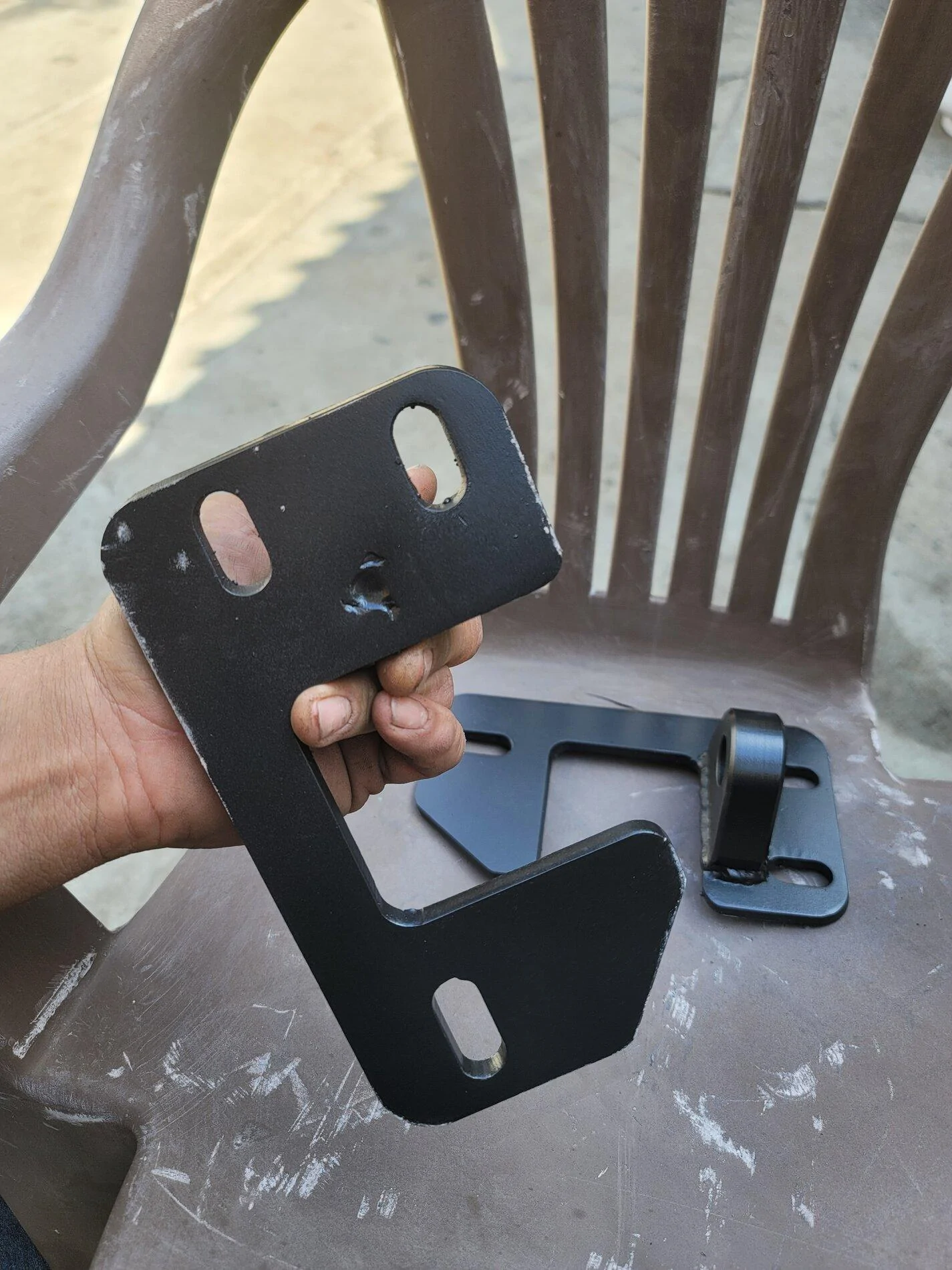

Save yourself some hassle and buy some of those tabs already made from @Oscargrouch323. His are similar to mine but better workmanship LOL. He sells them in This Thread.
