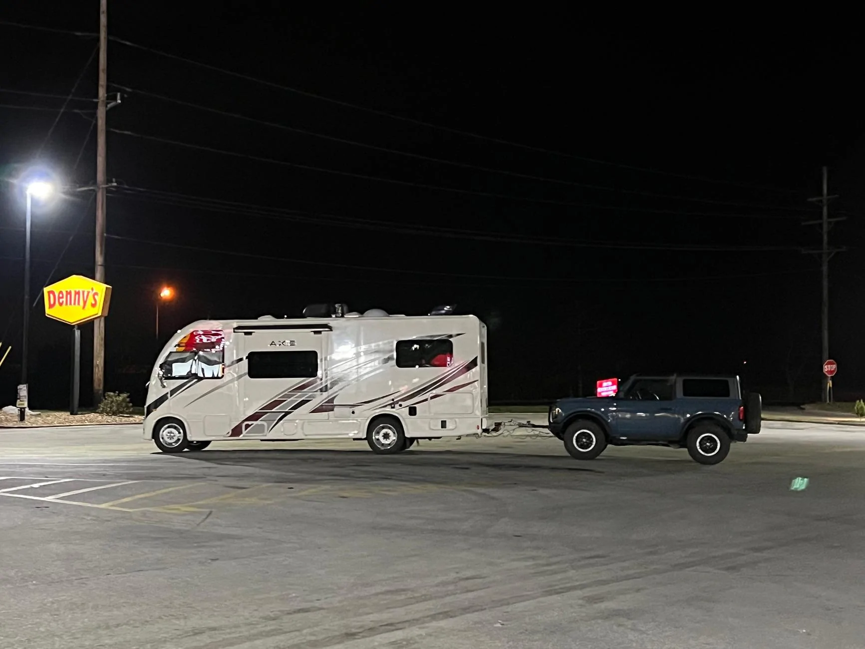

Kansas to Riverside, CA., Kansas to the Canada border in North Dakota, Kansas to eastern Kentucky, Kansas to Hatch, New Mexico, Kansas to Colorado 2x.
2.7 Black Diamond automatic. We followed the printed out procedure to engage and disengage Tow Mode EVERY TIME we engaged or disengaged.
We have the procedure printed and enclosed in a plastic folder sleeve.
By the way, we live in Kansas.

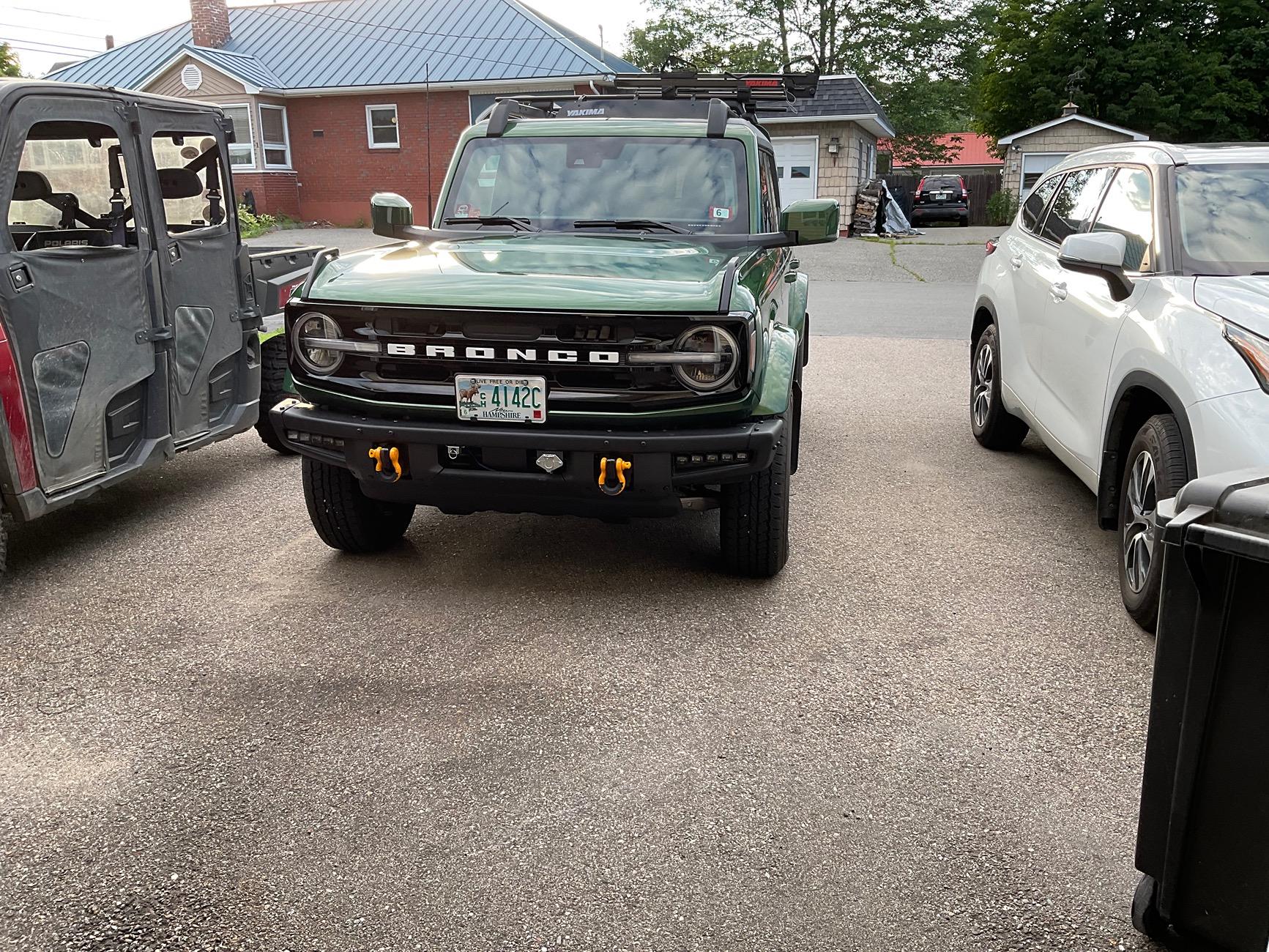

I also have the Curt harness on my 2024 outer banks, 2.7 , auto trans and 5door.
i use the Curt Rambler tow bar mounted directly to the HD modular bumper D rings with Curt adapter, I use RVI brake 3 with wireless connection for the RVI brake away sys. I also use the RVI battery charger, and tire pressure monitoring system. I all works flawlessly.
Ford Bronco Flat Towing Success - What's Your Setup? IMG_3361
So you are towing from the factory recovery points?
Bsenecal
Aug 16, 2021
131
118
Vermont
'19 Ranger crew cab, '17 Fusion sport, '68 Mustang
We have the same bumper and I have gone back and forth on if I will do the baseplate and the ugly look or take the chance of using the recovery points like you and others have successfully done.
I’m just worried if there is an issue that Ford would not stand behind me as they say those recovery points are not for flat towing.
