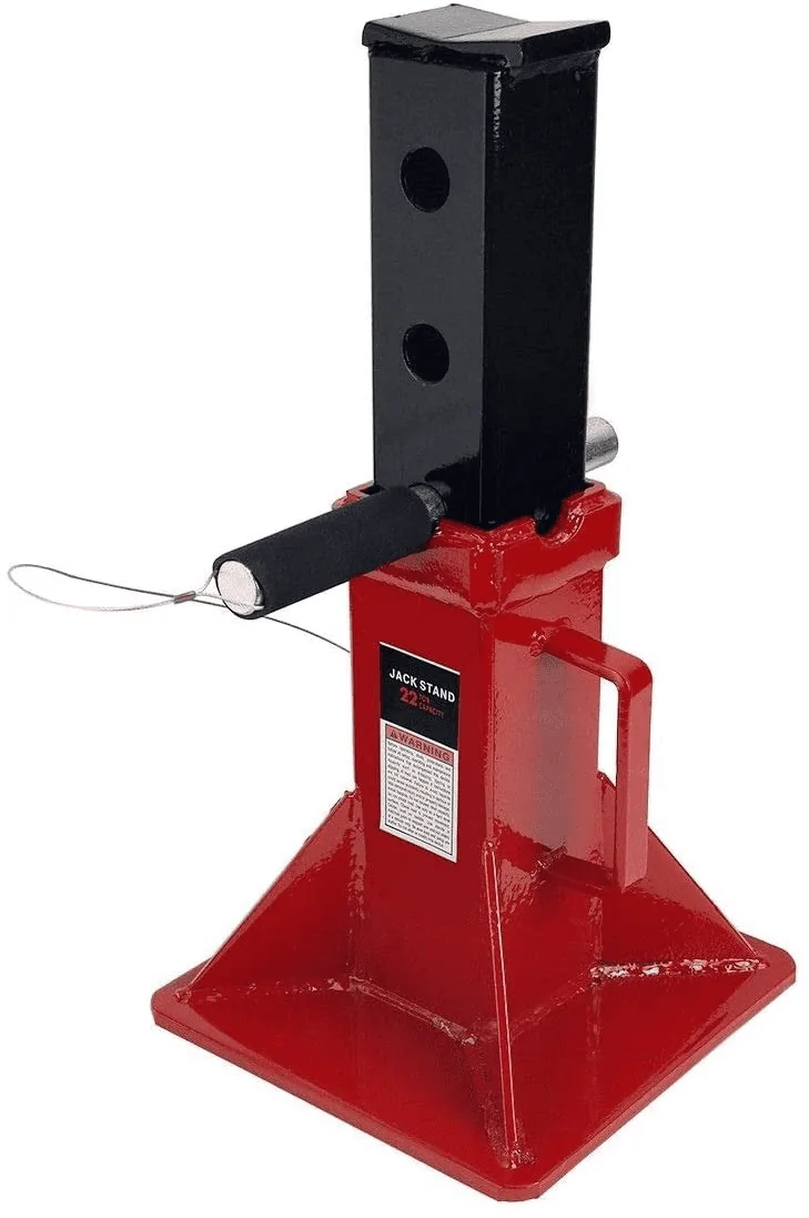

Quality jack stands are expensive but the peace of mind when you are under 5000lbs is priceless.
I'd strongly recommend a pin style jack stand, not the ratcheting.
