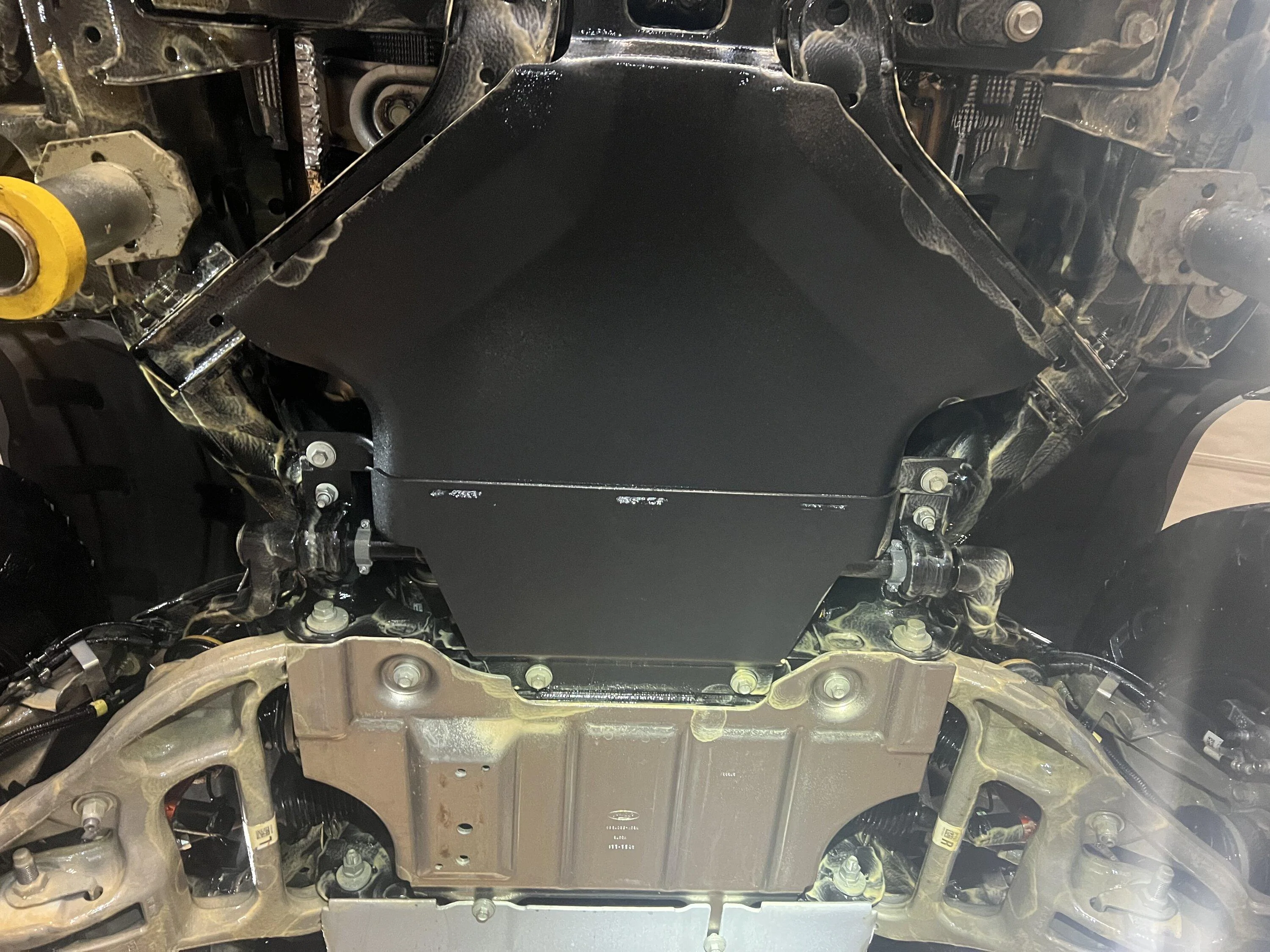

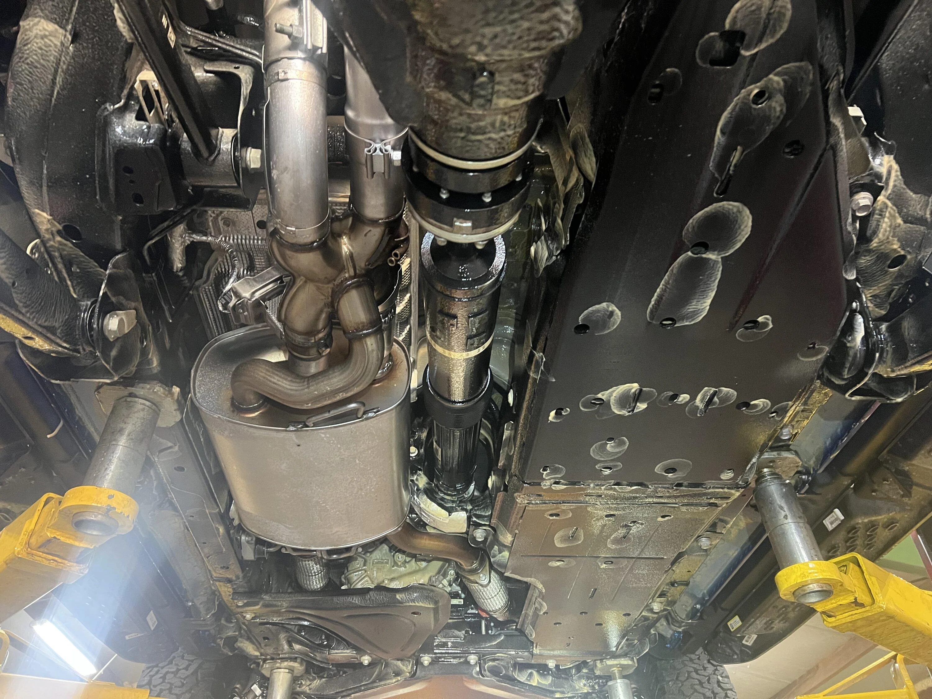

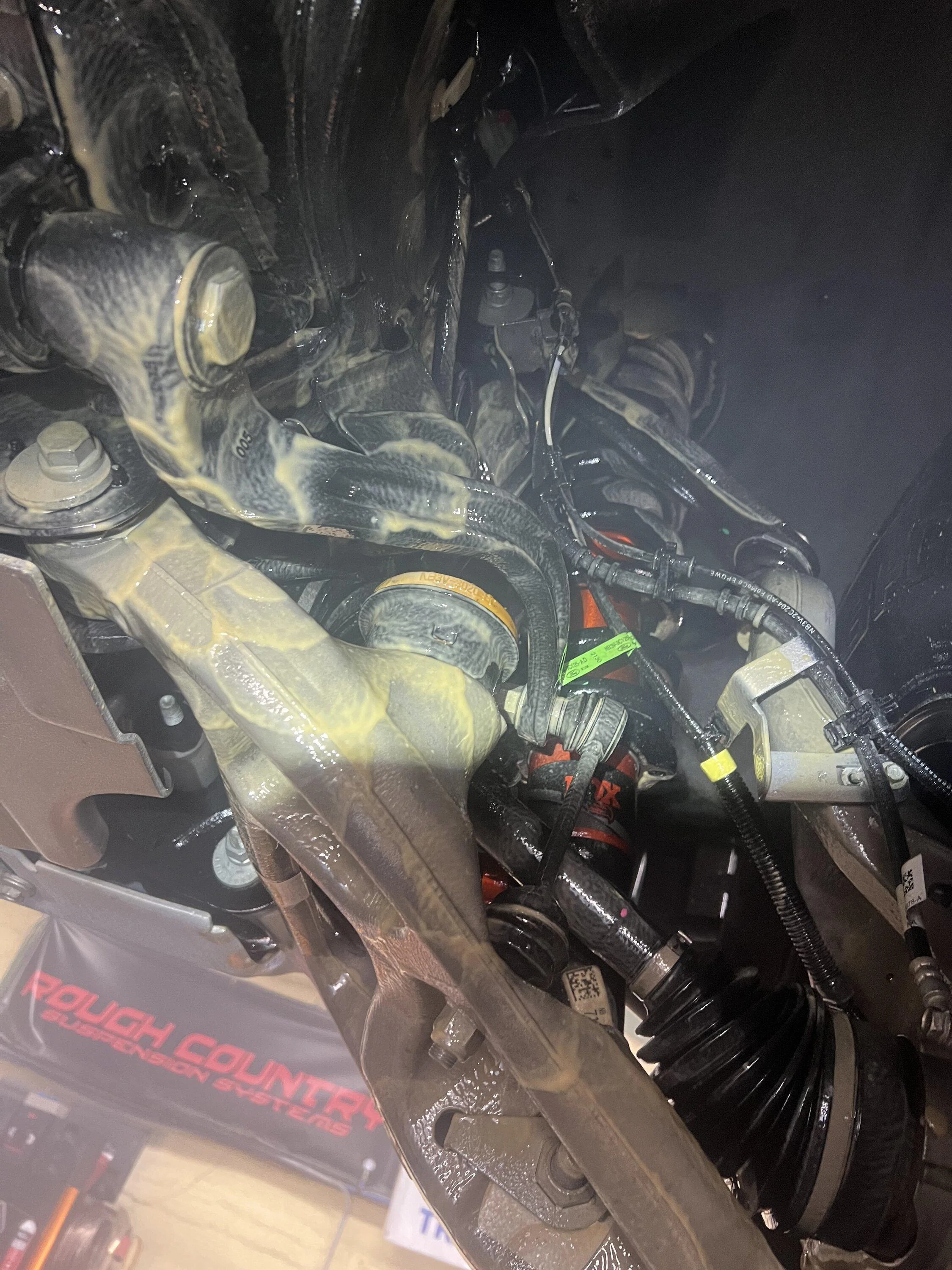

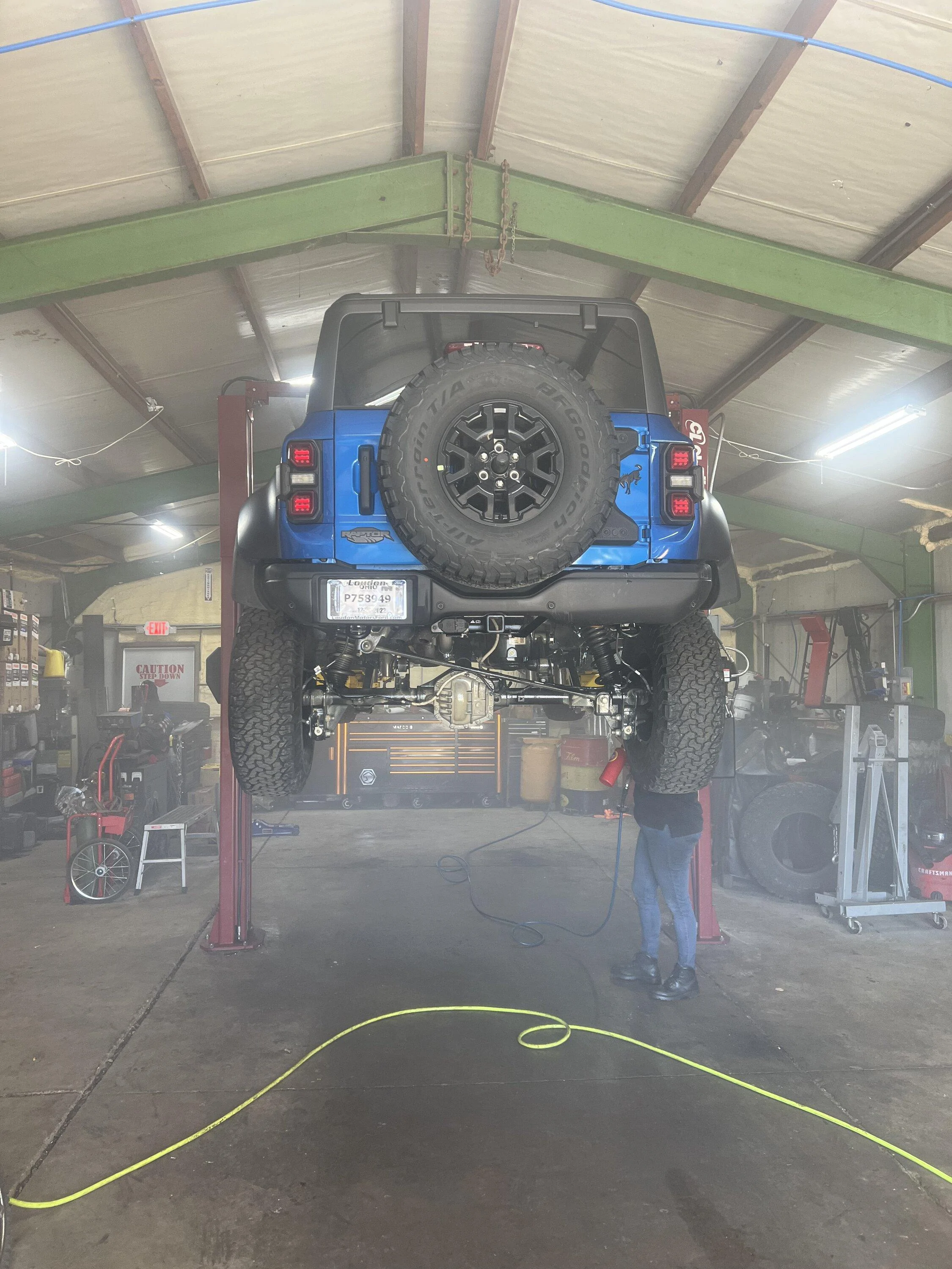

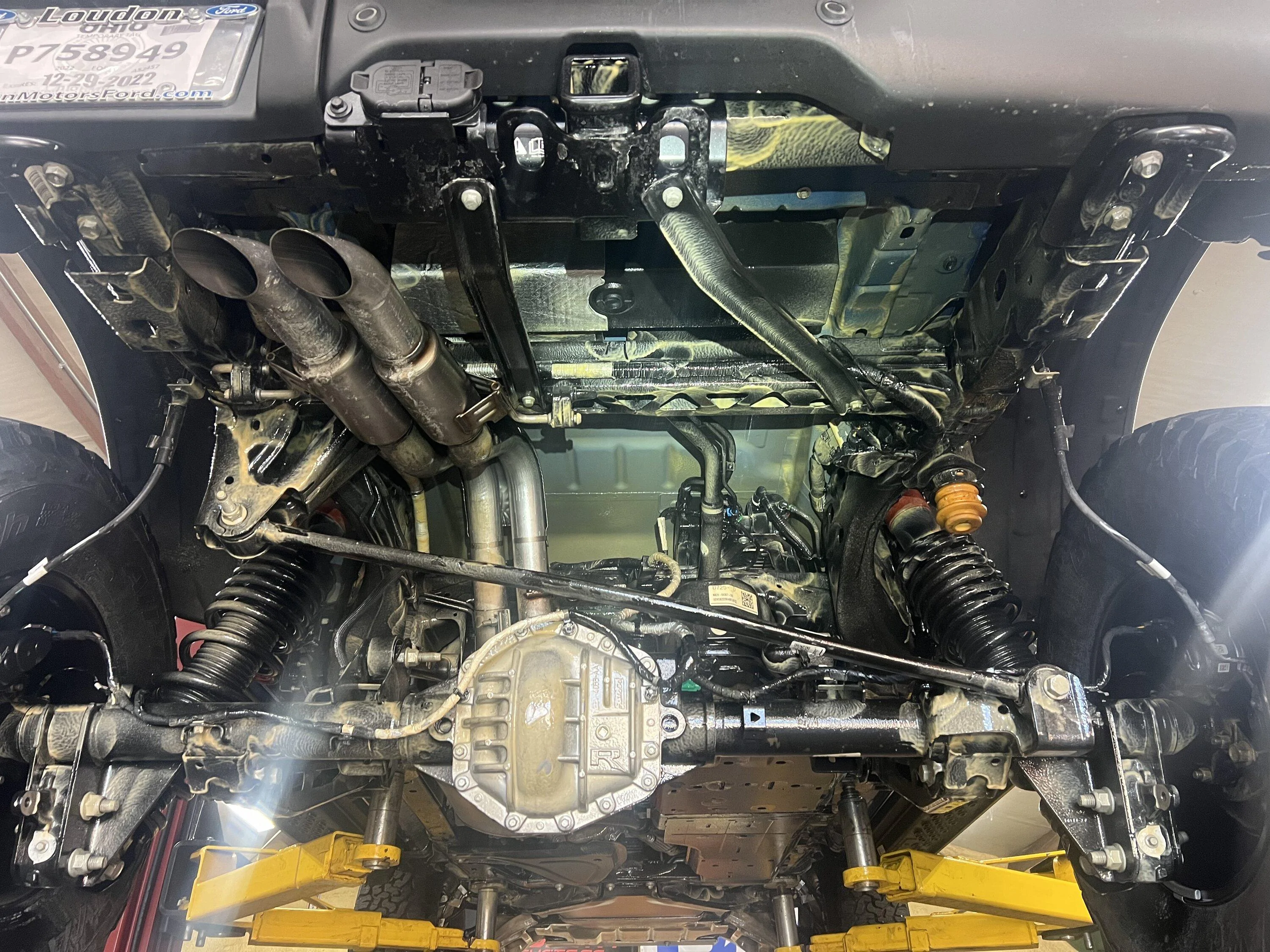

Have had this vehicle for a little over one week. Decided to have Fluid Film professionally applied to the entire undercarriage. I want to protect it from salted winter roads in Ohio.
The shop had just recently had a base program Bronco in so they were familiar with the different nooks and crannies. They advised applying into the doors, especially since there were openings already. Raptor has additional openings at the bottom of the doors. I was glad no drilling was needed.
The smell is definitely strange, but not bad. They said it usually last a few days then goes away. Did not drip much in the garage. But it is still slowly seeping from the door drains.
From here on out, they will just apply the Fluid Film once a year, wherever it needs reapplied.
It is a good feeling knowing that the vehicle is much better protected now. It is currently my daily driver.

It was $400 for everything: Undercarriage, Engine Bay, 5 Doors, etc.
They ended up applying 3.5 gallons.
Crank's Automotive in Lakeville Ohio.

I used to get someone to do fluid film on my Super Duty every year around thanksgiving. Works really well, it can soften some underbody frame paint so over the course of 5 years you might see some small bits of that flake off, but better that then rust.
Glad to see you're planning to use it in the winter!
I will say $400 is a bit steep, it's been 5 years or so since I've lived up north but I think the most I every paid on a super duty was $150. Also, yeah it'll probably smell for at least a week

Definitely going to be a lot more than a few days for the smell to leave. Almost has a BO kind of smell. You will also notice next summer it comes back when the temps go up. Mine even dripped in the heat a little. Not a bad thing as that to me means it is creeping into the seams but just something to be aware of. The FF also will swell rubber no matter what they tell you. I have very thin wind seals on my doors (not a Bronco) and they became wavy due to the expansion.

I’ve done it on my long gone Jeep, used the 1 gallon kit that connects to a compressor. Going to do the Bronco but as in the past I will take my time avoiding the rubber parts. Also will avoid over spraying the rear as there was another member who had an issue with the gas tank and it’s sensors after application.

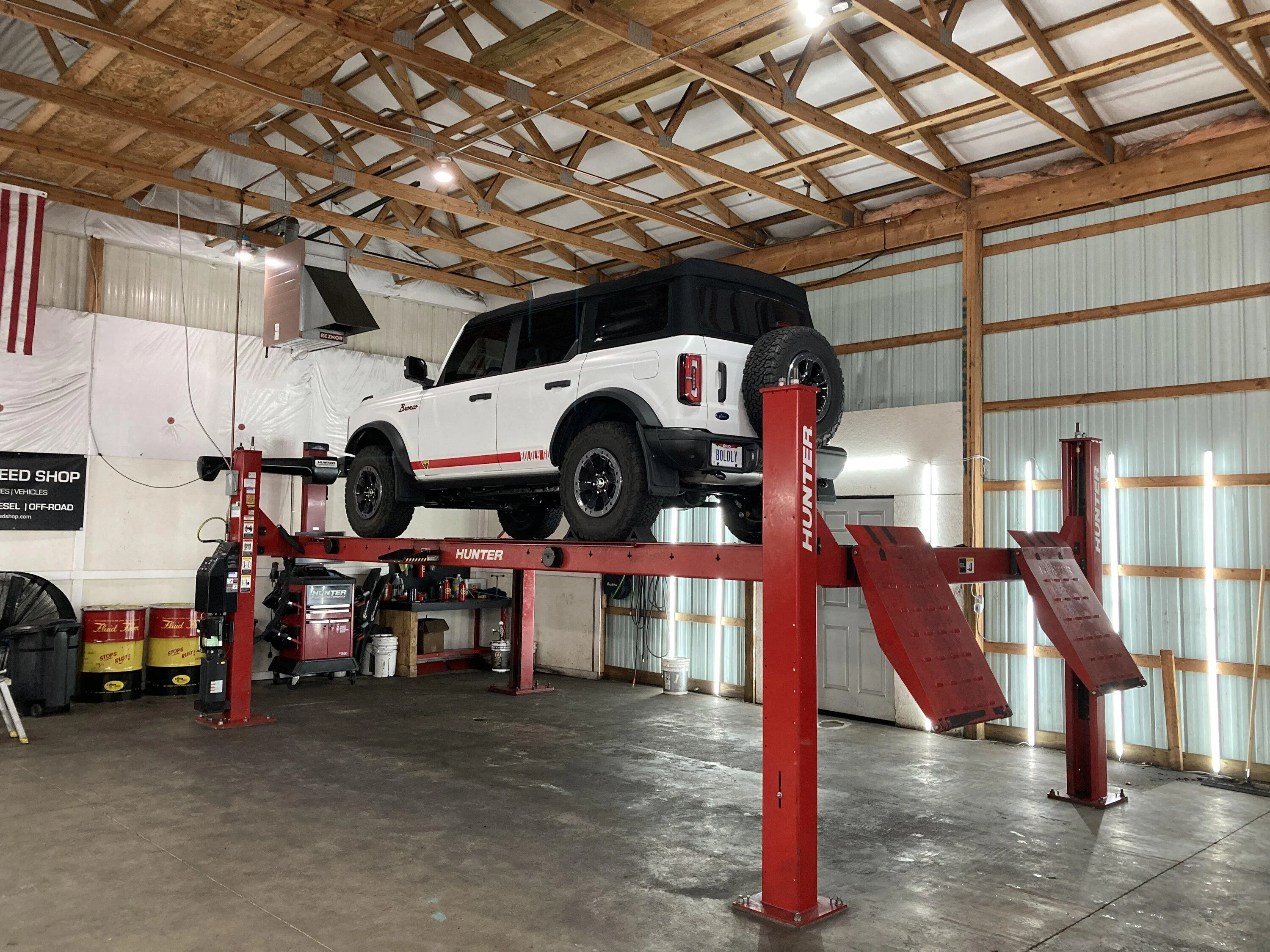

I got mine done at Hilliard Detailing Garage on the west side of Columbus. $180 and they did everything you can see from the bottom up, after an undercarriage wash and dry. Probably not as thorough as yours @CactusJack but I feel better my Boldly Go isn’t naked like last winter.

For the DYI person I highly suggest avoid getting FF over anything that heats up, will smoke like crazy. Did that once with it and and never again.
However Fluid Film is great but not the best for a few reasons. There was another thread not long ago about some other products. Will try to find and and post it here.

No thanks. Did it one year. Its a huge mess. Not to mention total dirt magnet underside. Youll see,lol
